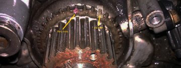

I've turned the engine over and over looking at those teeth until I felt crazy at one point of trying to troubleshoot this... It's distortion in the picture if anything
I'm no photo expert, but this doesn't seem to be distortion to me.
In my experience even 1 tooth of an exciter ring or trigger wheel can devastate a system. ABS systems or ignition systems

OP already check it on post 27, and reported it as pic distortion.

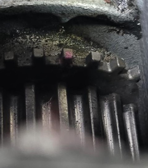

Zero tooth is the one with the red paint.
The 3rd tooth to the right of zero tooth IS physically still there but, it does seems like it is missing a angular chunk on the TOP of it.
From the top of the engine looking down to the crank sprocket could look fine as it seems like the same shape with the ones before and after it.
It could be possible to see that missing chunk by looking at it from the front of the engine straight on as it will be a smuge shorter (than the ones to the left and right of it) because of that missing chunk.
I know the engine is all buttoned up. Would it be possible to snap another pic on the 3rd tooth from the front straight on? Need to confirm showing the height of it?
If that tooth doesn't look symmetrical (height wise) like the 2nd tooth or the 4th tooth beside it, your engine will not run right and could explain the rhythmic miss and misfiring though the exhaust. That shorter tooth is cutting the signal to the coils for a fraction of a second and turning it back on.
That missing tooth will cut the signal to the ecm when is sees that shorter 3rd tooth, and turn it back on when is sees the 4th tooth, 5th tooth, etc and so on.

I guess I'm going to order a new sprocket and tear it back down... Like one of you said, that tooth may have looked fine from my point of view when I double checked. I didn't take it off completely, the last time I confirmed the hard marks. Would this be the recommendation of the experienced?

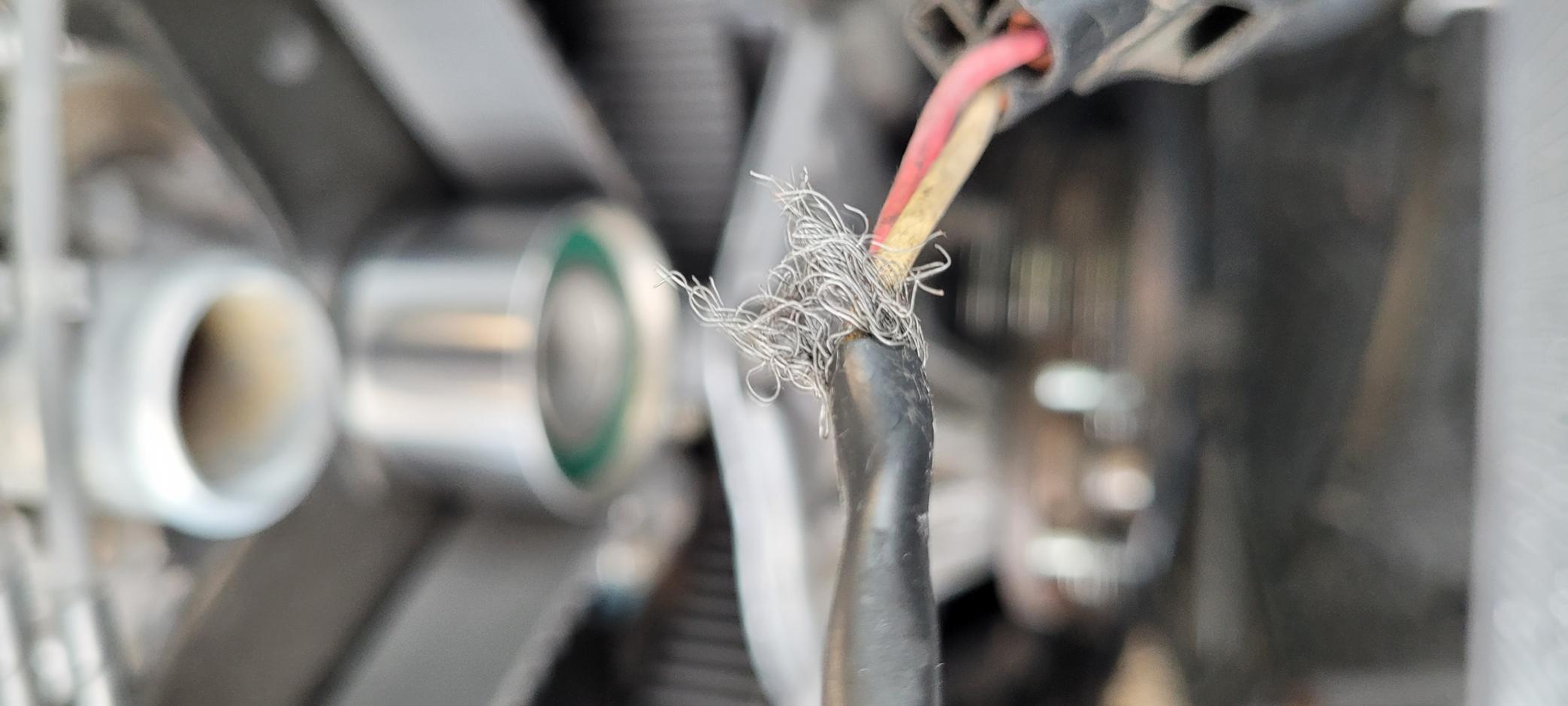

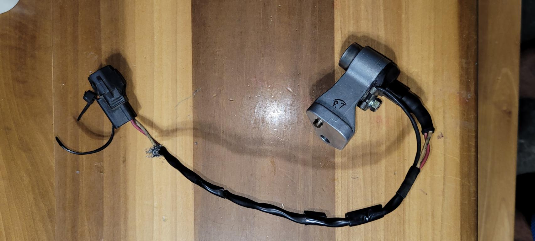

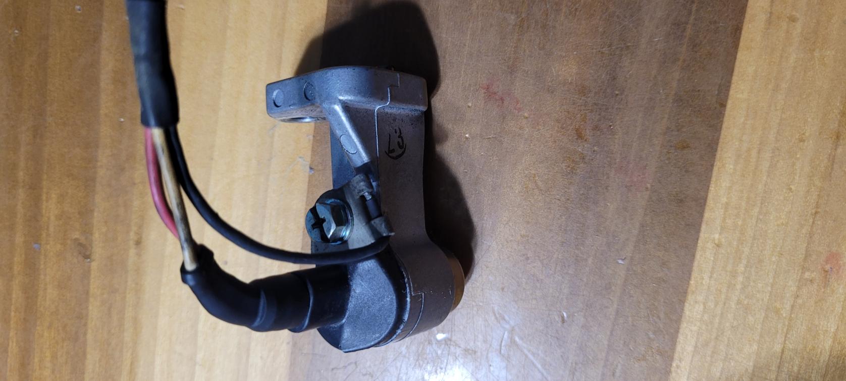

I'm taking everything off the front of the engine and decided to unwrap any wires that I had rewrapped and taped. This is my camshaft sensor and the end of the black wire that mounts to the body of the sensor. I wouldn't think that it's suppose to be this way.

I can confirm that your sprocket is flawless. There is a slight chance that the paint on the end of the tooth could interfere with the crank position sensor, but I really doubt it is the case.
Oh geez louise that's a grounded sensor!! 100% sure that's your problem. Remember what I was saying it was acting like you had a bad sensor? Well you just found it. Is that rats nest of a wire on the connecter side or the wiring harness side? Can't really tell. Obviously, that entire section needs to be cut out and replaced. Junkyard camshaft sensors work fine. I may even have one in my shed if you want it.
And you are saying there's other wires that are wrapped like this???

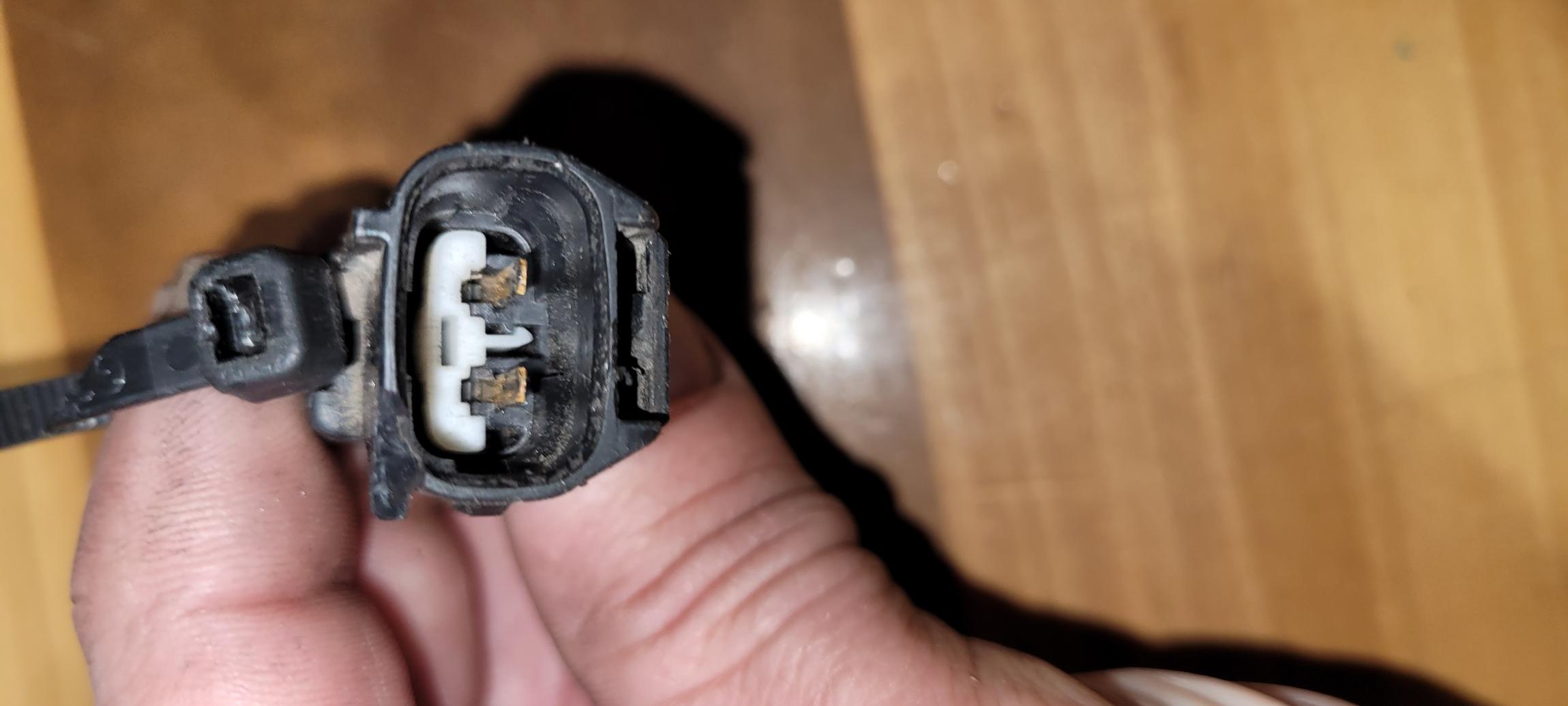

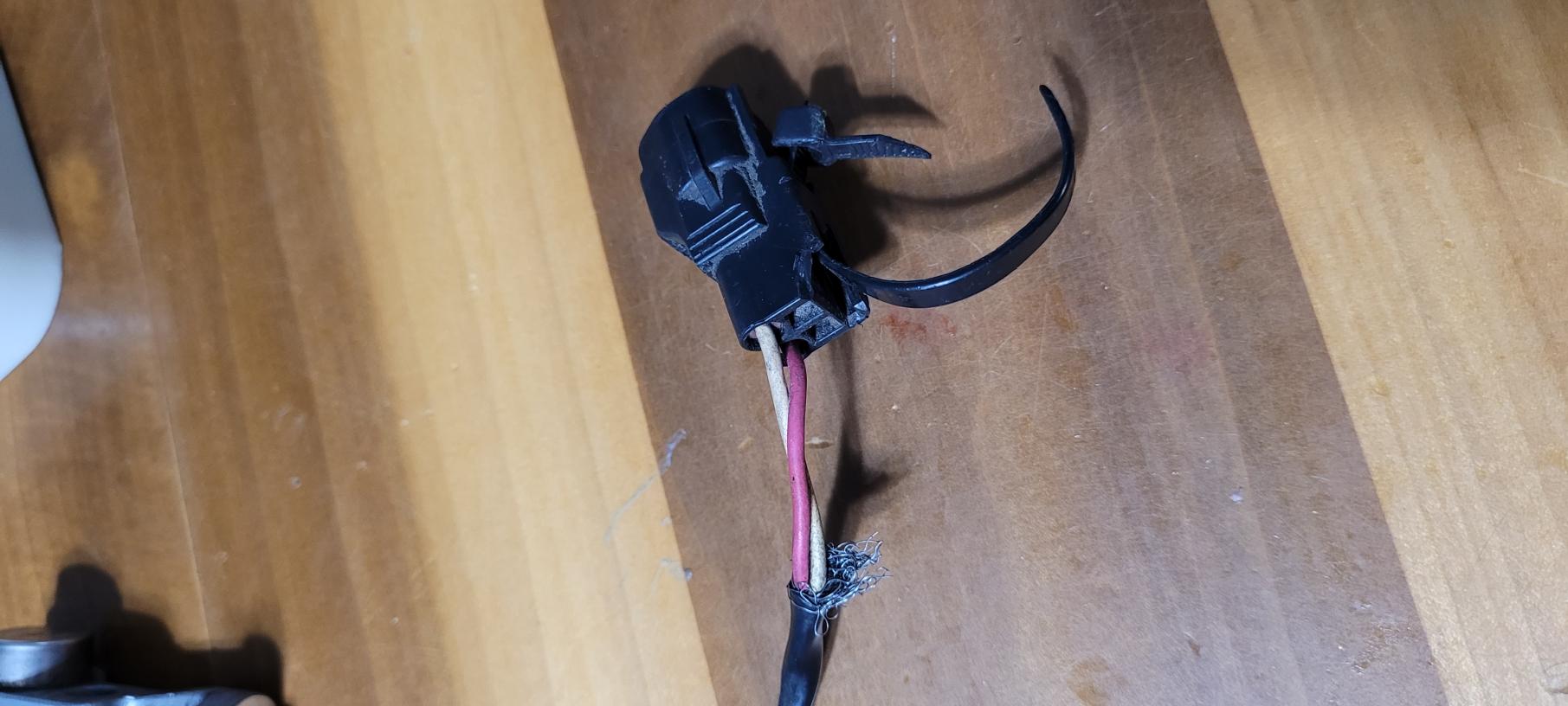

It is on the connector side but the connector has only 2 contacts so I don't believe it's suppose to be wired to the connector. I reloomed everything while doing this project is what I meant. There are no other wires wrapped up that are in the same condition as this one.
I think that's just shielding in the wiring harness. My electrical wiring diagram lists the camshaft and crankshaft sensor circuits as shielded, and it doesn't look like it's a frayed wire or that there is a spot in the connector for it. The one end of it looks to be grounded to the connector body as well.
I believe that is correct. A new sensor has 3 wires in the sensor side but only 2 go through the wire sleeve and into the connector.

A 30 min trip to the pick and pull and you'll know for sure if that's the problem or not. Shouldn't cost more than $15.
The last wiring harness I got with a donor motor from a later year 5VZ had 3 prongs on the harness and sensor side. My 96 and 97 harnesses both had 2 prongs on the harness and the sensor side. I don't know exactly when the change happened, but that is what mine are like. It is probably just an additional ground and I doubt that section is messed up with just the loom separating.
