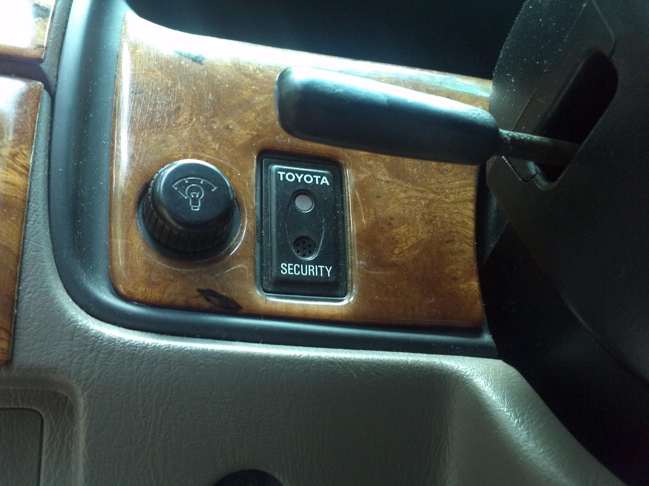

I've heard of them being up under the pass. side behind glove box. I take it you have the flashing led panel insert?

I see a red led light (not illuminated) in the dash to the left of the steering wheel. I'll shoot some pics of everything and try to post them here. The seats aren't heated.. so maybe the plug is a seat-belt thing.

It would look like this.
Panel led

All I have is the red led light which is off. No writing or anything else.. not the rectangular box around it either.

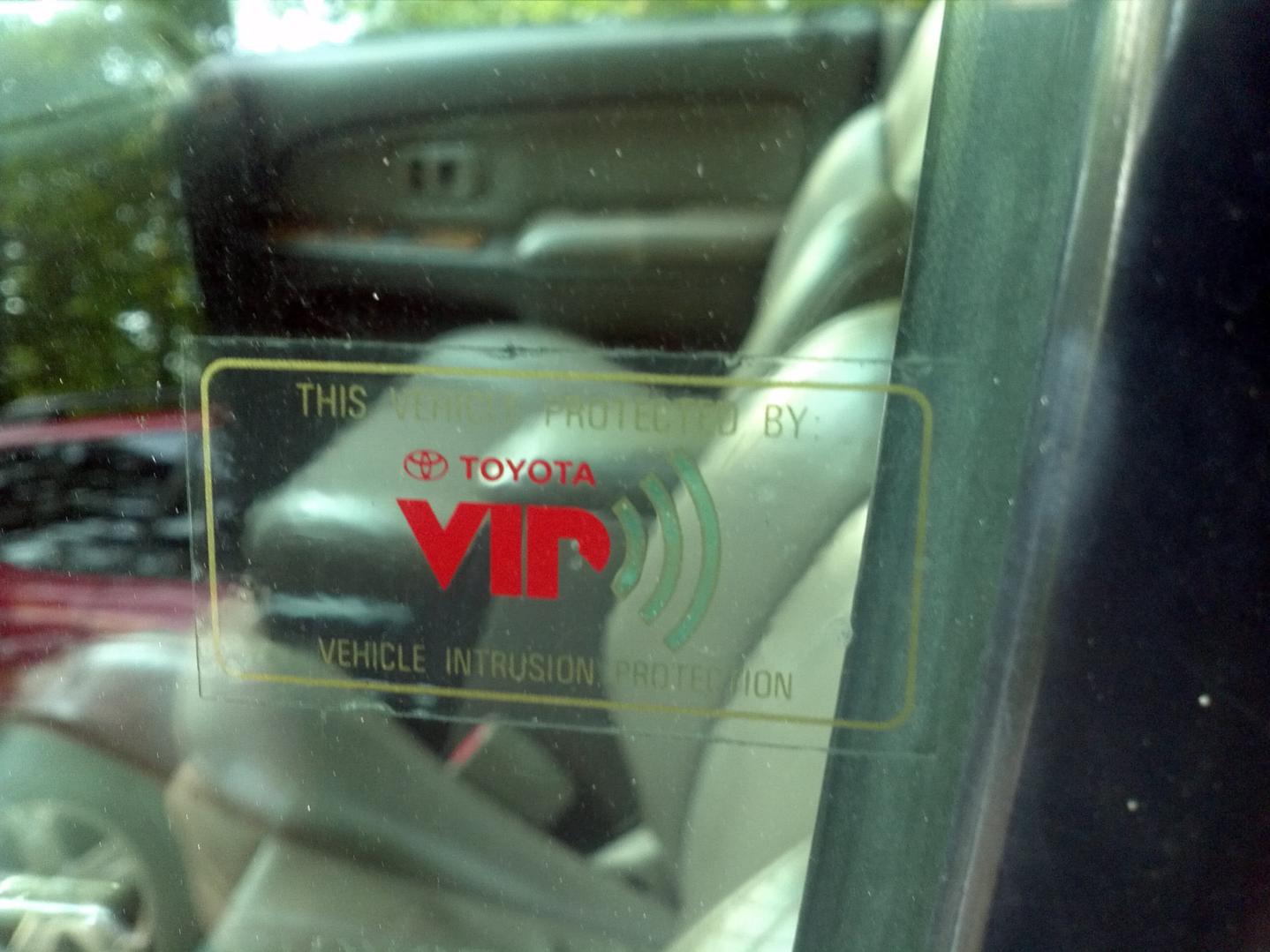

I'm pretty sure you don't have a factory setup. Plugging it in without any "control" doesn't do anything for you. IMO. Here is another hint that it's a factory item. Good luck with the research.

Isn't the Securikey another type of remote for the RS3000? Your 4Runner must've come from a Southern state, they were only installed there.
