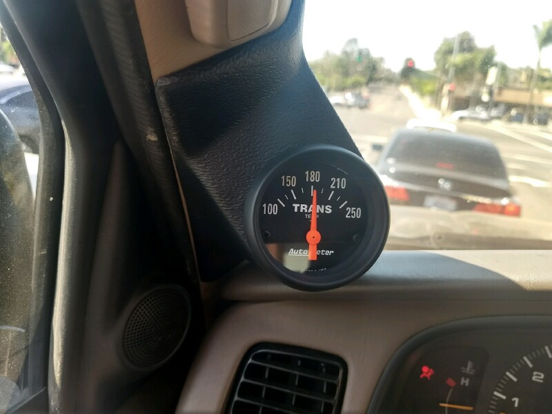

In the early 3rd Gens there is no provision for trans temps, I'm using Torque Pro, and a column pod with a mechanical gauge, It's been documented there is a sensor in the trans, but it does not report actual temps to the ECU, its a go/no go failure sensor that triggers an idiot light.
This is what I'm using.
And I tapped into the outbound hose going to the coolers So I'm reading my highest temps.
If you search, every guy has a different opinion on what temps to read.
use what you think is best for you.
What gauge pod is that? Ill probably go this route.
I provide a link to that pod in the video above. Open the video, go to YouTube and check the video description. Everything you need to do this job is listed in the video description.
