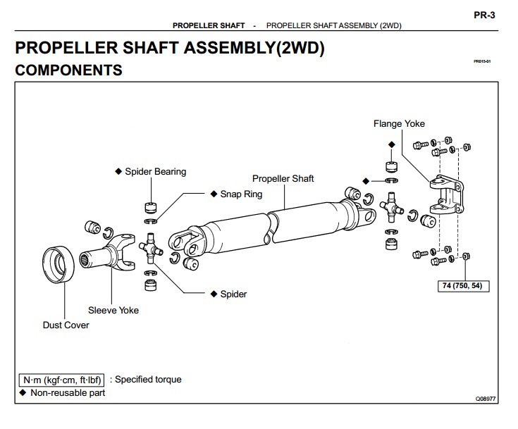

Also, found out there are indeed only two u-joints. The 4x4 has three while the 2wd has two.
Here's a pic of the 2WD diagram.
The U-Joint is referred to as a "spider" in the diagram.
