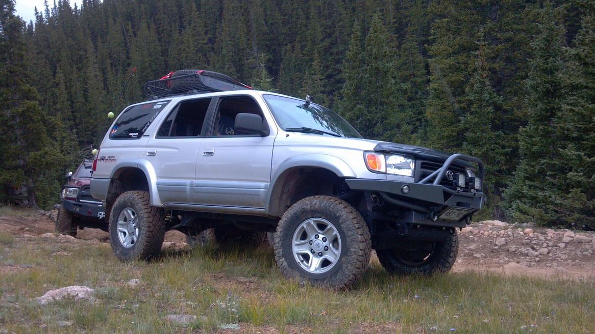

Alright so I've looked every where for the answer for my question. I have a 99 Limited 4runner, with the original key fob. I can lock and unlock the doors with it and roll down the rear window. But out of curiosity I decided to see if the alarm would go off if I locked it with the fob, and unlocked it with the key. Nothing, I didn't go off. So I tried locking it with the fob while I was in it. And just pulled the door lock up and opened the door, nothing again. So my question is when will the alarm go off? Or does it at all? The reason I ask is because I had a 97 SR5 and locked it with the fob and forgot I had did so. I unlocked it with the key and the alarm went off and I couldn't start it. So any help would be great or any info. And btw the panic function works.
