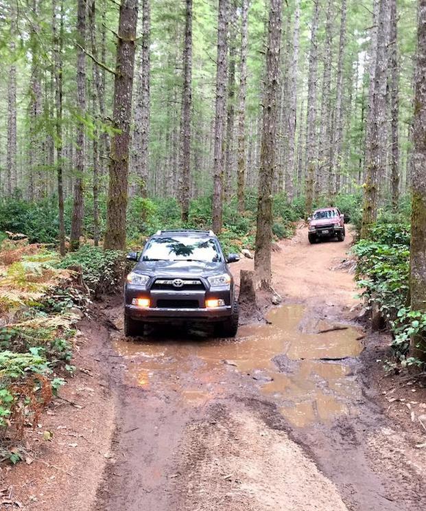

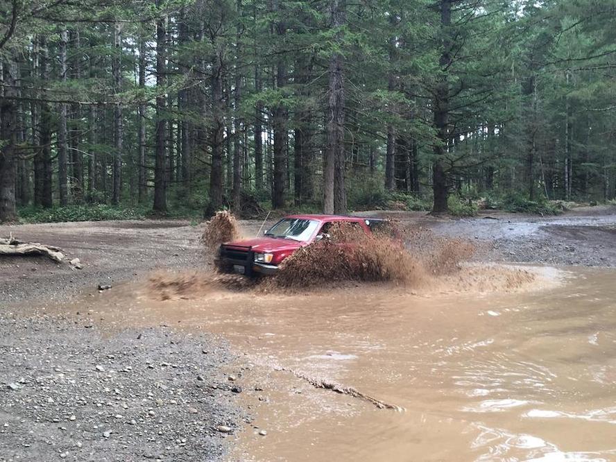

I have the bfg all terrain t/a's and love the heck out of them we took them off road with all of the 5th gen guys and they did amazing. I would buy another set but i want a more aggressive tire for off road. I will probably eventually buy another set just so that i dont have to run my wheelin tires on the road all the time. and there is something to be said about a tread pattern that has not been changed in years and every other company copies it for their own all terrain tires. mine are 30x9.5r15 but i could clear 33's with no prob on the stock suspension which you should to this is where mine took us

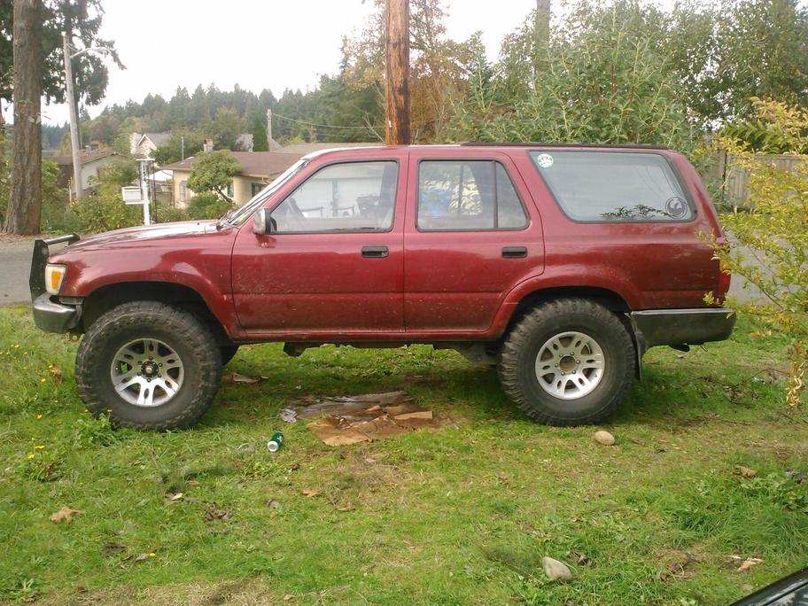

this is my 2nd gen with 35's on the stock suspension and they almost cleared totally with minor modification. But a set of 33x10.5 or 33x9.5 should do you perfect thats what im going to go with if i get tires before my lift gets put on
Dude, I don't even know where to start.
a) You can physically install 35s on a second gen and they'll probably not touch the truck when your truck is parked level in your front yard, but the first time you flex out you're going to tear off your rear mudflaps first and the bumper trim pieces will follow shortly after and then you're going to start bending sheet metal. At the same time, the front tires will be gashing themselves to pieces on the front firewall and tearing up your fenders. 35s do not "fit" a second gen on stock suspension.
b) even if they did, your second gen is not the OPs 3rd gen. Some guys are able to get 33s to clear on first/second gens (and by clear, I mean really clear, not your definition), but they will invariably rub on a third gen at stock height. They rub frame, and they rub fender trim.
You really need to stop giving bad advice. It's obvious you're eager to help others and that's fine, but stop going off half-cocked. Know what you're talking about before you start yapping next time, ok?
