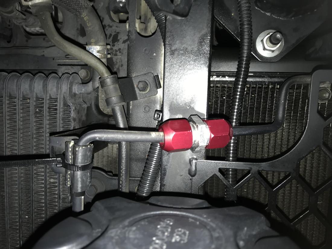

Seymore Butts New member Apr 23, 2018 #3 Glad to hear it was an easy repair. Do you have a pic of the splice installed? How is it held in - a pair of compression fittings?

D drbyrdman New member Apr 23, 2018 #4 seymore butts said: glad to hear it was an easy repair. Do you have a pic of the splice installed? How is it held in - a pair of compression fittings? Click to expand... Attachments download.jpg 6 KB · Views: 137

D drbyrdman New member Apr 24, 2018 #6 Worked good a/c is cold as shit. Attachments IMG_0756.jpg 135 KB · Views: 117
