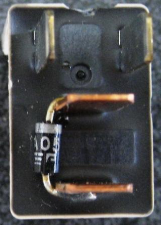

Here's the intended orientation of the protection diode. I don't advise anyone else try this since my relay didn't survive the heat from the soldering iron -- ended up dead completely. :bash:
UPDATE: This circuit doesn't work -- see later posts for the correct solution.

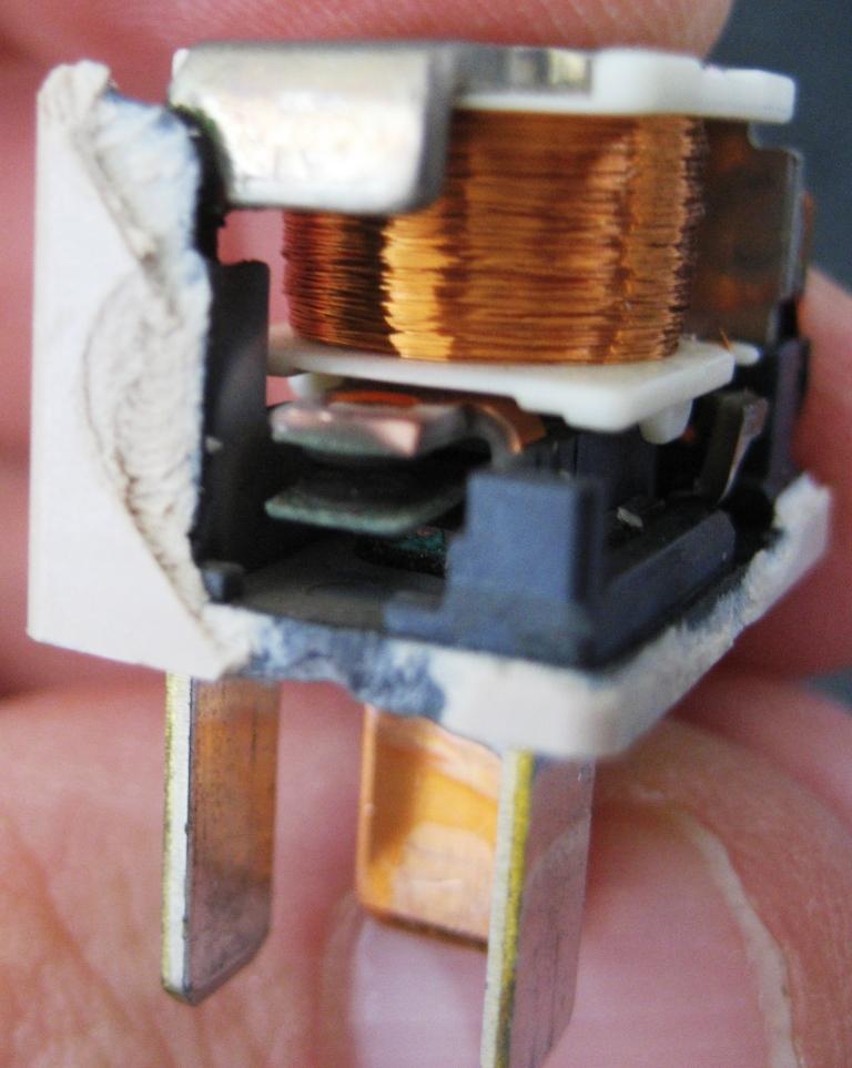

Since my relay is now completely dead, I thought I'd go ahead and confirm a few theories.
A) This is a mechanical relay -- OK, I already knew that since I could hear it clicking on/off on the bench.
B) The charring around the relay contacts supports the theory that arcing is causing the premature failure. A diode as pictured above would solve this problem.

rando said:
B) The charring around the relay contacts supports the theory that arc'ing is causing the premature failure. A diode as pictured above would solve this problem.
Thanks for the disection Rando. Good info.

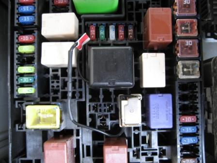

These are the locations to connect the diode. The diode is hidden underneath the heat shrink. The red sticker indicates the diode anode.
Anode goes to GND - Pin #4 (center pin) of the Heater relay
Cathode (striped side of diode) goes to the load - Pin #3 of MG CLT relay

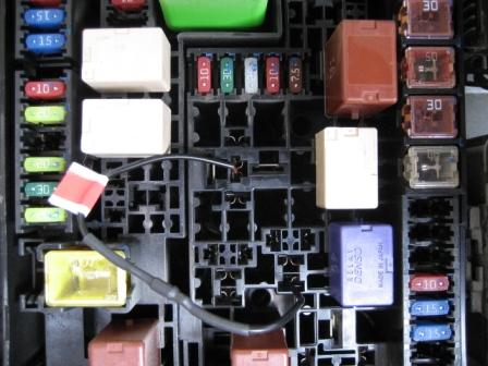

Here's what it looks like with the relays installed. Hopefully your MG CLT relay doesn't look like mine! :biggrin2:
If you're just reading these last two posts, I've confirmed that this eliminates the arcing inside of the relay. If you have the old style relay and it hasn't failed yet (and you're out of warranty), you can save yourself $50+ and install the bypass for < $1.

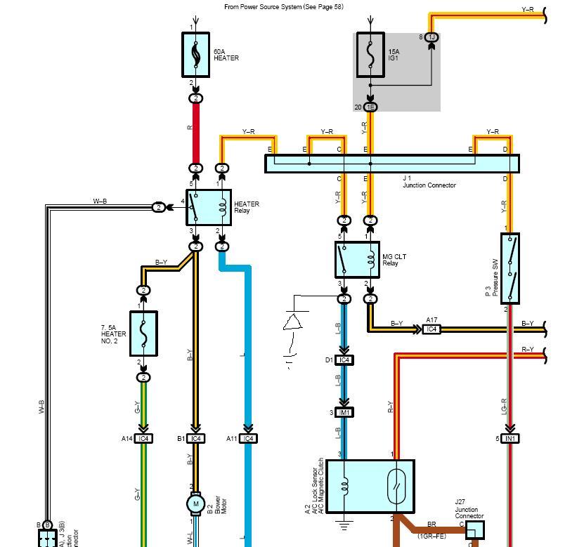

Here's the modified circuit. Per the diagram, you could tap D1 at connector IC4 with an in-line tap to get a cleaner install. IC4 is behind the driver kick panel.
