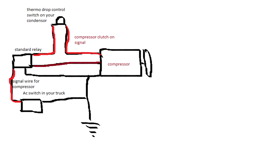

your lucky you can just use a GM compressor youll have to rig your stock ac lines to fit the gm pump but as long as you can do that your stock heater controls should control the flow into the vehicle and your fan will control how much cold air can come in you wont get as good of climate control via the slider but you will get cold air.
http://www.senasys.com/shop/products-page/2511-34-heavy-duty/2511l036/
so with this switch i would go open by 45 and close by 35.
when the the condenser hits 45 degrees the circuit will open and turn the pump on then when it hits 35 degrees it will close the circuit turning the compressor off.
its crude but it will work without a bunch of headaches and its only like 20$ total to do this

dont try to make sense of your set up make your own
2511L036 |

I appreciate it bad! I was looking at it way too hard. Kick-Ass drawing by the way.

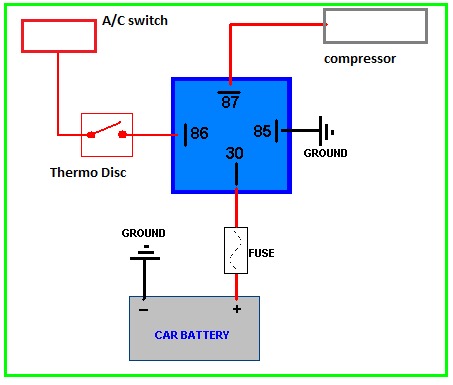

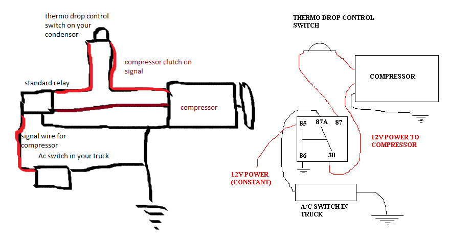

This is a first for me so I did some reading and tried to learn a little about this. Then I went off of BV's diagram and tried to understand his rough drawing. I basically came up with this. I used a standard 5 pin relay (as opposed to BV's 4-pin drawing). From what I understand on how a relay would work in this application and what the a/c compressor needs, this should be a dummy proof diagram of the install. Let me know if this seems way off and I'll modify or delete this post to prevent confusion. This is good info for motor swap guys so lets see if we can get as detailed as possible here.
BV's diagram on the left, mine on the right.

for future reference the only reason for the relay is to send power to the thermo drop switch only when you push the ac button in the truck. so if the ac isnt on your compressor will be in free turn mode
One thing though, sorry i looked at it about 5am.
I have 1 wire on my compressor. It has a ground but going to itself. I assume still use 87. I dont think I want the the thermodisc cutting the power to the compressor but instead to the relay. It would be alot easier to cut power on the switched side of the relay. If you do it on the compressor side, you basically turn the thermodisc into the relay.

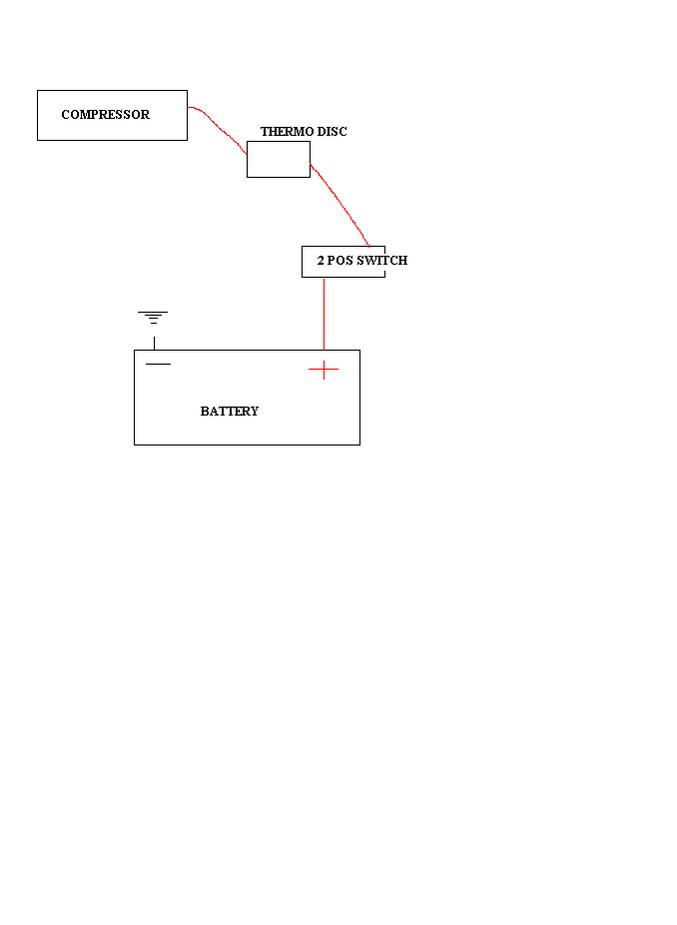

In that case, adding a relay would be pointless unless I'm missing something. Just run your fused power directly to your on/off switch.
Simple yes, but too many amps get pulled through the switch. It would eventually melt the switch down.
thermo drop sensors delicate they need to control a signal only not a load.
you would have to have the sensor switch the relay that will ensure longevity and reliability
From my understanding, the only times when you need a relay is when you want to either reduce your wiring or have one switched power source run multiple things. In your case with the earlier schematics, it was to reduce your wiring to run constant power to your compressor and switched power to your thermo disconnect.

But in your case you have a 1 wire compressor. That one wire just controls your mag clutch. You don't need a relay, that just complicates things and adds un-necessary wires to the mess.
Well that defeats the purpose of having a factory switch to use.
You should always use relays in high amp circumstances. That way the relay is doing the grunt of the work, the switch is just turning the relay on. Your wires will be a lot happier too.
