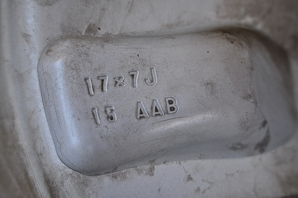

I have a set of 2010 SR5 rims with BFG AT's on them that I am selling and they are 17x7J. I doubt they changed them but who knows?

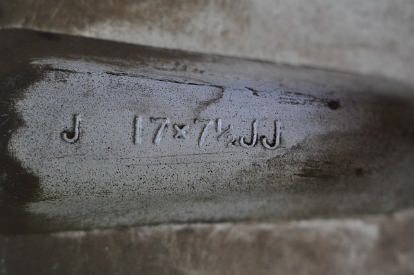

I also have a set of 2008 Sport Ed. rims with BFG AT's and they are 17x7 1/2
You can tell on Toyota truck rims as it's cast in the back of the rim when they made it.Easy to look and check yours.
Do you have a lift ?Do you have rubbing with the 285 BFG's when backing up and wheels cut like when backing out of a parking place?
First pic is the SR5 and the second is the Sport Ed.
