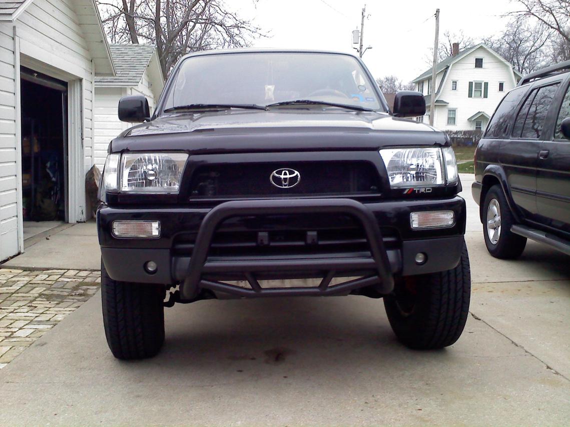

A few pictures of my Runner

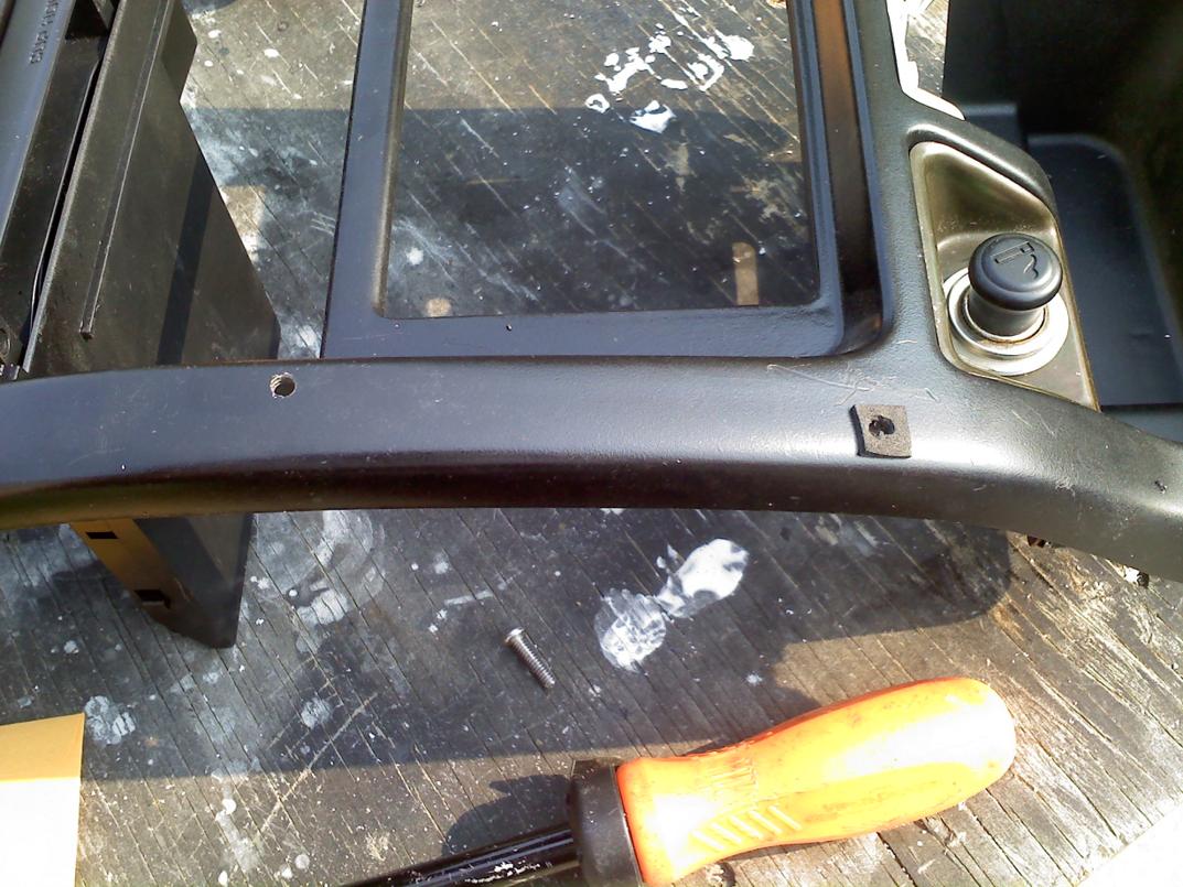

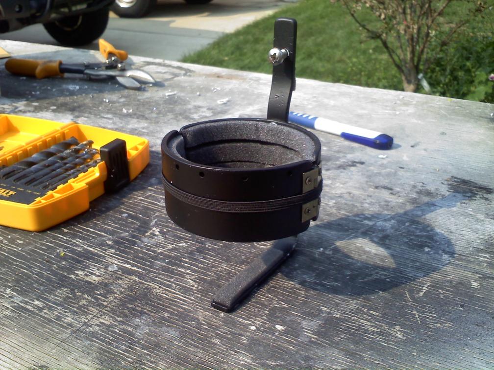

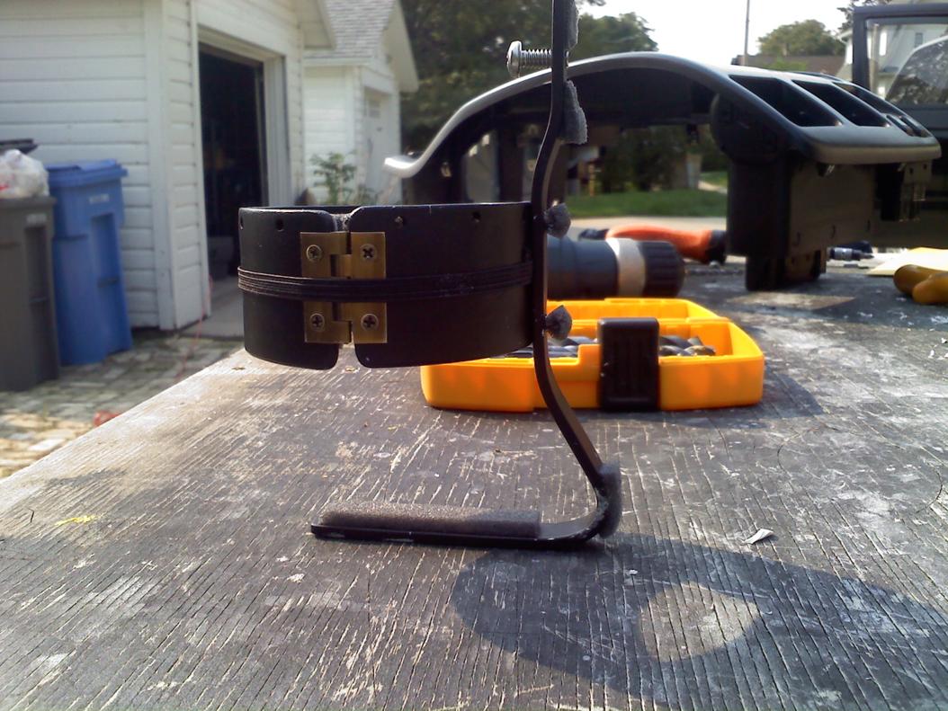

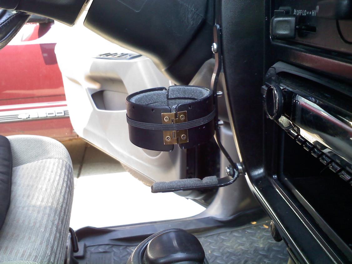

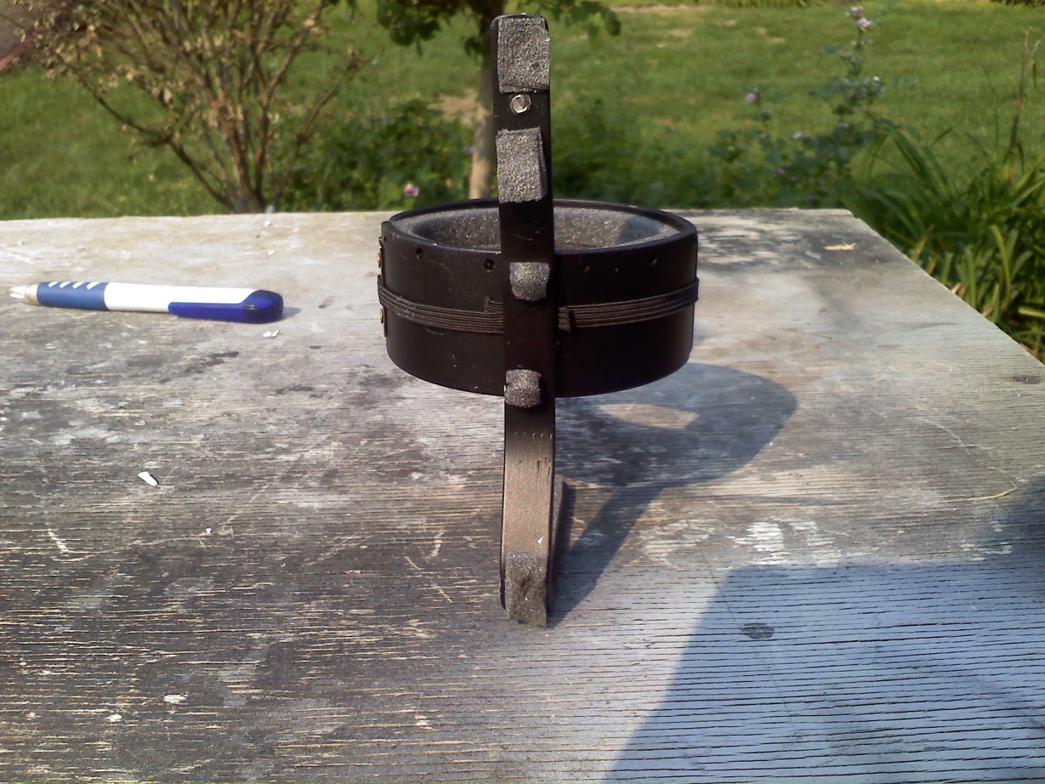

My "Taylor" Made Cup Holder

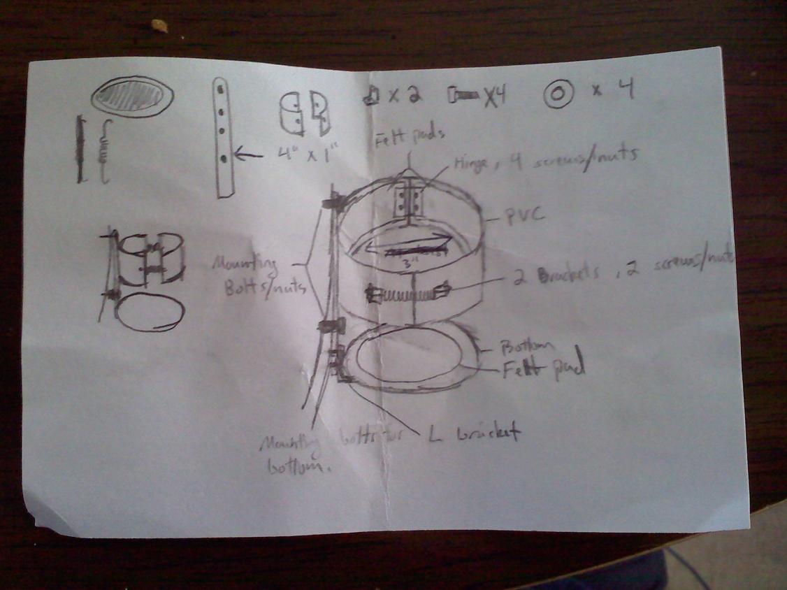

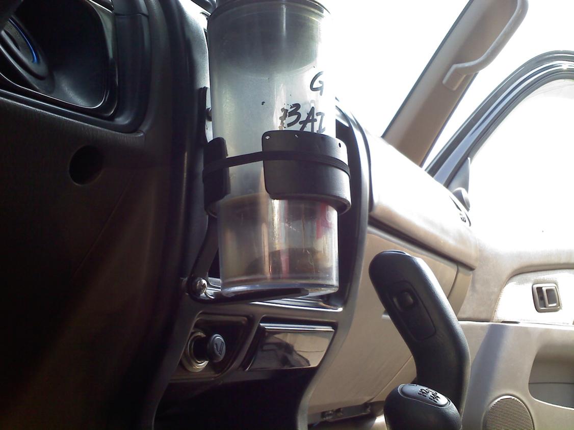

So I did'nt want to spend the money on the 99+ cup holder. Plus you loose a bit of cargo room with it. I wanted something custom that would work perfectly, be located in the best possible spot, and accomidate a large range of cups. So I went to the drawing board and designed my own cup holder.
I strayed from the original design. The final product is a bit more simple, but better than the mock up.

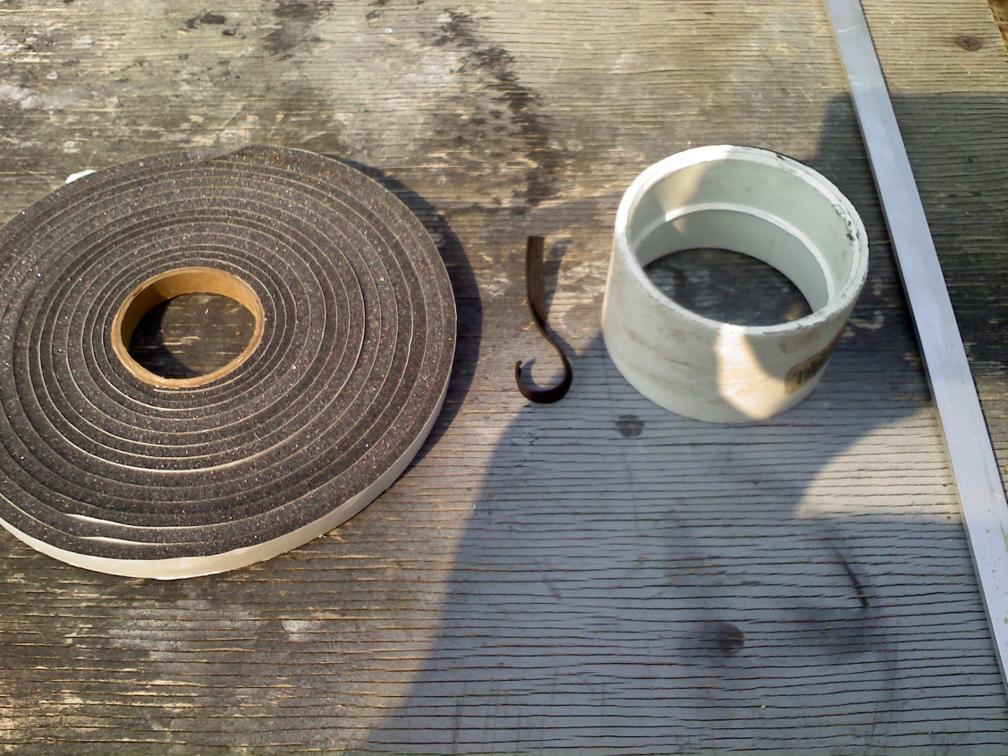

Here's what I used. A sturdy strip of aluminum, foam tape used for sealing doors, some stretchy cord, a 3" diameter section of PVC, and not pictured is an assortment of machine screws with nuts and washers, a small hinge, primer and trim paint, and a small washer I made from a scrap peice of plastic. This is basically all you need. I got everything from ACE Hardware for about $15.
The pictures are fairly self explainatory, so Ill only give a few details.
I cut off a section of PVC at a width that I thought would work well for a variety of cup sizes, and then cut it in half vertically. I then drilled and fit the hinge in place, formed the stip of aluminum to accomidate the screws seat at 90 degrees, and then drilled the holes and put it together. Then I disassembled it to prime and paint. I let it dry over night and then put it back together and added the foam.
Here's the finished product uninstalled.
And now to mount it.

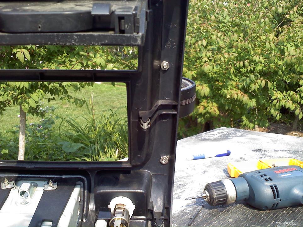

I Lined it up on the dash bezel, drilled my holes, and screwed it into place.
A nut on each screw to hold it securely.

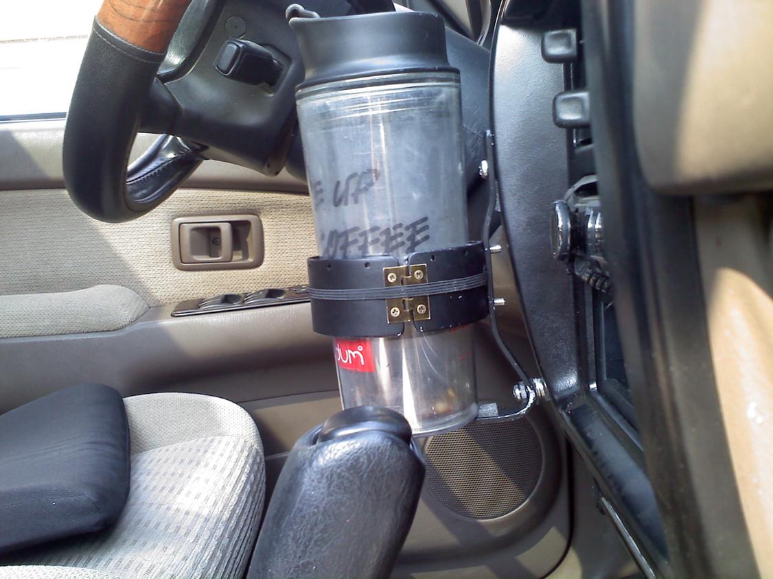

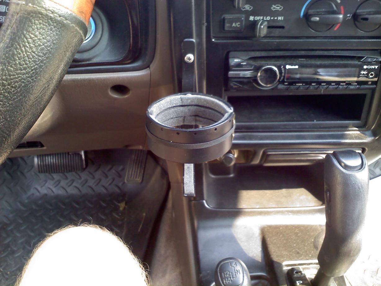

>>> continued from previous post >>>

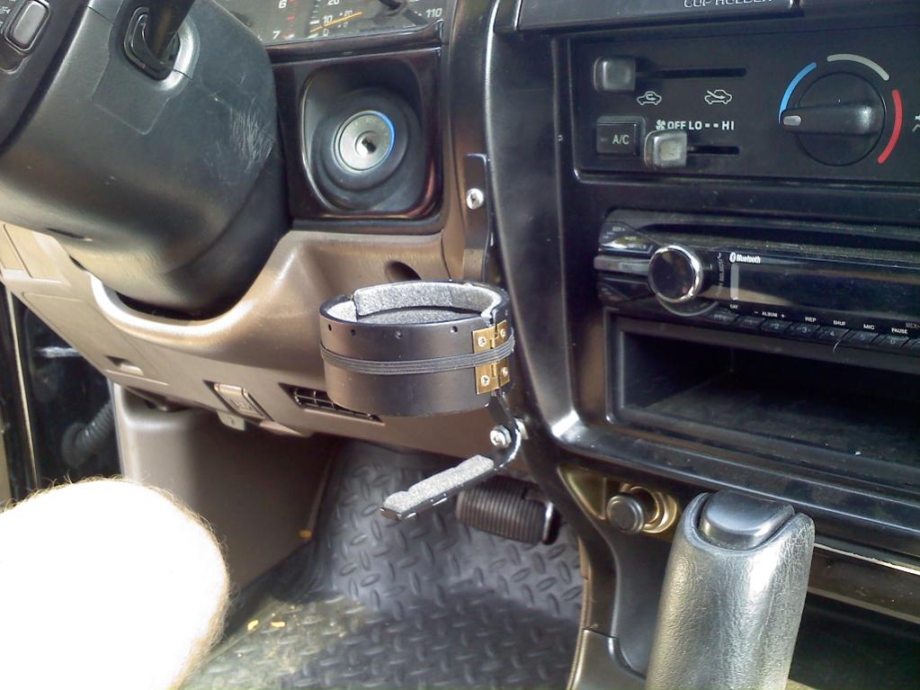

Here's what it lookes like with eveything back into place.

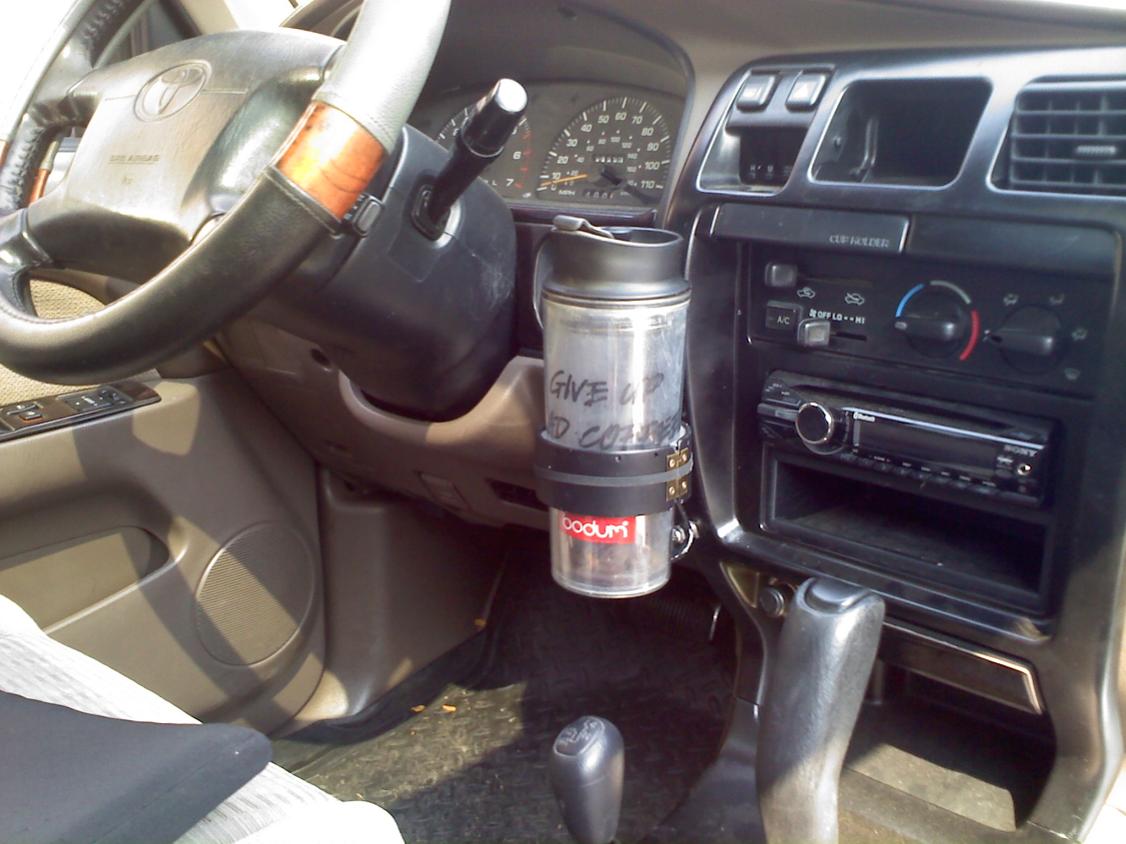

And with a large cup in place.
MY CONCLUSIONS:
This little cup holder is sweet! It works perfectly and holds any size cup you throw in it. The mounting is rigid and strong, while the foam allows some cushion. I think it looks pretty cool empty. Its not too big or gaudy. The tension from the cord is perfect. It holds just tight enough, but not so tightly that its a pain pulling the cup out and putting it back into place. No more dealing with the cup sliding all over every time I hit a bump. And the location is perfect. No more blocking the ac/heater and clock. It does'nt interfere with the steering wheel or wiper lever at all, and is at a perfect distance for my short arm to reach. For all of you 96 to 98 guys out there, I think you would really enjoy this little mod. For 3 to 4 hours of work, and $15, it's well worth it!

Curious... did you use locktite on those nuts? Not much thread to work out on a rough trail. I'd have used a nylon locknut. Just an observation.

Question... is it a one handed or two handed operation to insert/remove?
Thanks man. I love the thing. I use every day on my 45 minute drive to work, and I can put anything in it. I just use one hand. Its kinda hard to explain, but if the bottom of the cup is larger than the opening, you just put it in using one edge first, and kinda pry it open. I have never used two hands. And on most tapered cups the bottom is narrow enough to just push right into the cup holder.

Im not sure what youre referring to here?

And I think he's referring to the nuts you used on the back side of the trim to secure your cup holder...maybe those can work themselves loose...a cheap solution would be nylon nuts...but it doesn't look like you've had any problems with them yet.
Oh. Ya that would be a good idea. But I dont think there will be any problems the way it is. The bottom one is fully threaded, it just doesnt look like it in that picuture. And since the nut is secured against the bezel, the plastic is crimped and keeps pressure on that nut.

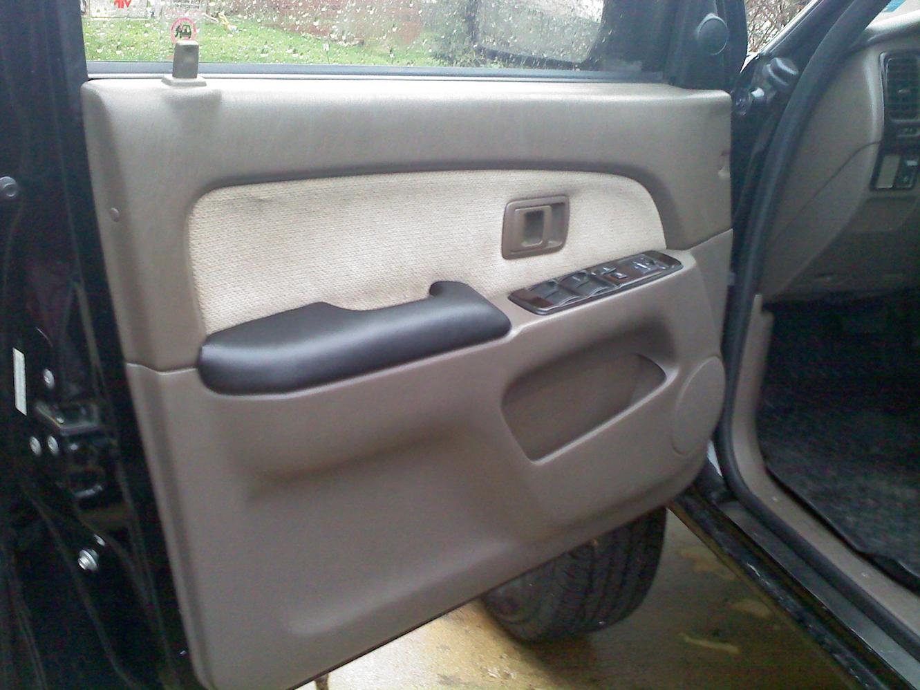

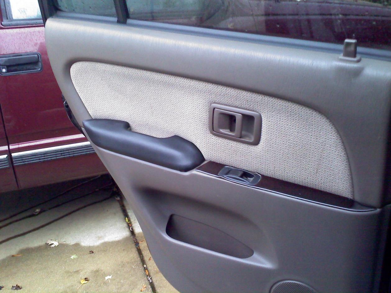

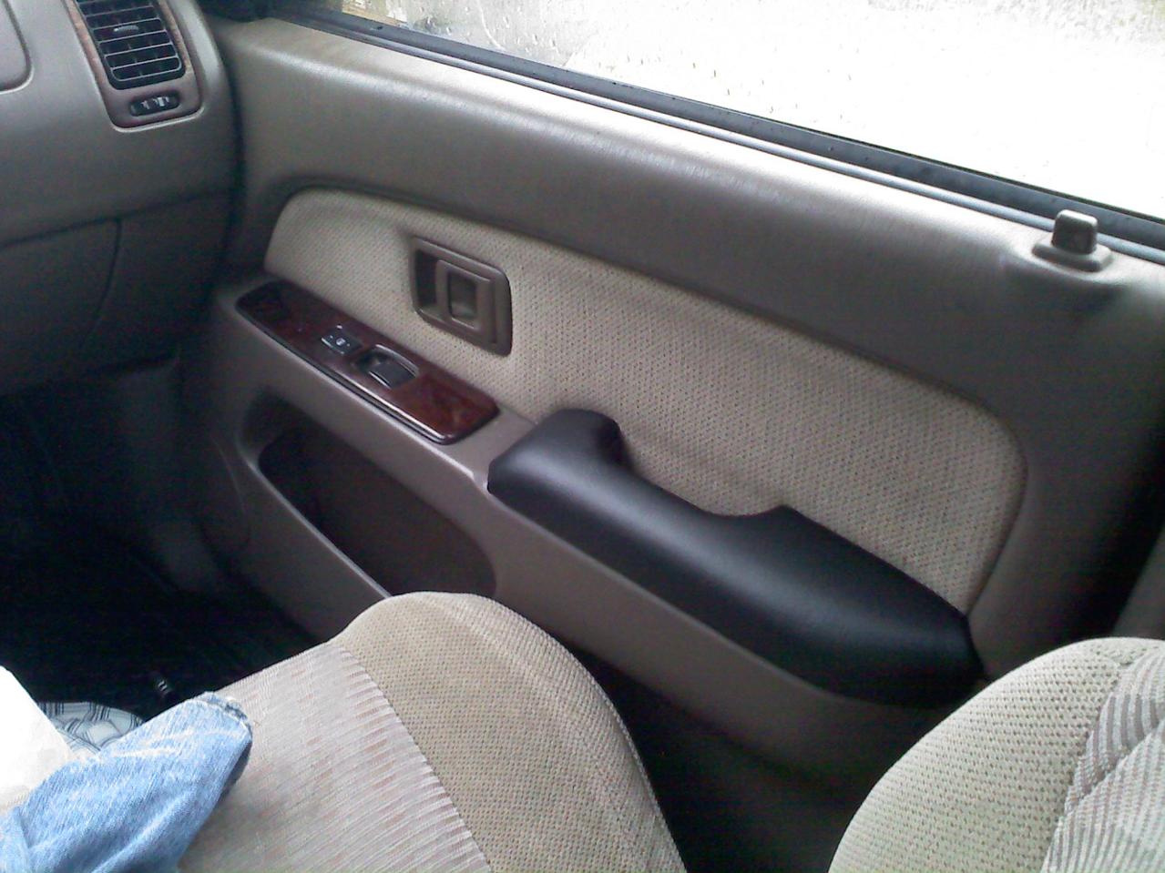

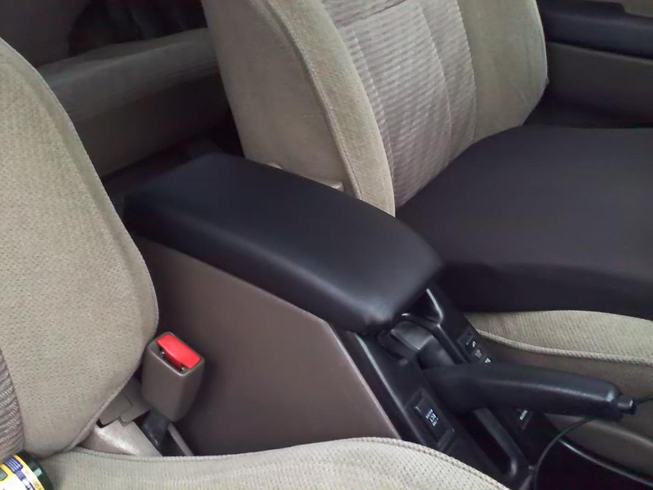

Added some black interior vinyl to the door handles and console lid. I like the look and feel . . . its like leather. Its really durable, waterproof, stain proof, etc . . . Plus its covering the fabric so I can take it off any time to go back to original.

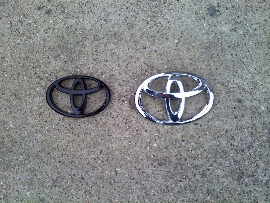

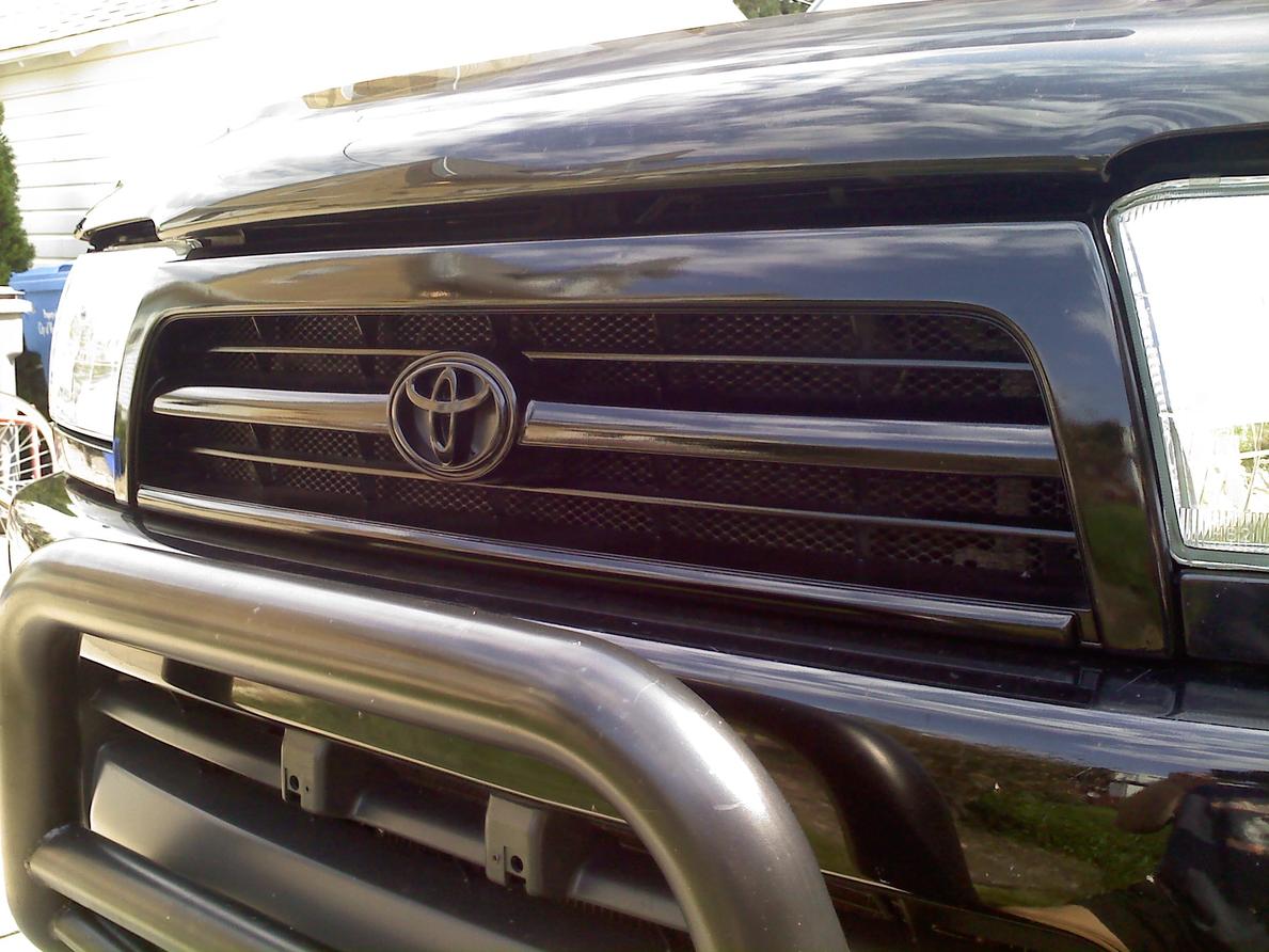

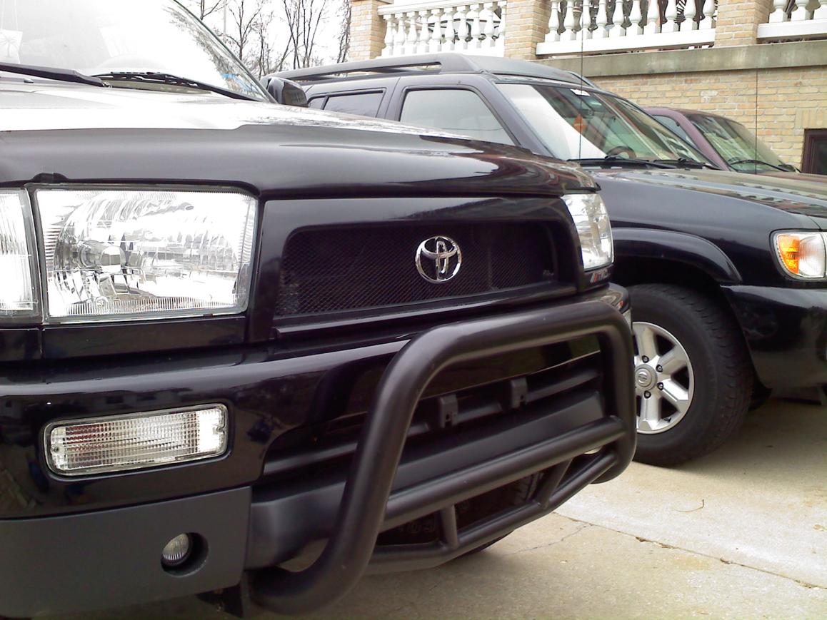

I did my rendition of the sotoshi mod over the past few days. I replaced my original 4runner emblem from a new Tundra one as its much larger. I also used trim around the back edge to make it look sharp. This was my first experience with Bondo, and I had to apply and sand it twice to get a good finish. Also, I used flat black vinyl on the inside edges rather than paint as its too cold to paint and I dont have access to a heated garage. It looks sharp, though I will probably end up painting the whole thing in the spring.
What my grill looked like factory
What it looked like a few days ago before the sotoshi mod (honestly I think this grill looked very sharp fully color matched)
Size difference between the emblems
And what it looks like now after the sotoshi mod
Here you can see the black trim on the inside edge

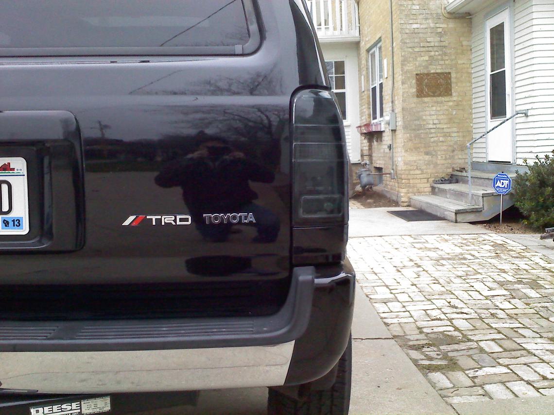

I also tinted my tail lights. I really cant decide if Im sold on it.

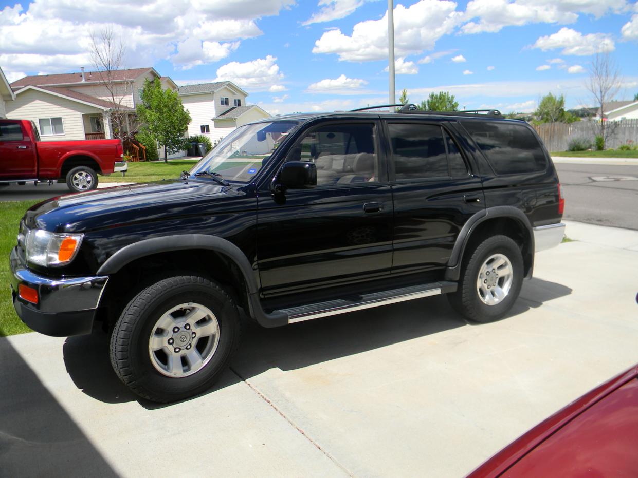

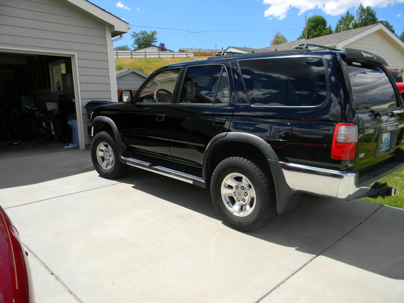

So Im back in Wyoming on vacation for Christmas, and I was looking through my parents pictures and found a few shots of my 4runner taken right after I got it back in august of 2010. Running boards still one!
