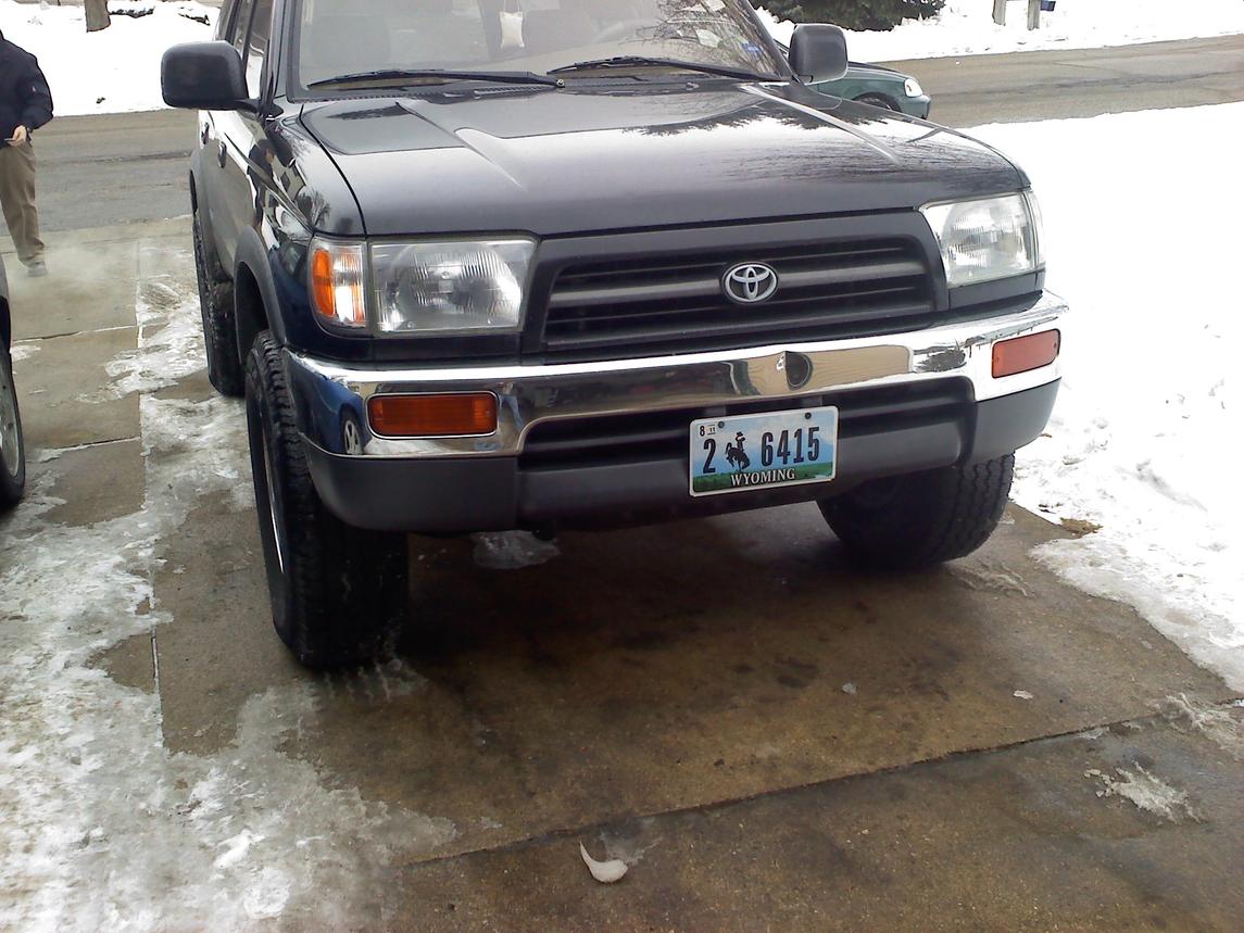

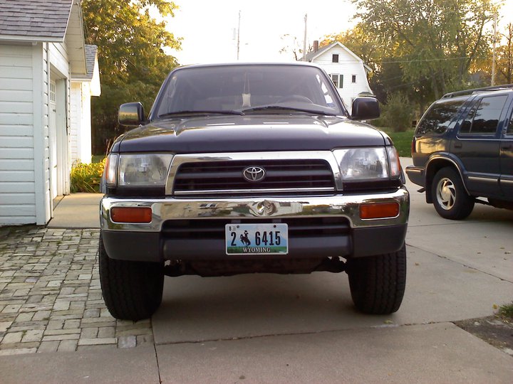

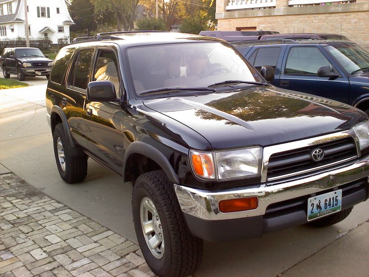

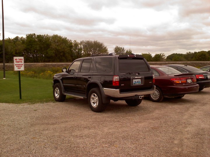

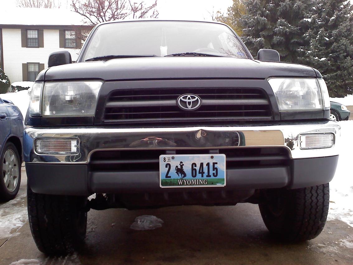

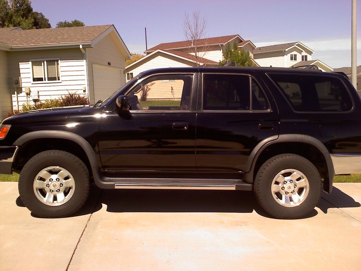

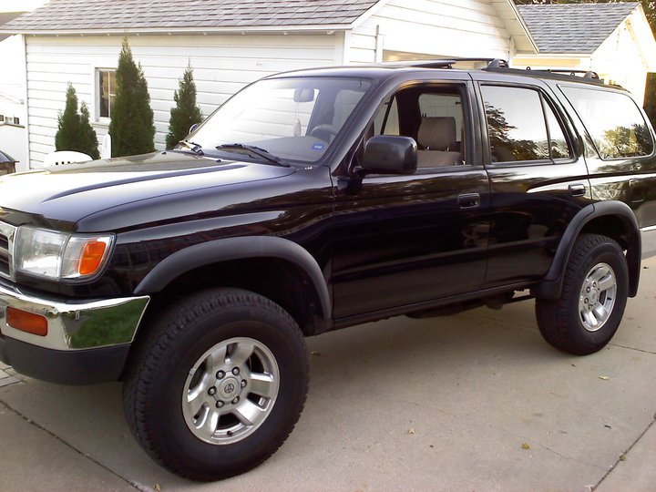

8/5/10
Here it is the week I bought it. Running boards still on.
Running boards off. Amazing how just removing running boards gives it an instant lift.

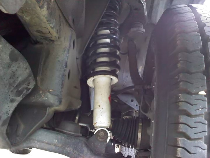

About a month ago I installed KYB gas shocks. Tires are brand new Goodyear Wrangler RT/S 265 70 16. Ive learned that tires for this vehicle are significantly more expensive than for my old Ford Taurus!

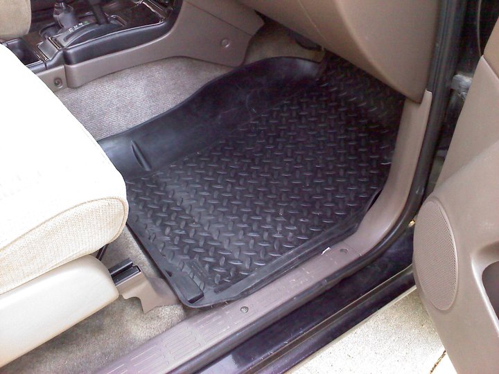

I bought the Husky liners to protect the carpet. They're a great investment here in Wisconsin, or any mid-west state where they use salt during the winter. These liners are awesome! Also have them in the back. And plan on getting the cargo liner eventually.

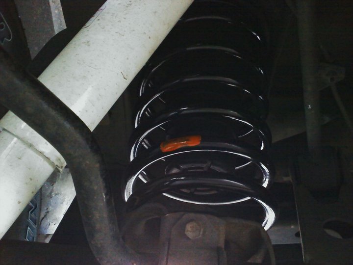

Last week I brought it in to a Toyota service center and got new rear coils and cones via the factory recall on the original springs. Nice freebie.
More to come

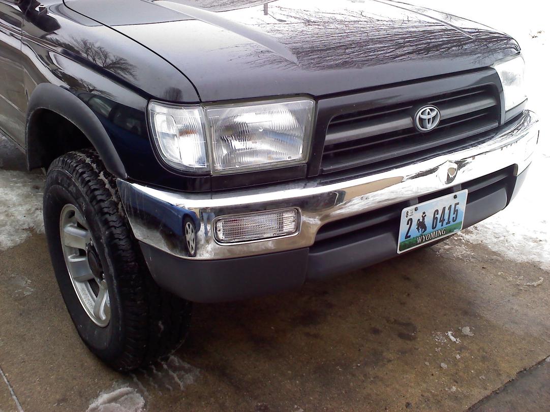

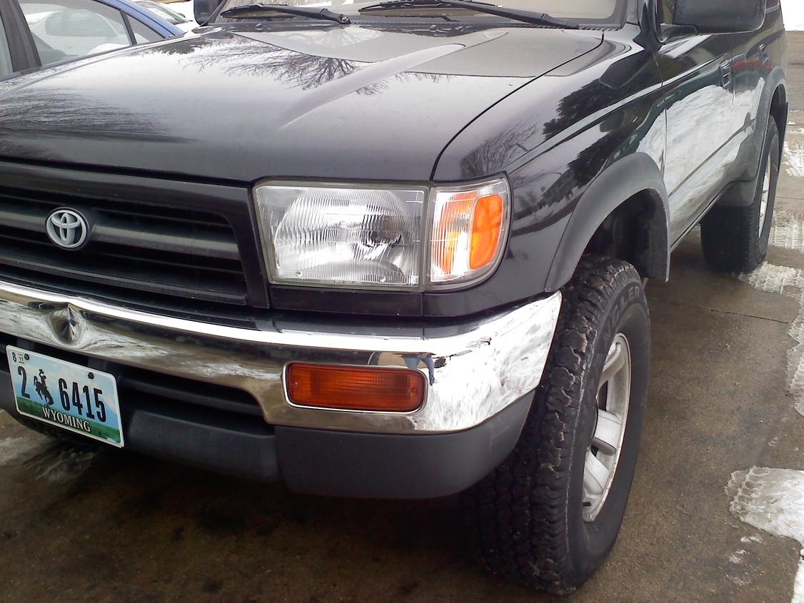

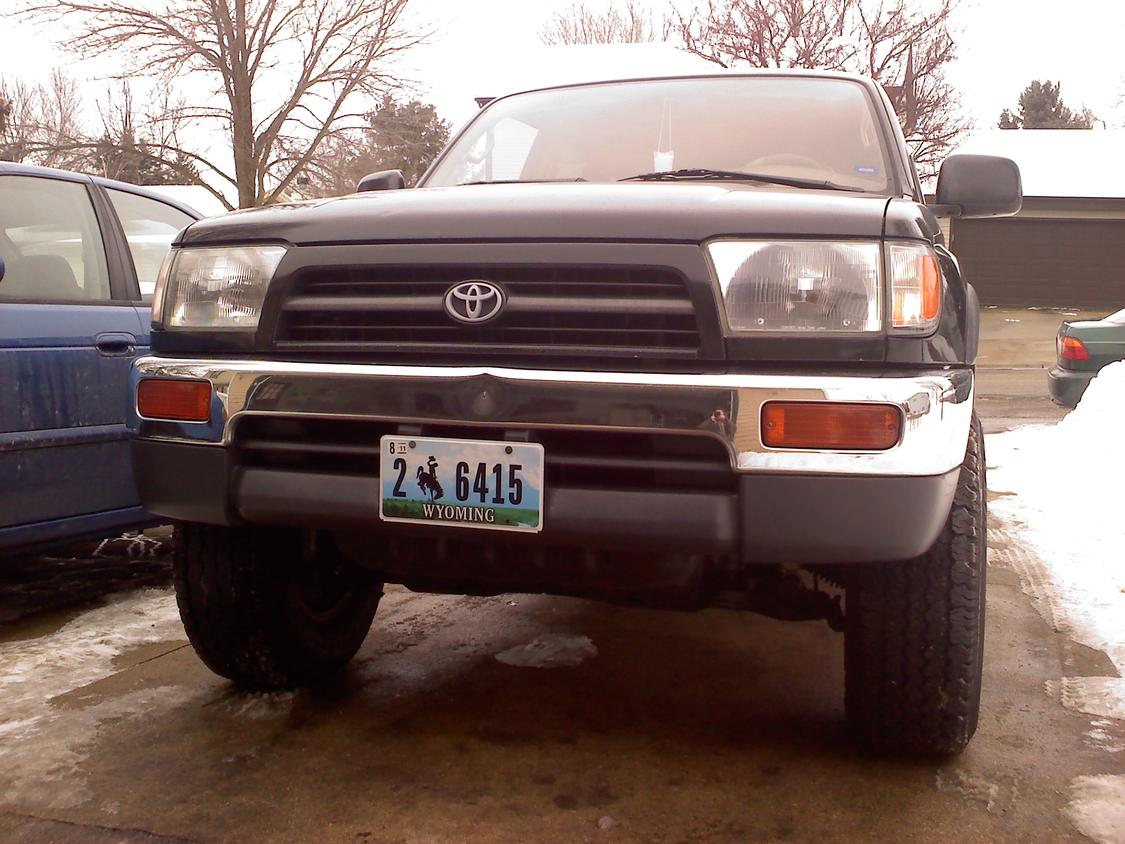

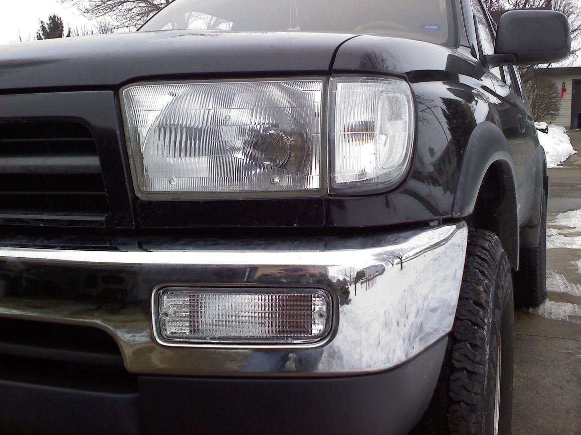

Clear lenses
Just changed out my orange front bumper and driving lenses with clear lenses. Soon to do the rear lights as well. I love the looks of the clear. If anyone wants to buy my orange lenses, they're in excellent condition.

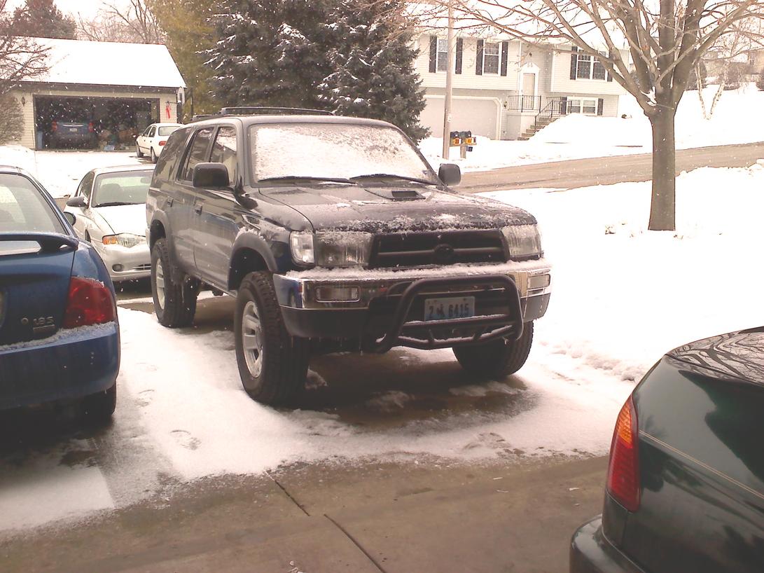

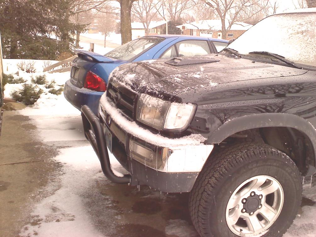

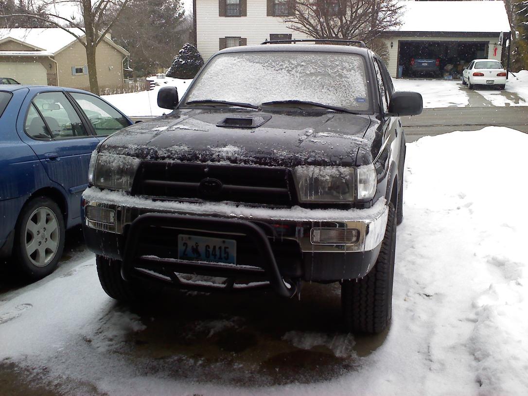

Added a bull bar and hood scoop yesterday. Bull bar added 10 hp and the strictly cosmetic hood scoop added 30 hp.
Damn, 30HP?
The stock scoop doesn't add any... though, if you swap on the factory scoop, there's some power horsepower gains... say... 1HP per square inch, then 1,600 millimeter ounces per square gram of weight in torque... Makes up for that costly engine turbine swap, if you ask me.
Each to his own... I guess.
Awesome.
:jump:
Made by Hunter i think. I think we have the exact same one. Does yours sit a little crooked? The right side of mine (from driver perspective) sits a little further out than the left side. I had to use a giant washer as a spacer to make it even.
You made me nervous. I just went outside and checked it. It seems fine. I don't think it is sticking out further on either end. But good job on the washer fix :thumb3:
