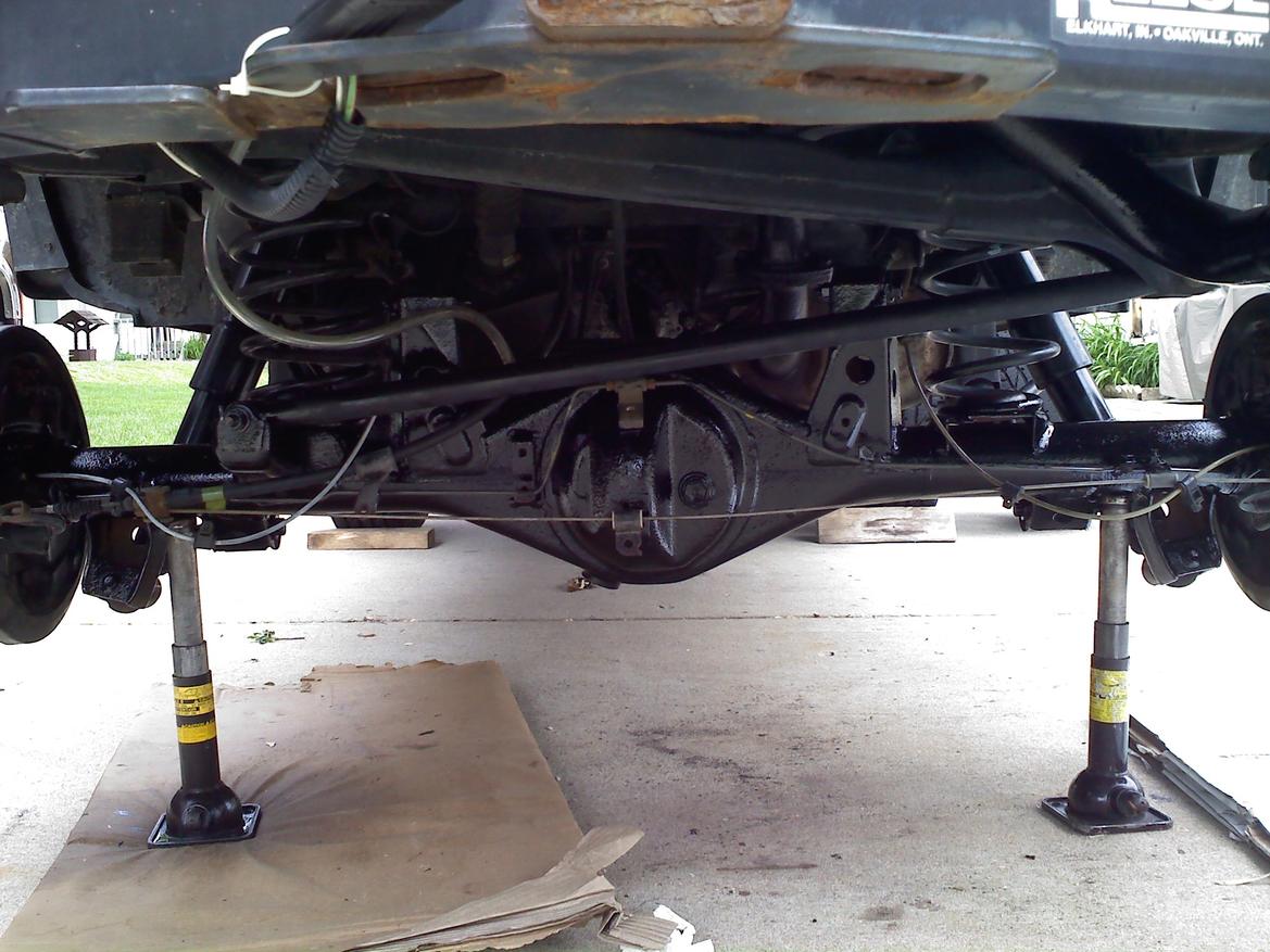

A few pictures of my Runner
Nice job on the rust conversion man!
Thanks fightman. I plan on making it an extended summer project. Im gonna get every bit of rust sanded, converted, and covered up so it looks like a new chassis. We'll see how it holds up this winter . . .
Im also thinking this coming winter I might do something similar to what you do. Cover the areas prone to rust with some sort of an oil film
Heres the axel now after two top coats of rust oleum gloss black protective enamel.
I also did the rear drums.
And then the tail pipe.

And a little update on some work Ive been doing on "Jitters". I've now refinished my rear axel, drum brakes, rear sway bar, tow hitch, some other random spots, and one side of the front end suspension components in Rust Oleum gloss black protective enamel. I plan on doing basically the entire undercarriage. My rust isnt that bad, which is exactly why Im doing this now. Its a tedious process as there are so many steps. Clean, then sand and wire brush, then clean again, apply two layers of rust converter/primer, followed by three layers of protective enamel, which has to be applied 24 hours apart. So Im taking my time and trying to do a good job. More pictures when I get a bit further.

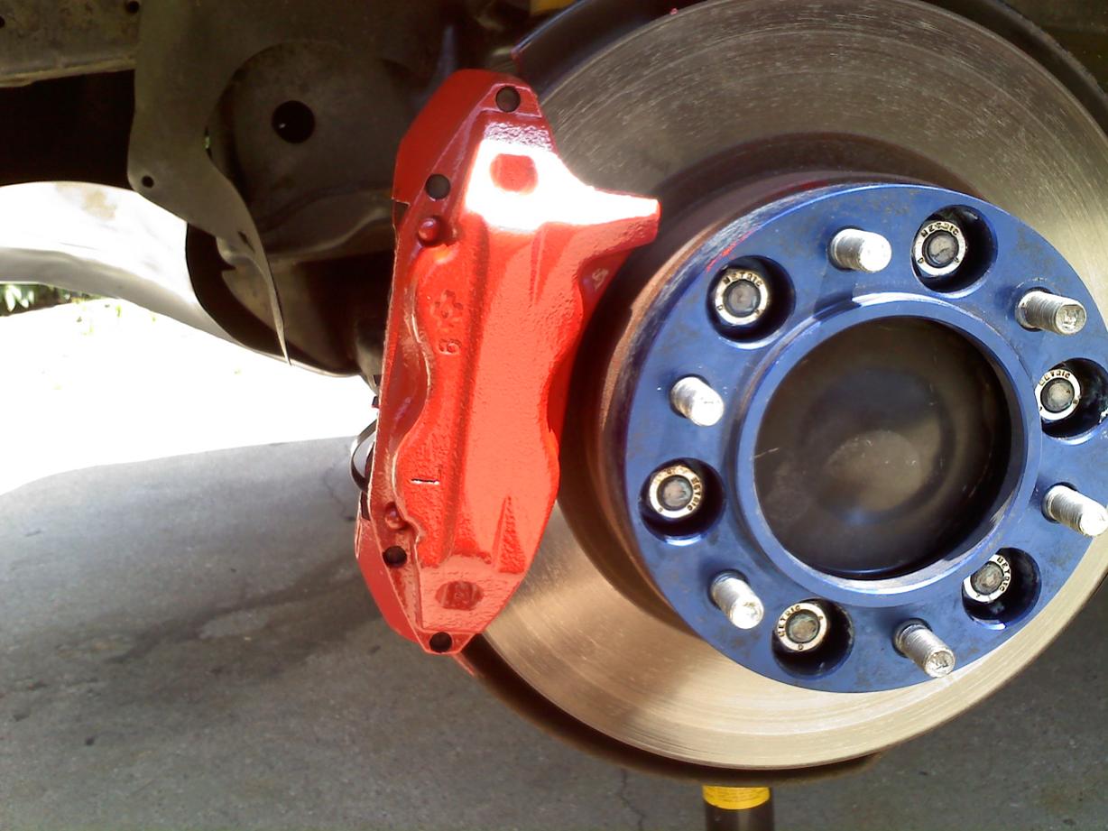

Well, red seems to be the popular color for our calipers. I also considered black to match the undercoating Im doing, or silver to match my skid plate. I figured while Im coating all the front end components I might as well make the calipers look sweet. At this point my 4runner is almost completely absent of rust

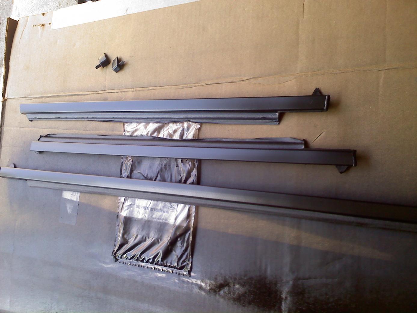

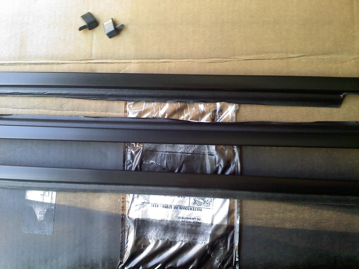

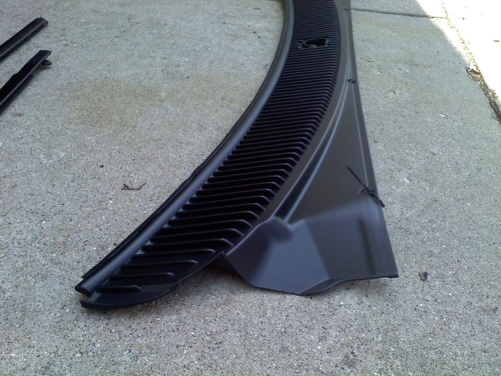

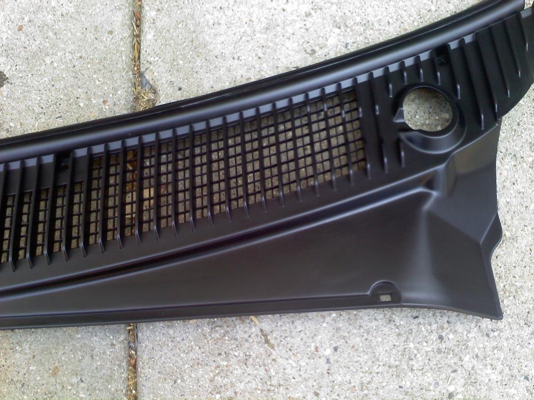

I saw COB do this a while back and thought it was a great idea. Painted my faded window trim for all 5 windows along with the front widow cowel, using Dupli Color Trim paint. Im really not a fan of Dupli Color products. From my experience they arent nearly as durable nor do they apply as smoothly as Rust Oleum products. However . . . I do like this trim paint for these applications.
No before pictures. The trim pieces were weather just like they all are after time, with shades of blush-grey showing through. Now they look brand new again!
