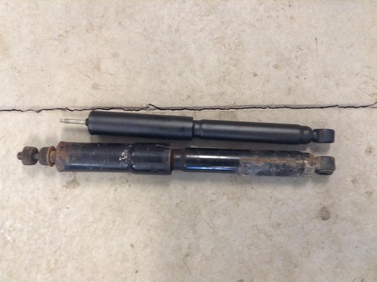

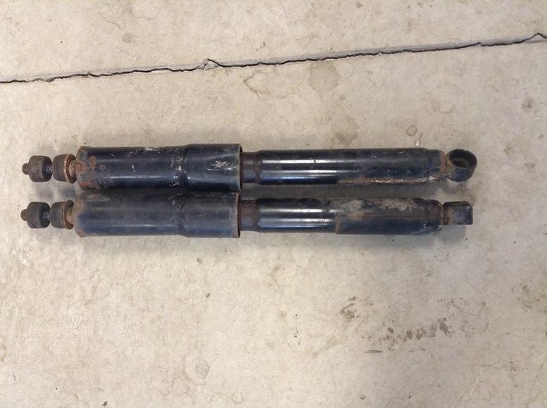

Yesterday I replaced my FJ80 Tokicos with OEM 3rd gen Tokicos. The ride with the LC shocks was just too stiff for my truck at stock weight, and they were overkill considering Im only lifted 1" in the back.
So, I'll probably post these in the classifieds shortly, if anyone is interested. They have around 40k EASY miles on them. 60/40 highway/city miles, at stock weight, with very little towing and hauling. As far as off road use, literally just logging road type trails. Nothing that could even be considered true "off-road". The rust is just surface, and I tore up the upper protective sleeve a bit getting them off yeasterday. But, functionally they are perfect. So if anyone is interested before I get them in the classifieds.
Next to stock 3rd gen Tokicos
