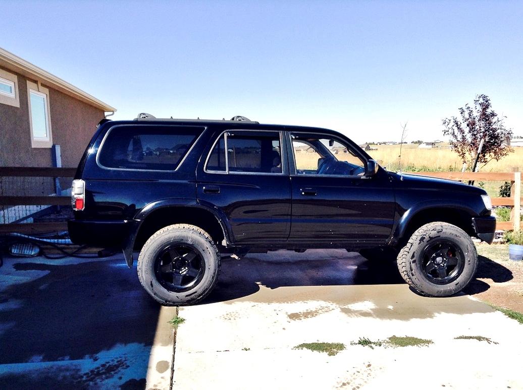

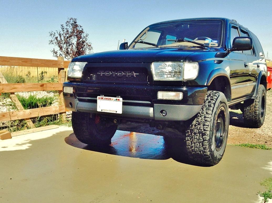

A few pictures of my Runner
Huh, thats crazy. So someone pulled a picture of my truck from the forum or google and tried running a scam with it, Im guessing? I wonder why they would use that picture though. Its not even a good picture of a 3rd gen :shrug:
If they had posted a picture of your build as it stands at $4k with supposedly 130k miles I would have immediately dismissed it as a scam. I guess they wanted it to be somewhat believable? Not sure, really weird though

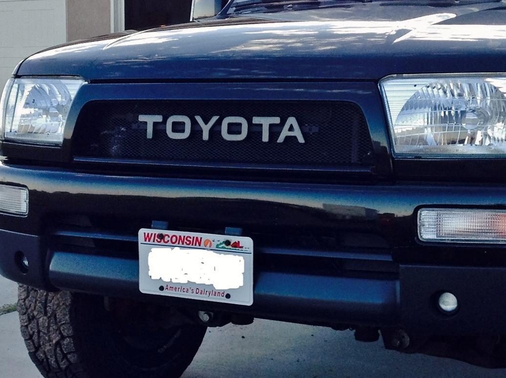

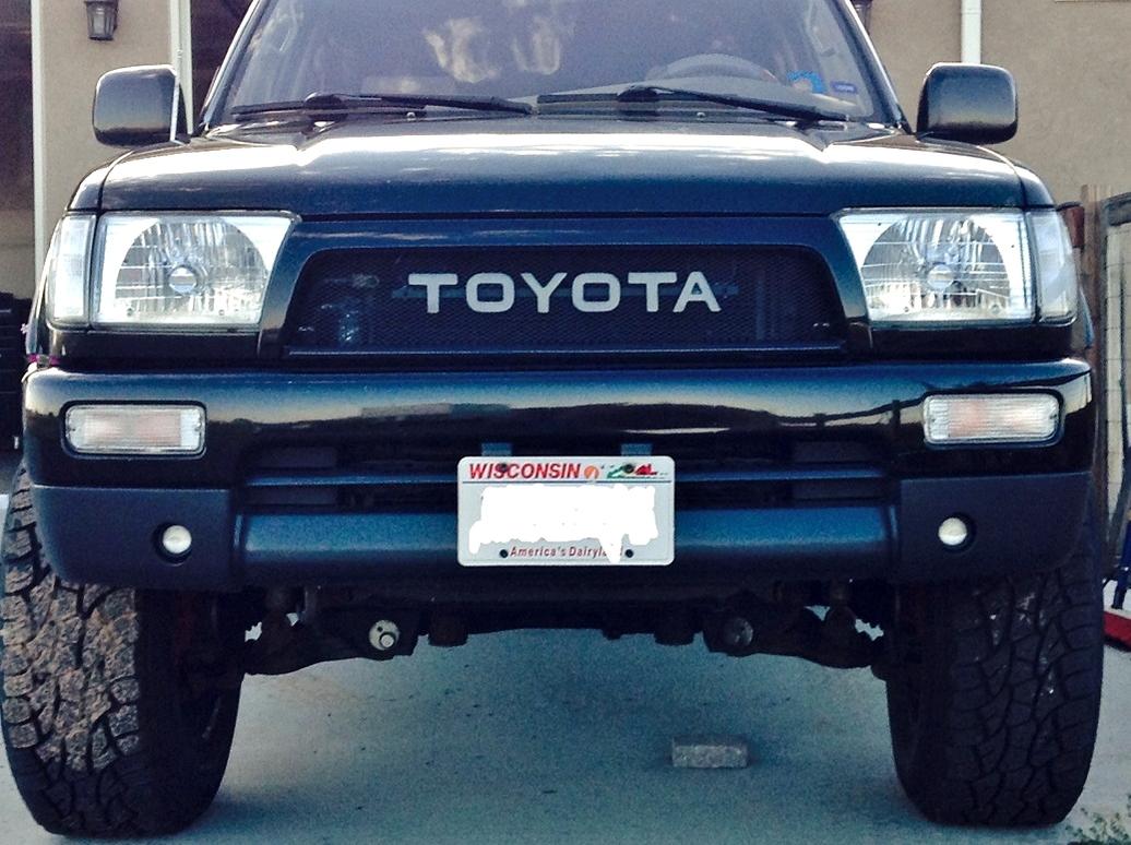

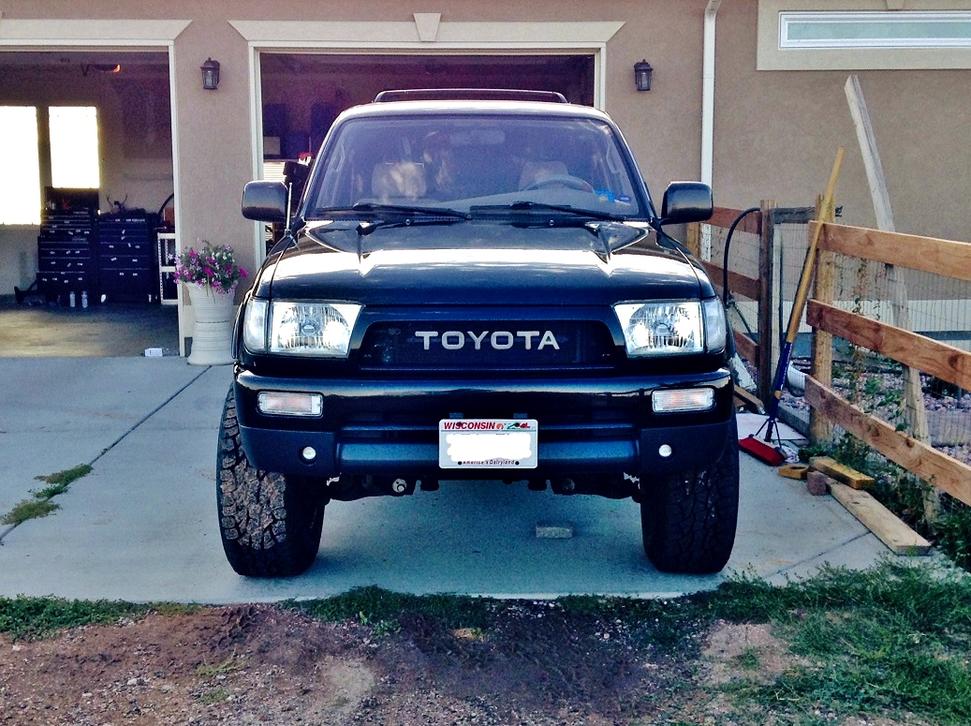

Hasn't been too much going on with Jitters lately as I recently became very sick, lost my job after three months on short term disability, and am now staying with family in Wyoming still seeking a diagnosis for my illness. The best guess right now is that I have chronic Lyme disease, though tests have been indeterminate.
Anyways, the few things I have done lately . . .
- Repainted my satoshi grill and panels beneath the headlights oem black. Got them nice and glossy after 3000 grit sanding and then buffing though you cant see it in the pictures
- Changed the TOYOTA emblem from flat black to platinum metallic for some contrast
- Repainted the rear spoiler oem black
- Painted the silver lip on my wheels color matched flat black
- Replaced my worn out cat with an eastern direct fit converter
- Replaced the downstream O2 sensor
- Installed new EBC performance brake rotors and pads
I don't know why, but I can never take a good picture with my ipod. The truck is so much more shiny in person! Anyways
Re painted grill and emblem

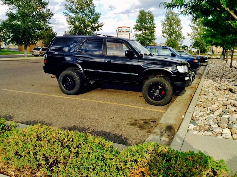

Best looking vehicle in the parking lot

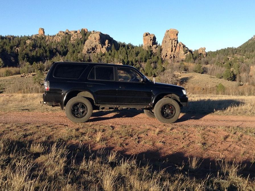

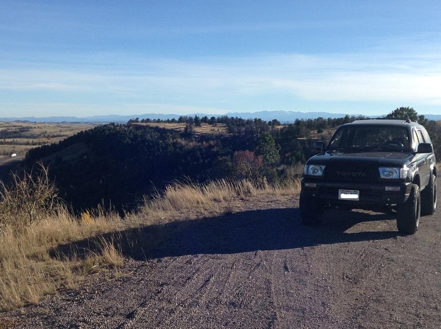

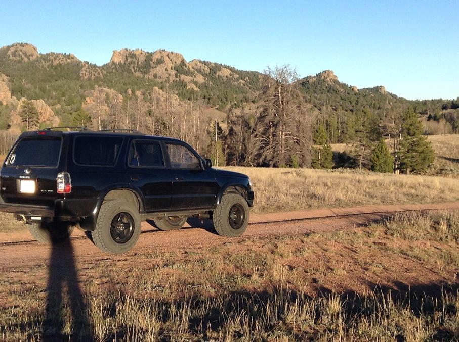

I was feeling well enough to take a drive up to the mountains about 30 minutes from my house in Cheyenne, WY. The area is called Vedawoo State Forest, between Cheyenne and Laramie. There are some outstanding mountain biking trails in this area. Cant tell from my pictures, but some of the peaks are above 8500 ft. Definitely smaller mountains for the Rockies.

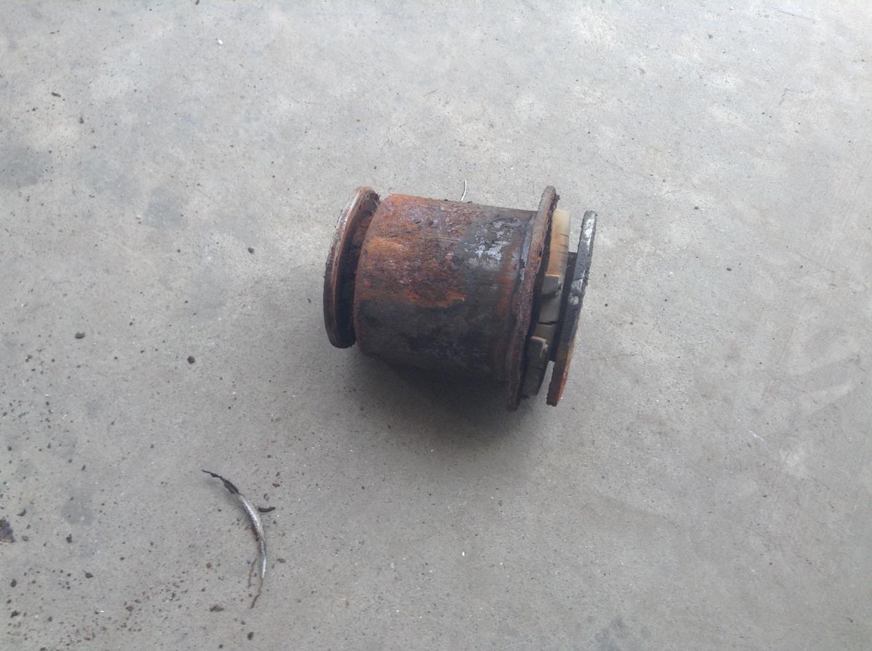

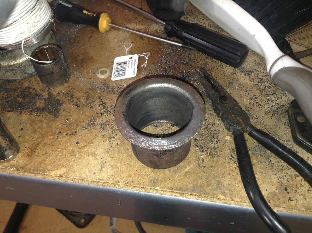

And now for the fun part. And by fun I mean fun like chewing on Styrofoam. Fun like having a piece of metal shaving stuck in your eye. Fun like smashing your finger with a hammer. Fun like stubbing your toes on the corner of a wall. Fun like . . . well, you get it.

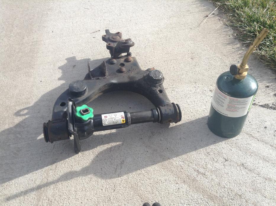

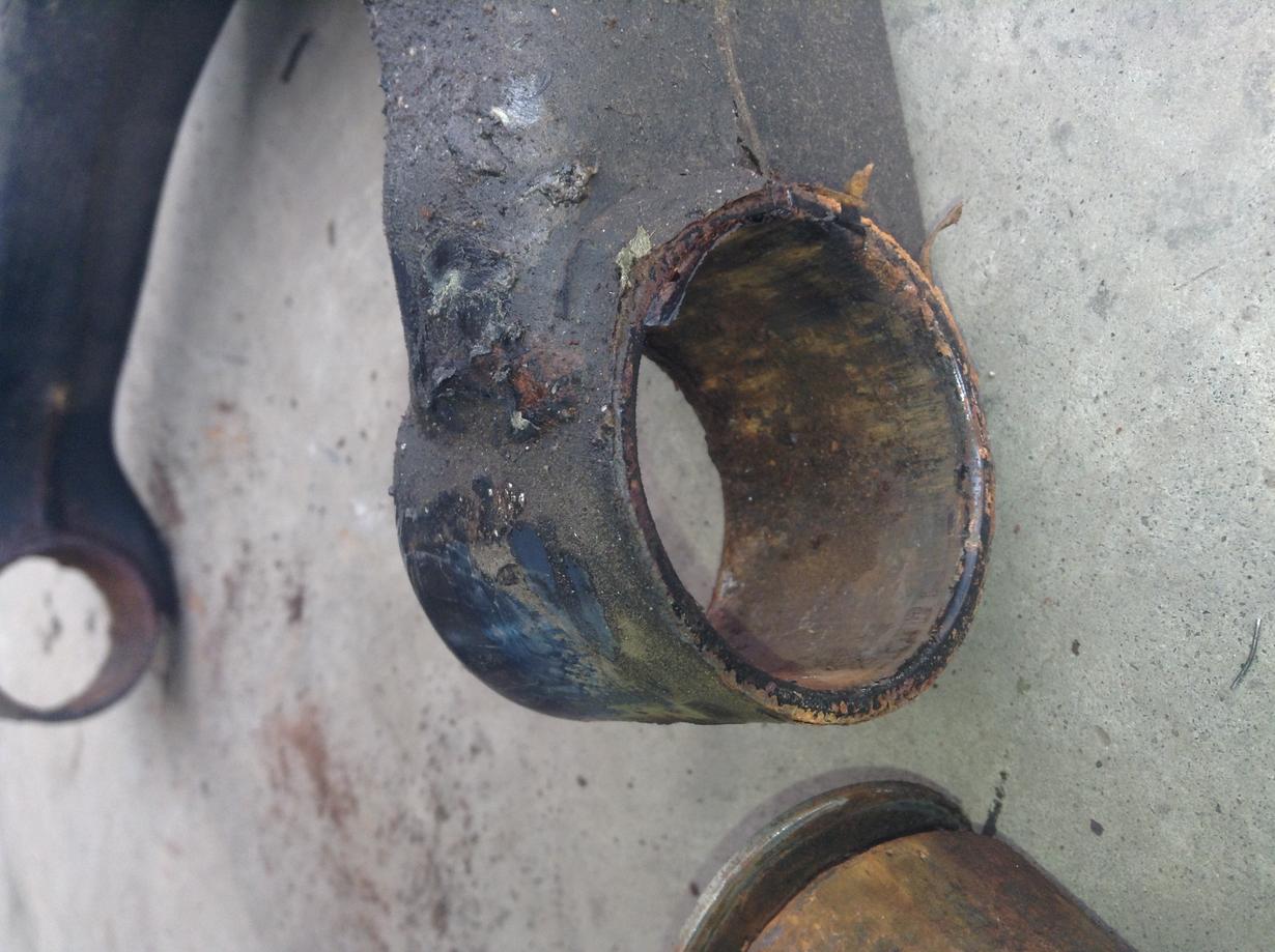

1) Pressing the bushings out of the a arms.
With a press, I'm sure this would have been simple. But I don't have one, so I used the bottle jack method. Position it as shown in picture to press bushing outward. I applied so much pressure on the bushings using the jack that the control arm was literally bending outward, and I still couldn't get them to budge. Until heating with the torch. Because of RUST, the heat was an ABSOLUTE MUST. Once heated I was able to get the bushing to break, and then slowly press out with increased pressure. CAUTION: The pressure from the jack can turn the bushings into projectiles! I had one fly across the garage floor. It was awesome.
Look at that rust. There was a fair amount of pitting on the outer sleeves as you can see. They were definitely seized in the housings. Again, penetrating oil and heat are an absolute must to tackle the rust.

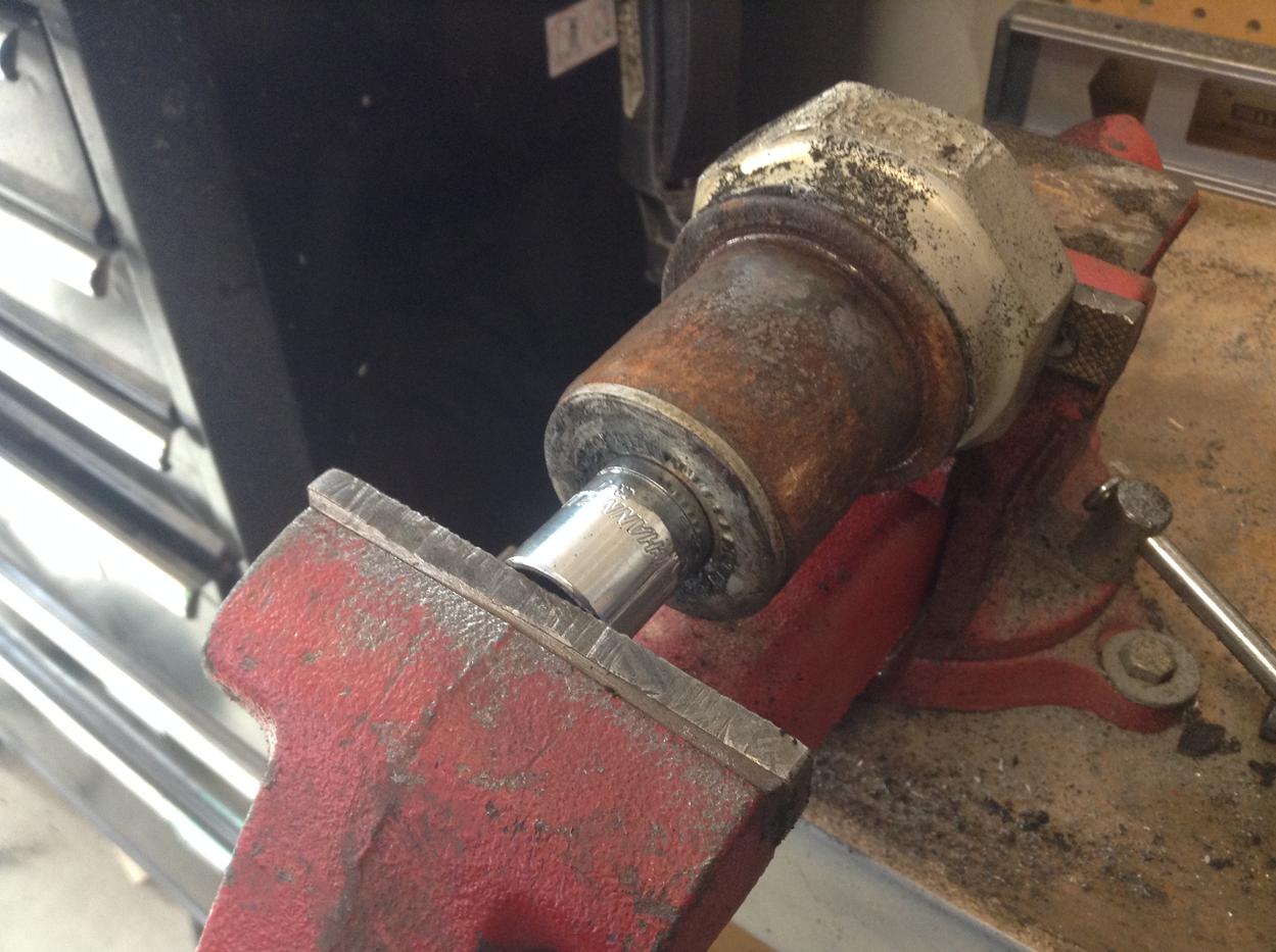

2) Removing the press-fit washers
Only the smaller washer needs to be removed. I was able to use a vice for this, although even with the vice it was difficult. I used a socket that was just the right size to line up with the inner sleeve, and a section of a pipe wide enough to allow the other end to move. The socket (or whatever you use) needs to be the exact diameter of the lip of the inner sleeve, and lined up perfectly when pressing. Once lined up in the vice, I had to use a cheater bar to turn the vice handle, as getting them to break required a lot of pressure. The washers actually bent inward from the pressure, so I formed them back to shape after removing. With a TON of pressure they eventually popped off. It was a tedious process.
3) Pressing out the inner sleeve/rubber
(I forgot to take a picture of this part, sorry.)
Basically, the bushing sits in the vice just like it is in the last picture, with a socket on the front, and the pipe in the back. For this step, once again, HEAT WAS A MUST. I had so much pressure on the bushing that the vice looked like it was going to break. But once I heated the perimeter of outer sleeve, the rubber broke and the bushing began to move. After getting it about 2/3 out, while the rubber was still hot, I was able to pull the bushing out with a large pair of pliers. It will look like this, with most of the rubber attached to the inner sleeve, and some still stuck in the outer sleeve.

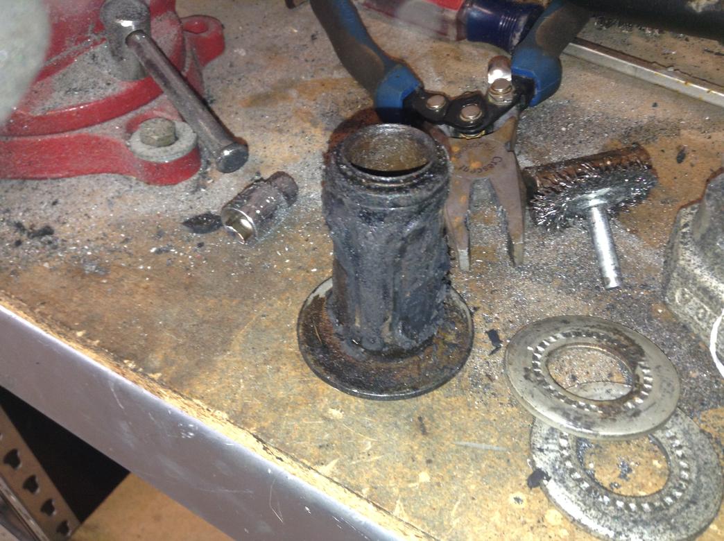

4) Removing the old rubber
This was by far my least favorite part. It messy, and took a while. I would recommend doing this outside using a half face paint mask, as the fumes are really bad. But heating the rubber is absolutely necessary to remove it. My process went - 1) heat the rubber till it start on fire, 2) cut sections off with a knife, 3) heat another section of the rubber and repeat. Once the bulk of the rubber was off, I used a razor blade to scrape the sleeves clean.

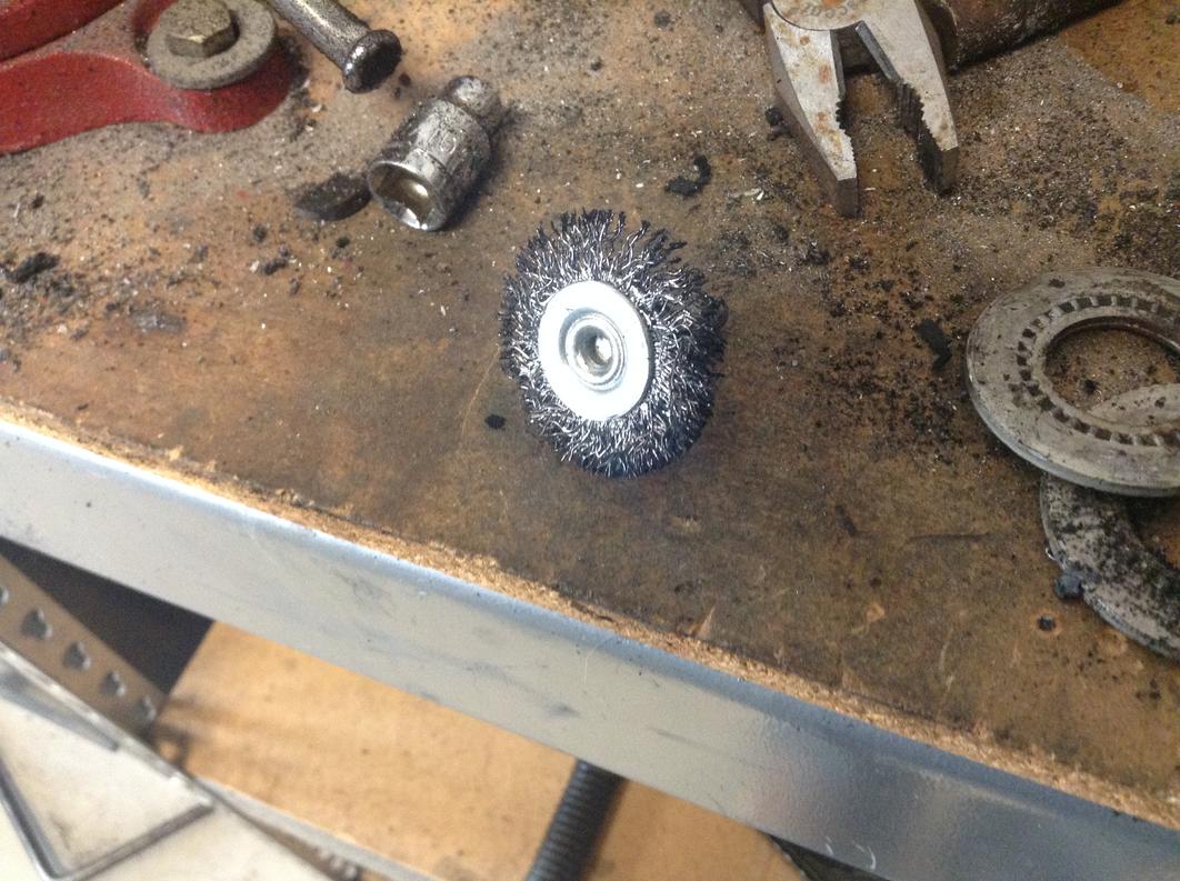

Because a flat razor wont fit in the concave outer sleeve to clean out the rubber, I used this guy on a high speed drill.
Rubber cleaned out of the outer bushing using the wire brush
5) Re-assembling with the new bushings
This step is easy. I used my wire wheel pictured above to clean the inner and outer sleeves really well. Then just applied grease on both the metal surfaces and bushing and pressed it all together. I pressed the bushing into the outer sleeve first, and then pressed the inner sleeve into the bushing.
6) Pressing the press-fit washers back on the inner sleeve
This step is a little tricky. Because of how much pressure I had to apply to the lip of the inner sleeve to press the washers off initially, they were a bit marred up and even a little bent in a few spote. So I knew lining up the washers to press back on would be an issue, as the tolerance is very tight and lining them up is difficult. If the washer is not perfectly lined up, when pressure is applied the the lip will be bent or damaged (which I did when pressing them out), and then the washer wont seat properly. So i used a file on the lip to get rid of any burrs, and sharpen the lip slightly to make it easier to line up and accept the washer.
I lined it up in the vice, and then used a combination of pressing and hammering lightly until the washer popped on.
7) Pressing the bushings back into the control arm
This step should have been easy, but once again RUST complicated the process, at least on the first bushing. To start make sure to press the bushings in correctly (the small washer that you just pressed on goes inward for both ends). It took me 45 minutes of torquing the vice, heating, pounding, and repeating over and over again to get the first bushing back in. So after that, I took my file to the surface of the outer sleeves to knock down any high spots, and then cleaned them up with the wire brush. This made the other three bushings much much easier to press in.
