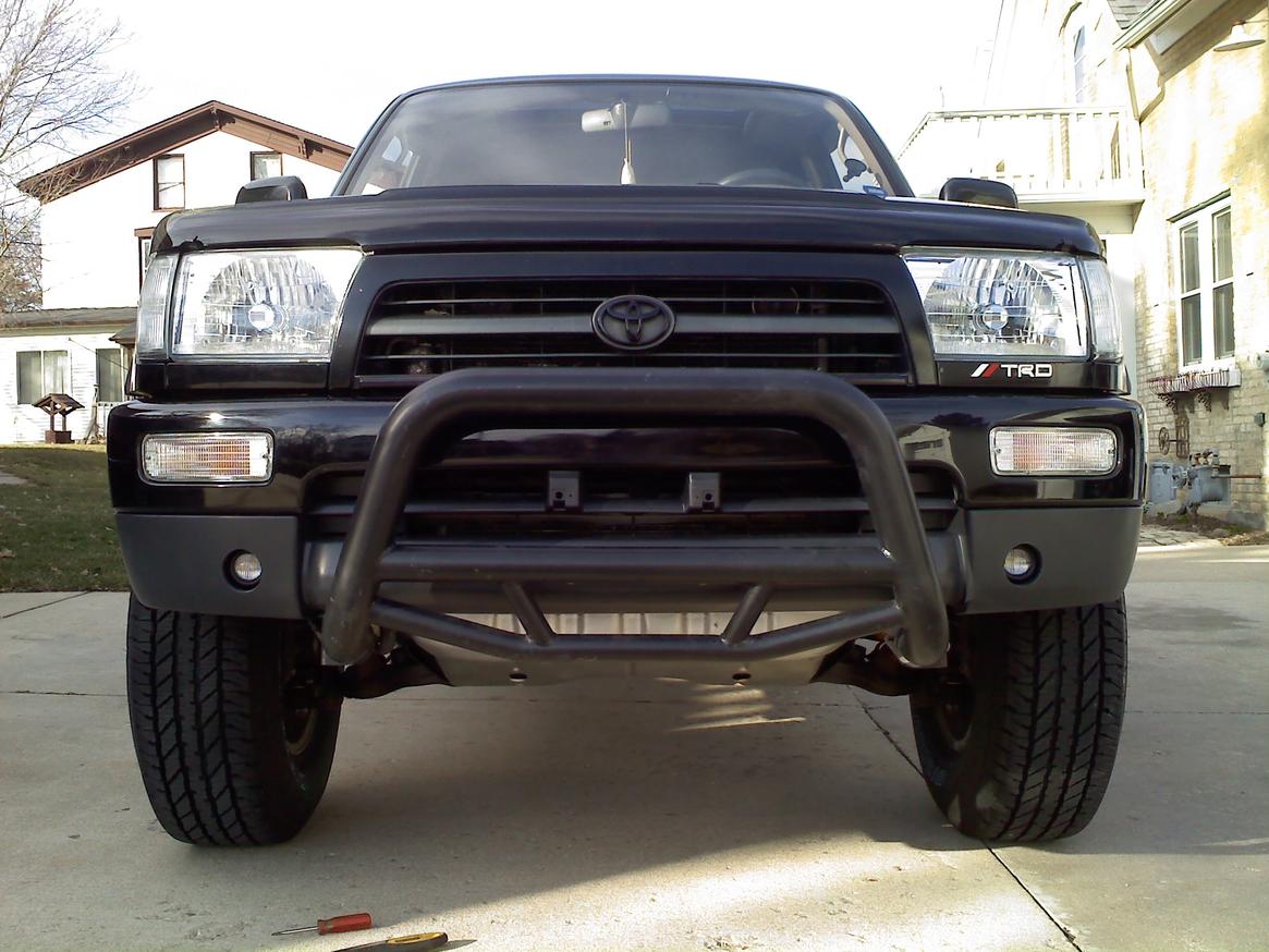

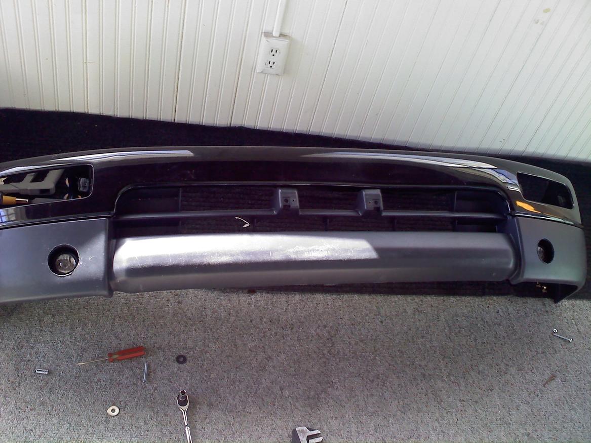

Stock bumper before any modification

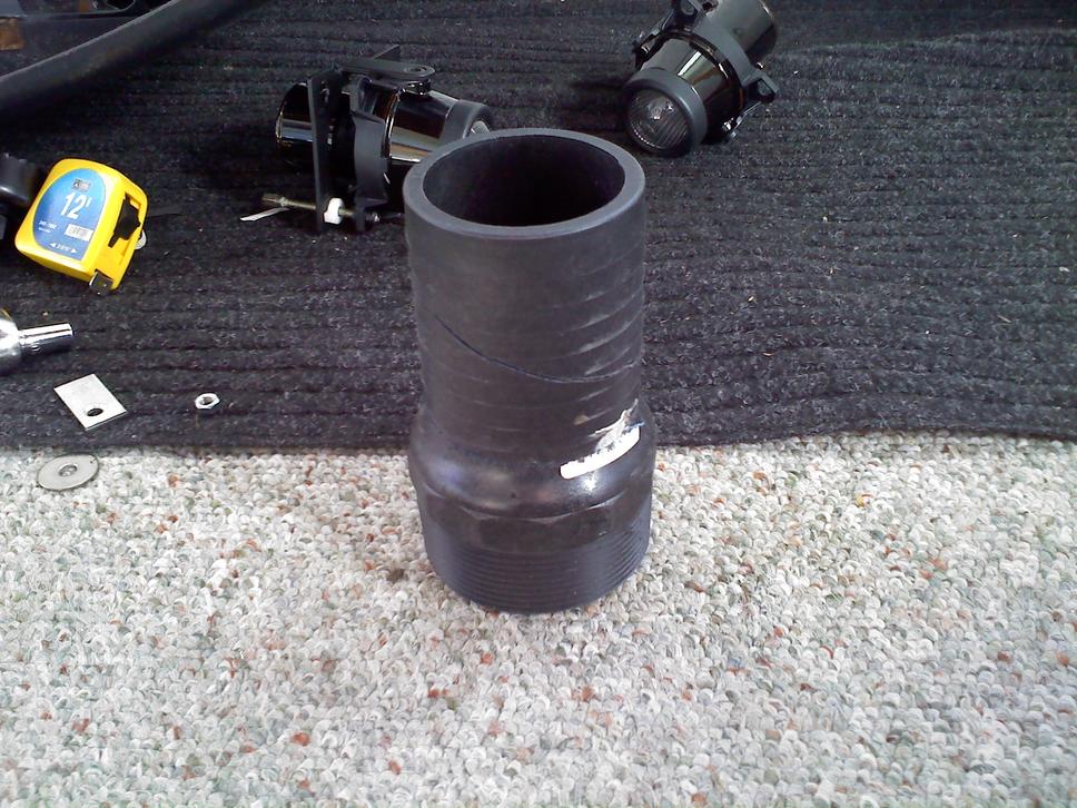

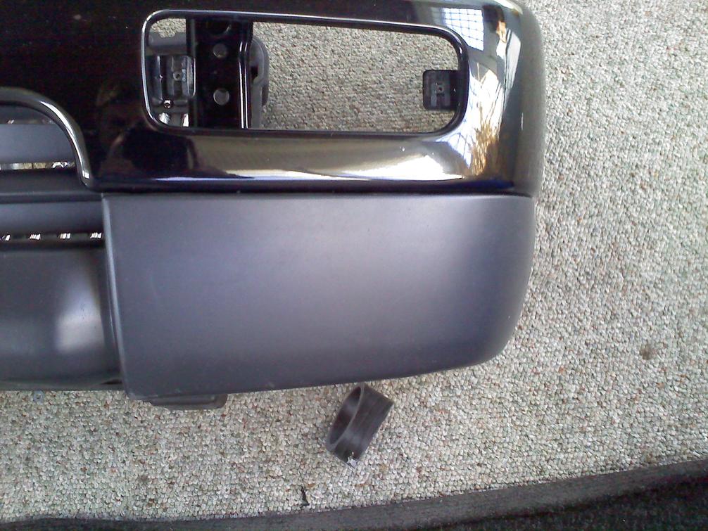

Here is the plastic tubing I used. Its not technically PVC pipe. I found it in a completely different section of the hardware store. PVC comes in whole inch sizes. This piece has an inside diameter of 2.5" to match the holes. As you can see in the photo I had already cut it. I cut off the wider portion on the end, and then cut the rest in half at an angle. Youll see why the ange is needed in the next photo

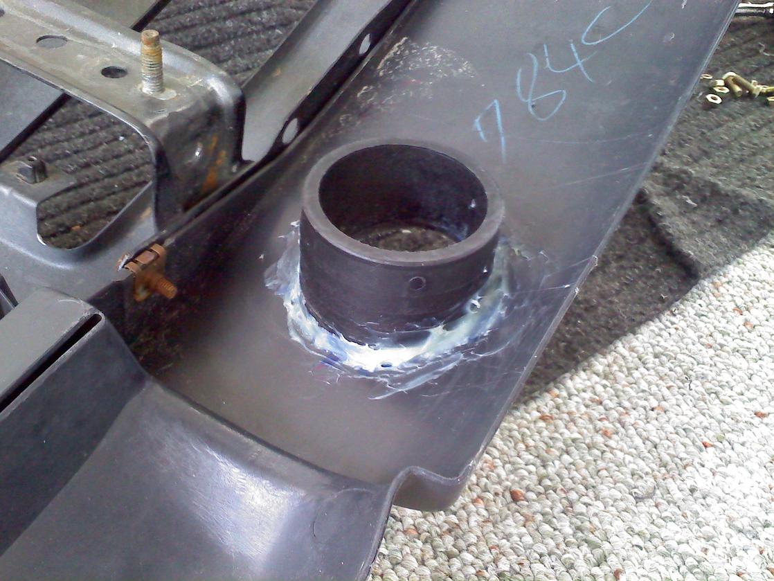

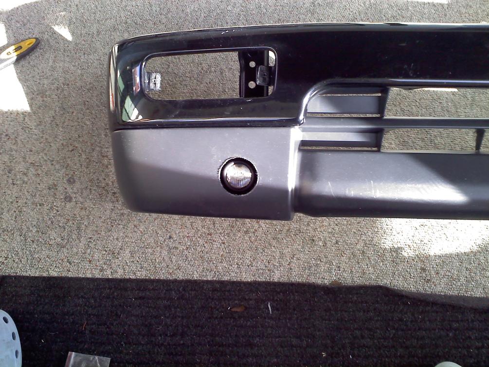

Hole drilled using a 2.5" hole saw bit. This was after a lot of time doing very precise measurements. PVC is already on in this picture. I forgot to take any pictures of just the hole. There you can see the angle. I made the initial cut as close as possible using a hack say which is all I had, and then fine fitted it with a file and sand paper. Alot of back and forth - sanding and then test fitting. It would have been so nice to have power tools for this! I used a plastic two part bonding agent to connect it to the valance. It looks sloppy, but is very strong

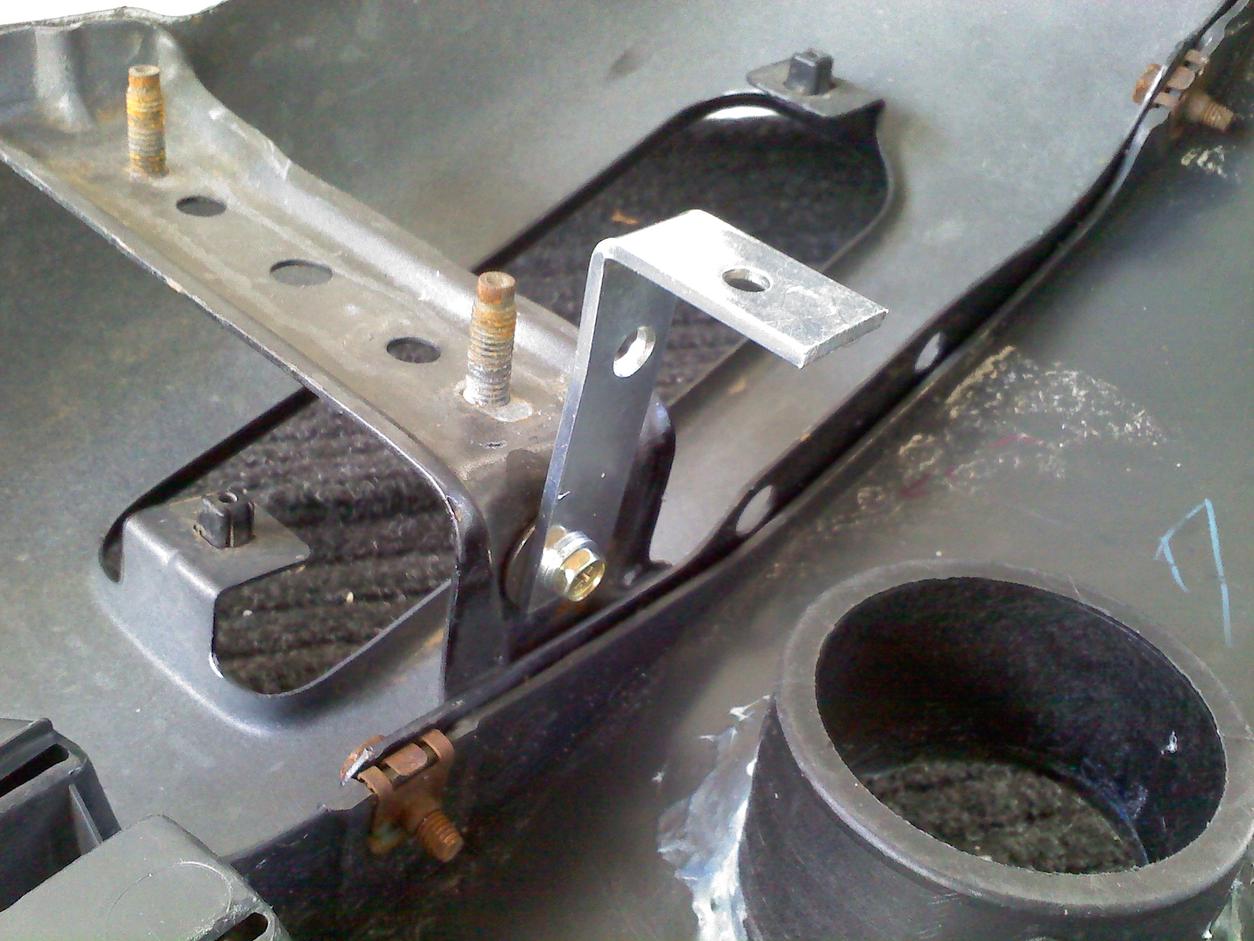

Custom bracket in place. I just used a very simple L angle that I found at Ace. Had to make one cut to make it fit, and then bend it to the perfect postion. Its a pretty thick and sturdy piece of metal

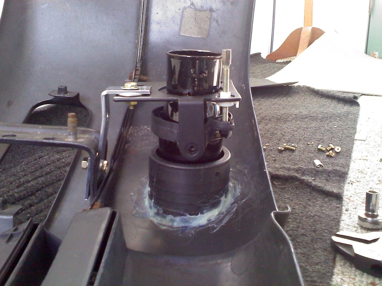

And here is the fog light in place. At this point I should backtrack a bit. To get the proper location for drilling the 2.5" hole, I first mounted the fog light, and then finished the PVC piece. This allowed me to see roughly where the hole would need to be located to be centered with the light. I positioned the PVC in place so that there was an equal gap between the light and the PVC housing at every point around the circumfrence, and made my marks for the cut-out.

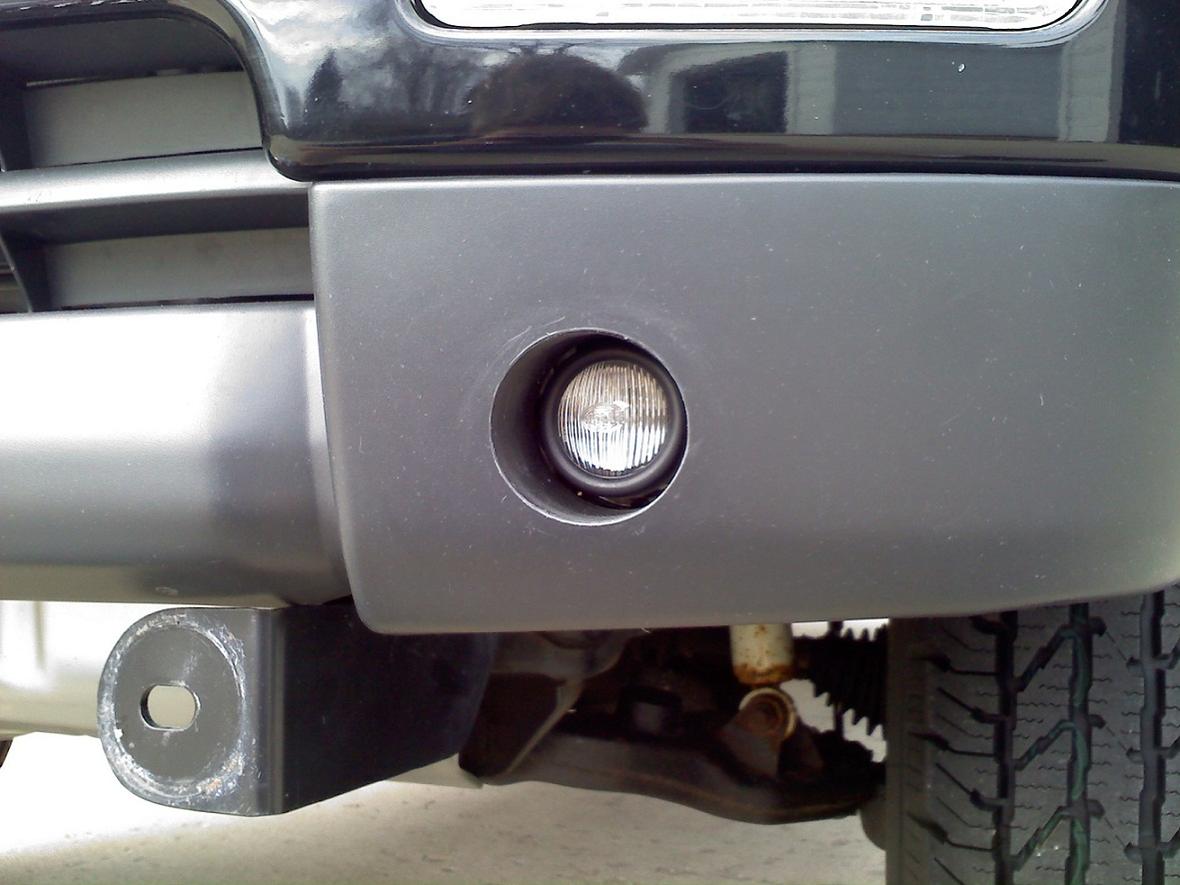

Front view with light in place
Finished product
As you can see I still need to clean it up a bit. I plan on sanding it with a rough grit, and then going to something very fine. Id like to find some sort of gasket or cover to put on the front edge to make it look really professional.

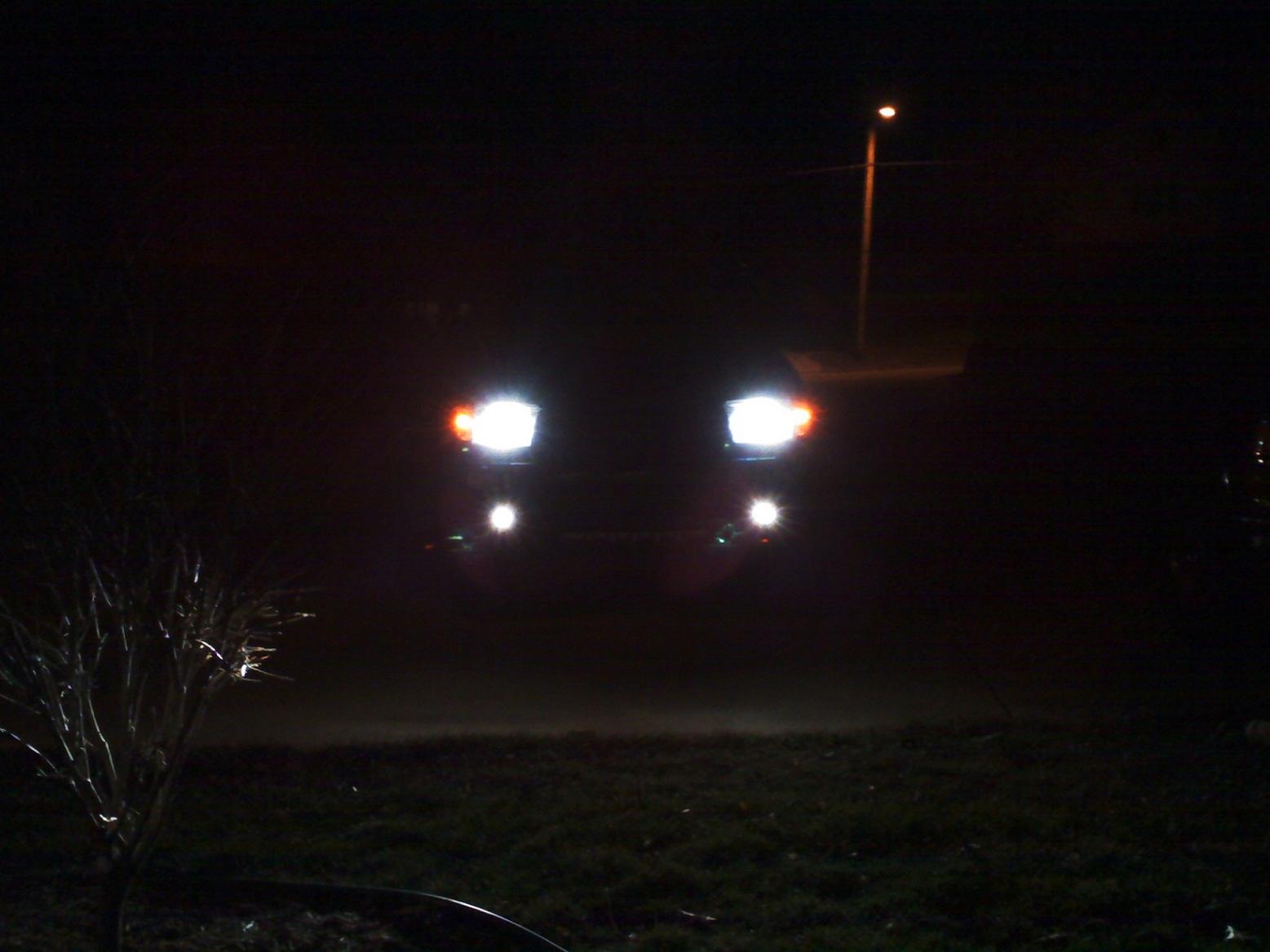

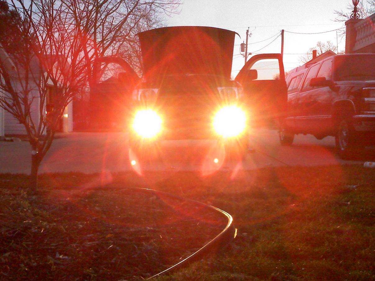

Just finished wiring the fog lights a while back. Wow, am I impressed with the output. Its like having a second set of headlights. Extreamly good light pattern and very adjustable the way I mounted them. This is the most intensive and custom moddification Ive made to my truck, and by far the most practical and useable thing Ive done. I will use these a lot. For all the 96-98 guys out there I would definately reccommend this. A set of auxilary lights would have been much easier. But I wanted a factory look, and I think these turned out great. Aux lights may come in the future
Fog lights only
The combo

Cleaned up the fog light holes a bit. Id still like to find a cover for them. But im temporarily pretty content with them
Finished product

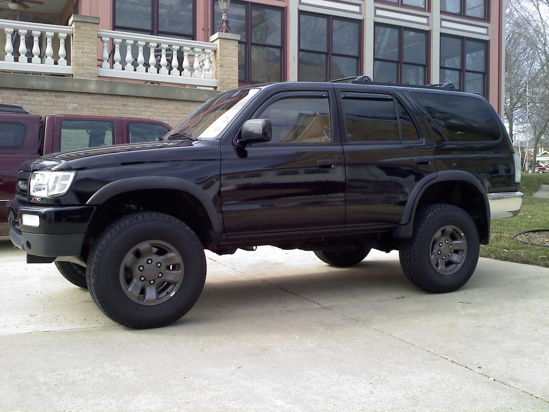

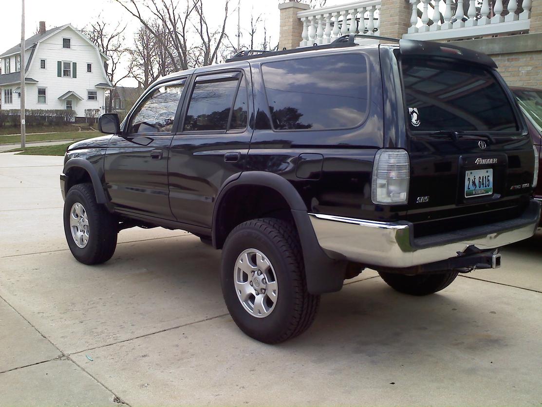

And a few poser shots
This is with over 325 lbs in the back sitting on the LC coils. Im gonna keep the weight back there in hope that they settle over the next few weeks

So I drove around tonight for about 45 minutes on the darkest back country roads I could find to test out my fog lights. Ive never had fog lights before, so its new to me.
I was really impressed. Not exactly as I had expected. I thought that since the Micro DEs are so small with a deep housing that they would emit more of a straight far reaching beam. I was wrong. They emit a huge radius of light that also reaches very far. They reach a huge distance horizontally. They are not as bright as my headlights, but they have such a huge range that they just light up everything. Just a very consistant output of light. I would be perfectly comfortable driving at night with only the fog lights on. This is probably my favorite mod Ive done thus far because its so practical and functionable on a daily basis
