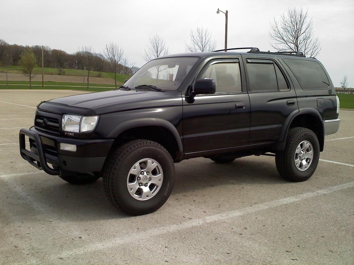

A few pictures of my Runner
New guy here. Good looking rig! I cant believe how much higher it appears with just removing the running boards, your stock pics are the twin to my runner. Keep the pics coming!
Yea, i just bought my 1st runner, a black 2000 sr5 4x4 3 weeks ago with 166k for 3g. I just replaced the t. belt/w.p. and related parts. Now for my 1st upgrade i just bought tundra calibers, pads and brembo rotors. I'm hooked on reading all the 3rd gen build threads for the mods. After seeing your truck with the running boards removed i think thats my next step, thanks for the pics. Nice runner! Sorry, but i had to crop my pic to get it to load.

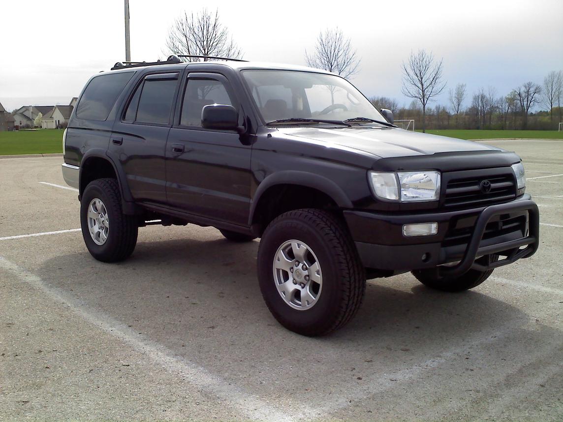

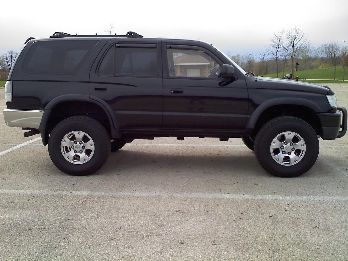

So here is my stance after the new suspension. As the previous page says I got as set of TRD Tundra coils with bilsteins for the front, though they are coded yellow/red and blue/red rather than yellow/yellow and yellow/blue. Theyve been on for 4 days now.
The lc coils have settled a bit as several of you mentioned they would. Though this was after running between 400-600lbs in the back for the past two weeks. And in these pictures there's still 360 lbs in the back. With that gone it would probably raise the back a good 1/2 inch.
I like the rake as it is now, and after driving it for the past few weeks I can say I really like the ride too. The rear feels a bit softer that the front. I still wish the front was a tad softer. But if feels really solid and controlled. Overall a great ride. Its slightly less stif than my previous set up with the pp coils and kyb shocks in the front and rear. Not a huge difference honestly. My conclusion is that the pp coils are actually really nice, and the kyb shocks are great quality, just a bit stiff with no extra weight.

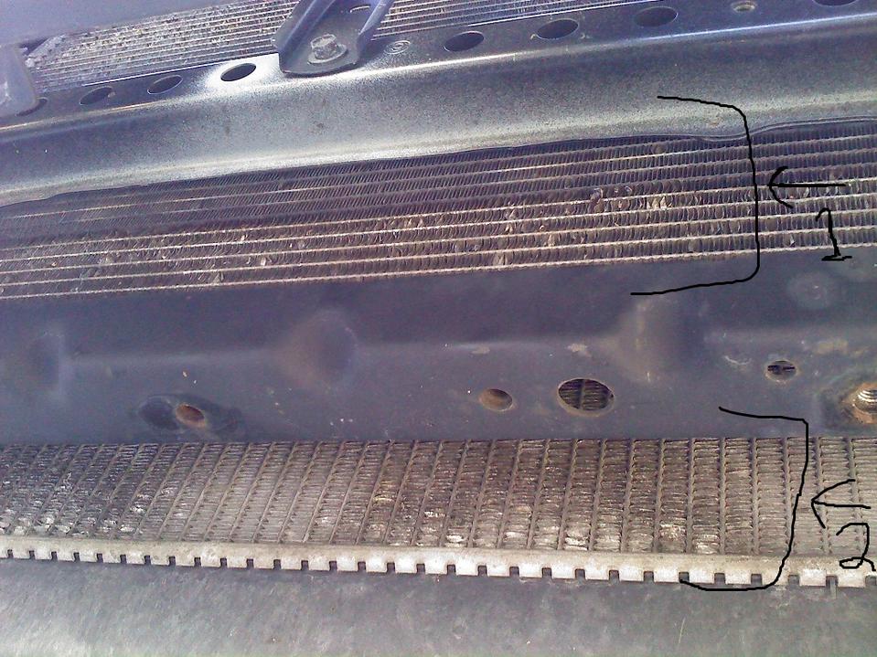

Do I have a tranny cooler installed?
So today I ran seafoam through my pvc valve, and changed my oil. I was gonna install my diff drop but kinda ran out of time. But when I was under the truck looking at things I noticed something I hadnt noticed before.
Take a look at the picture . . .
Sorry about my artwork. You cant really tell from the picture, but my number 1 and 2 are to show that those are two completely seperate units. I didnt look at where all the lines were running, but I know for a fact that the unit on the engine side contains my radiator. Thing is, all of the tranny coolers Ive seen on this site are significantly smaller than the radiator. But the unit labeled 1 in the front is almost the same size as the radiator. Theyre seperated by about a 1.5" gap.
So are both of those just part of my radiator, or do I have a tranny cooler that I never knew about?
Sorry for my ignorance on this. Ill do some research later
