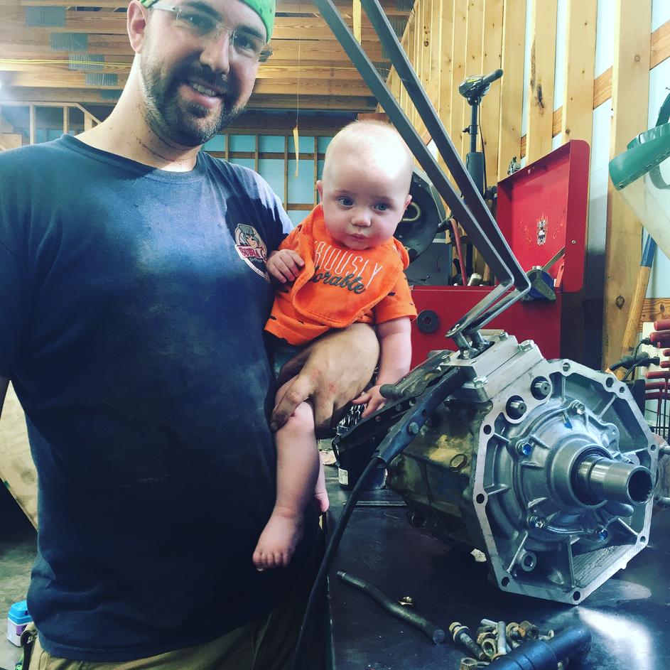

So far the needed materials have been
07+ FJ Tcase or even up to 2015 4runner trail tcase (both the same manual tcase for the auto trans, however FJ case is the on with the worm gear pre2010-2011)
twin stick kit from Front range off road.
upgraded shift retaining spring from wyatt Rocksolidtoys.com
30mm socket to pull the drive flange
12mm socket to split the case
RTV to make a gasket (I dont know that you can purchase a gasket for the tcase)
loose wire
wire connectors
12x12 sheet of 1/8th inch rubber to seal the hole cut in the floor.
rivets/ rivet gun

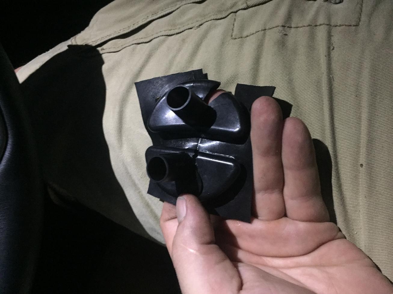

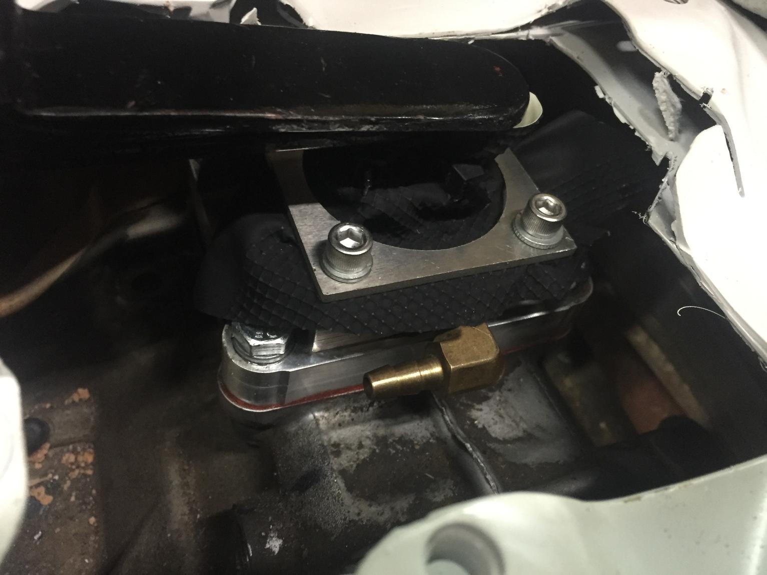

a rubber glove to make the seal at the top of the shifter block where the shifters go into the tcase (the one from front range ripped durring reassembly rubber glove an some zip ties worked like a champ)
an of course gear oil
broken seal:
rubber glove in place :thumb:

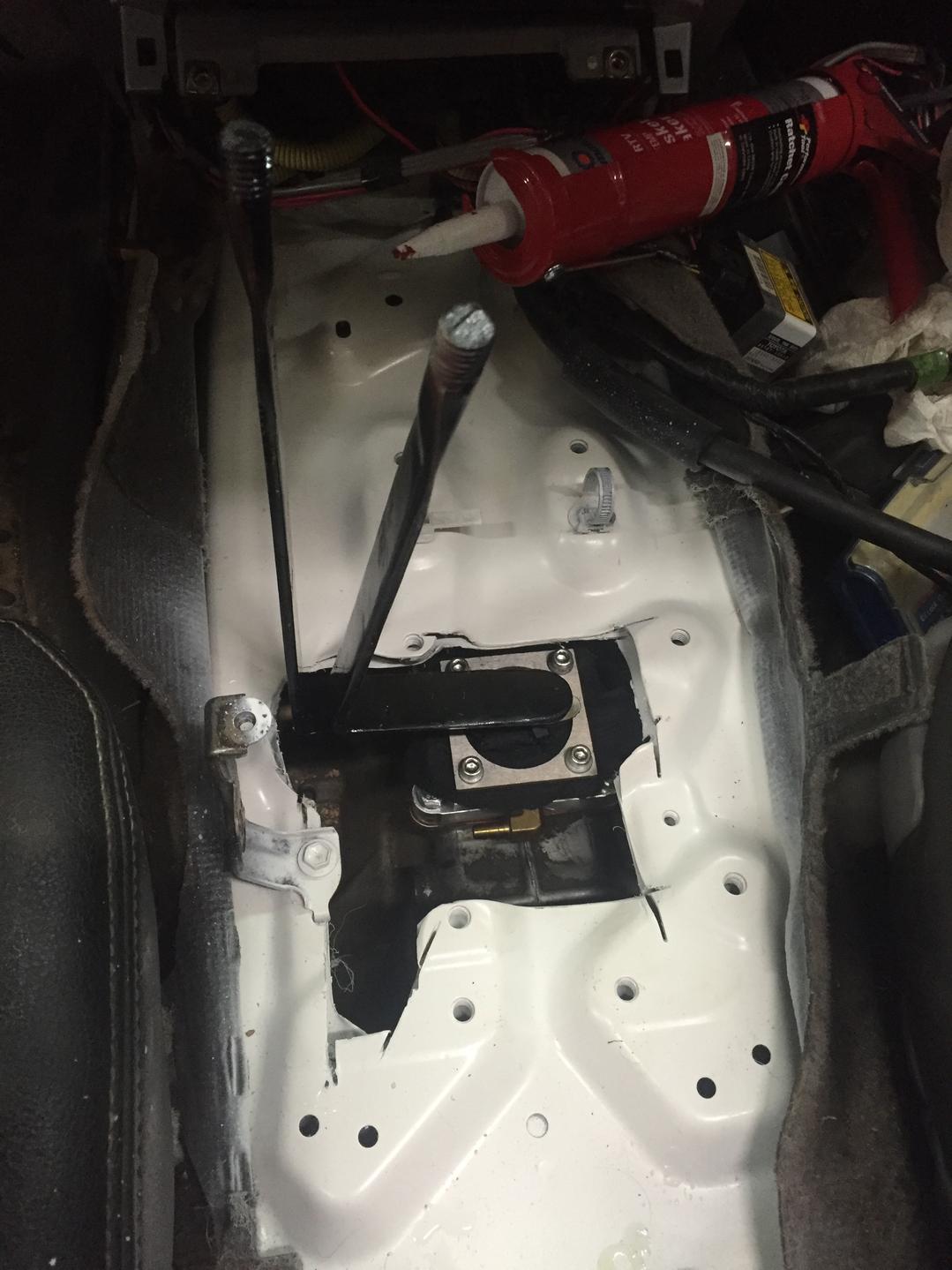

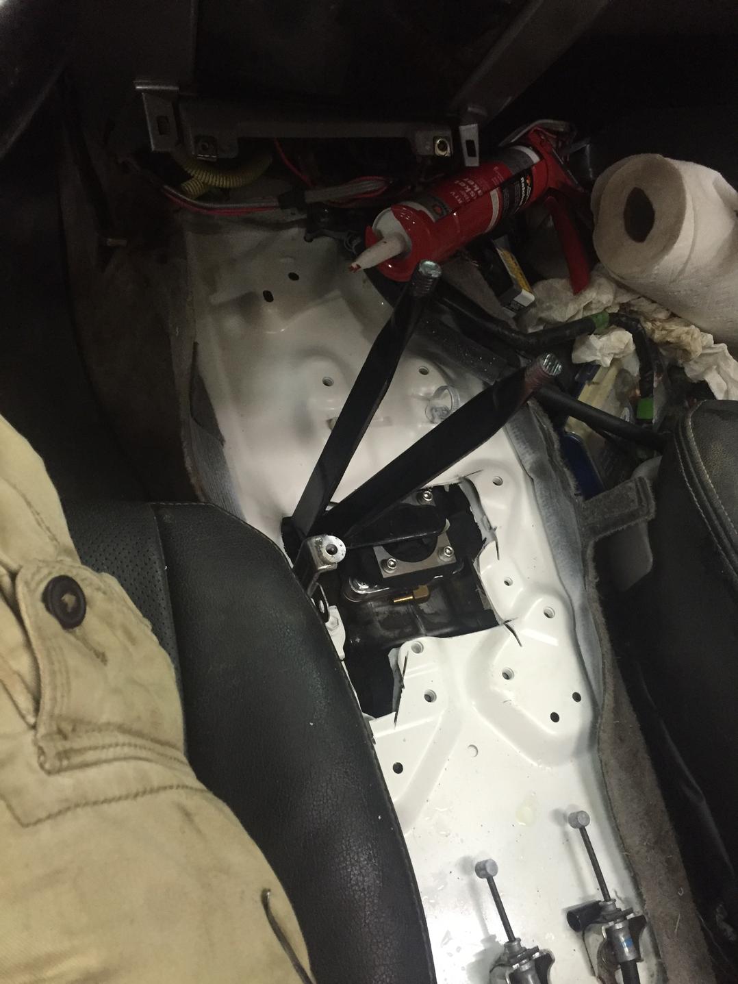

sticks final install,
I'll be posting up the wiring requirments when i get it sorted out and show the thick rubber seal/ shift boot installed as well. Wife works night shift so I've been on daddy duty the past few days. Hoping to get back on this tomorrow or saturday.

The fj shifters on the front range site didn't appear to be offset like yours.
You can bend the round rod that comes on the frontrange shifters to create the offset if you didnt have access to a welder. I wanted the look of the flat bar so I used some 1"x 3/16" steel bar and fabricated them to what you see in the pictures above.

Do you have to lose the park brake?
Nope, it will pass over the rubber seal. Only thing guys are losing is the Air duct that pass through the console to the rear seat vents but I think I have a solution to that. Just haven't worked out the details yet.
