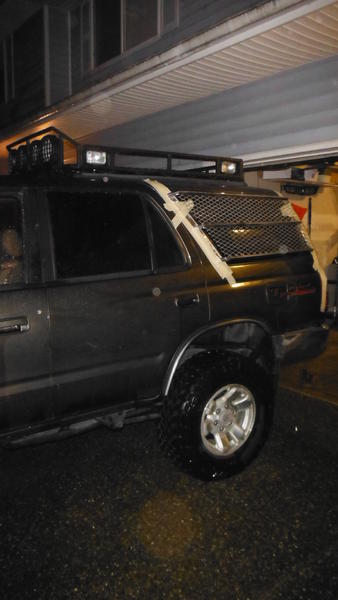

i think if you took and put bars at a slanted angle it would be alittle more useful, while still being able to see out of it, the only reference i can think of is like the 80/early 90s IROCs
I am going to paint them black either way. I plan on using spray on bed liner. I think the mad max look would be a bit much. I really don't think it would get that much attention where I live. Washington state (especially where I live) is well know for offroading and I honestly think that on a regular day good guys and bad guys will just look at it as an offroad mod. As far as **** hits the fan time, anyone that is not running around in panic is going to attract attention. In a vehilce, on foot, or other wise.
I will be attaching it to the C and D pillars using 4 bolts. Here:
Let me know what you think. I will be painting with bed liner since it's easy to touch up if needed.
I'm an avid prepper myself. If I may make one suggestion...
I noticed that the front and back ends of the grill work are unfinished/open. They may catch on trees, shrubs, zombies... what have you. I'd suggest placing a thin sheet of metal over it so that the ends are covered.
Just my .02

Yes, I thought of this also. I am thinking a small piece of sheet metal will give it a more finished look as well.

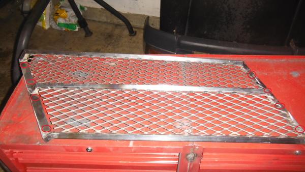

Been thinking about this mod of yours.
Might it be benificial to place the bracing under the mesh? If something were to strike it as is the mesh had nothing to hold it in place. If the mid support bar is behind it, supporting it, then it will not bend inwards. Might also help with the cosmetics.
Once again, just my .02
Not sure if anyone mentioned this but you might consider mounting it on the inside of the window for an extremly clean look.
i could have used that when a tree took out my rear drivers side window on a wheeling trip last year. . . good idea.
I'll be the third. I like to be incognito, especially if this is an SHTF vehicle. You want to look like every other joe-schmo trying to get out of town. A heavily modded vehicle will get you noticed in a hurry.
My 4Runner is my bug-out vehicle as well, although I haven't done much other than install the lift and make sure it is running well. I plan to do sliders, and build front and rear bumpers, but my plan is to make them using the factory bumpers and beef them up on the backside, this making it look like I have nothing modified. Think tube bumper with the stock bumpers as "covers". If I really have to use the bumpers to push someone out of the way, my last concern is worrying about the cosmetics after it is hit.

OH! As for the mod in question. It's an interesting idea... But why those windows, and not the other 6?
The sheet metal is thin as stated above. Even if it does protect your windows, whatever hits the cage will push the thing into your sheet metal. Basically any hard impact on it will damage the body.
That is more expensive and harder to fix than a broken window. It also gives unwanted attention as said before.
I'd like to echo the concern over the strength of the mounting. For the off road protection, your C & D pillars could get extremely tweaked. Any thoughts to extending the support up and possibly using the roof rack as an upper mounting point? I'm thinking partial exo-cage style, keep it away from the body a little to allow for some give when it gets hit.
Really curious to see what you come up with.
i just had an idea, a more incognito way would be to replace the glass with lexan, its more easily scratched than glass but it would withstand impact better a be less obvious
That's exactly what I was thinking. Partial/rear exo with mounting points at the roof rack and back down to either the tow hitch or the frame. He could even make it removable. Sounds like it would be pretty cool to me. If he decides to get a rear bumper he could also integrate it into that. Many possibilities.
I agree as well, You can make it kind of look like a bug out vehicle with this widow cover, but the ultimate bug out vehicle is purely functional, and this isn't really adding any function. It looks like a damage multiplier to me.
In all honesty, a real BOV is probably going to look more like an Expo rig than a rock crawler. You have to be ruthless about what is functionally advantageous in case of a bug out need. Think about it, you are talking about being able to survive in your rig, well, that's what expo rigs are designed for.
Check out Mr Leary's rig, or head over to the expedition portal forum, and model your bug-out vehicle after what you see there. Don't aim for the mad max look.
Exactly ^^^ and yeah, it seems like it could be a damage multiplier especially if you're going through the pillars for support and mounting. I'm not really looking at it as a "BOV", I'm looking at it as protecting those rear windows. And if you are going to protect the rear windows, which is a great idea especially off road, you might as well protect the body panels too. All in all I think it's a great idea, just needs a little tweaking.
Have you considered bullet proof glass lamination you could do a double layer inside and out and then maybe even a second thick lexan panel on the inside.
All the benefits of a stock appearance with maximum protection.
