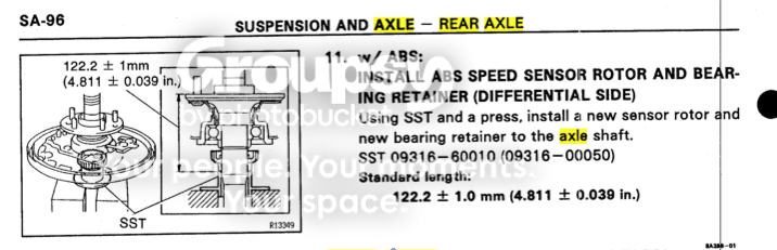

Attached a photo that I gave to the machine shop in case anyone else wants to use it.

Thanks for this pic, going to take my axles to a shop today to get them pressed and will show them this. Hope my grease test shows all is well!

I think measuring from the "polished edge" is not the best idea. That isn't a set dimension from the face of the axle as far as I know - and there could be variances in how much material is polished from the factory, not to mention aftermarket manufacturers. Measuring from here is taking a chance... you might get lucky... you might not.
The Toyota FSM shows where the ring needs to be measured from the face of the axle.
Measuring this way is fine. My meaaurements will vary from yours. That is why I stress using the grease test method. Dont assume my numbers will be the same for you. But you need a point of reference when determining how far to shift the retainer and that place is easier than any other.
I've done this rear axle seal job 4 times now on ABS rearends and I've found 5mm of polished axle showing above the retainer (with the retainer flipped) is pretty much perfect.
The inner retainer from the factory is pressed onto the axle shaft with approximately 5mm of polished axle showing above it. We know the new axle seal design has the lip of the seal now sitting 2mm more inboard. When you flip the orientation of the retainer (bevel facing the tone ring) you gain back that 2mm because you no longer have to first push past that bevel, which happens to be 2mm wide.
So, by simply flipping the retainer orientation, you can keep the retainer in it's original spot on the axle shaft and have the seal lip riding dead center in the middle of the 10mm polished shoulder of the retainer.
The point of reference is given. It’s printed in the FSM, it’s accurate, and it works. No grease test needed. :)

rear%20bearing%20retainer.png~original

By now you should know my method for doing this job (per FSM), which is the way I did it last year and also in 2008. From my post #122 in this thread:
Actually, its 2mm. Per the FSM.

Factory measurement still works --> http://www.toyota-4runner.org/2152324-post29.html
There is more than one way to skin a cat, and ultimately the goal is to get the ring in the correct location and prevent an axle seal leak. And while an axle leak is definitely a PITA, it typically isn't a show stopper.
But my issue here now is that you're encouraging others to "stick their head in the sand" (to use your words) when it comes to the FSM. Service manuals are there for a reason - so you don't have the do the same job 4 times. I strongly encourage people (I'm referring to non-technicians, pro-techs already will) to reference the proper materials any time they're doing a job for the first time, rather than rely solely on "procedures" posted by "forum experts" (that goes for crap I post too, hahahaha).
