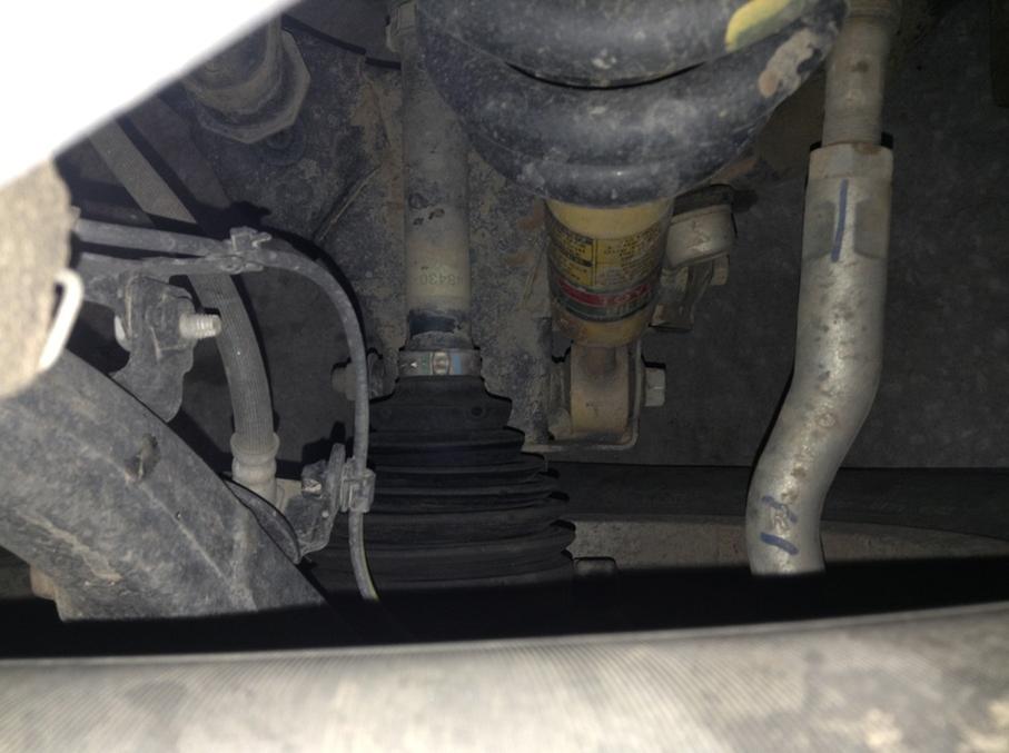

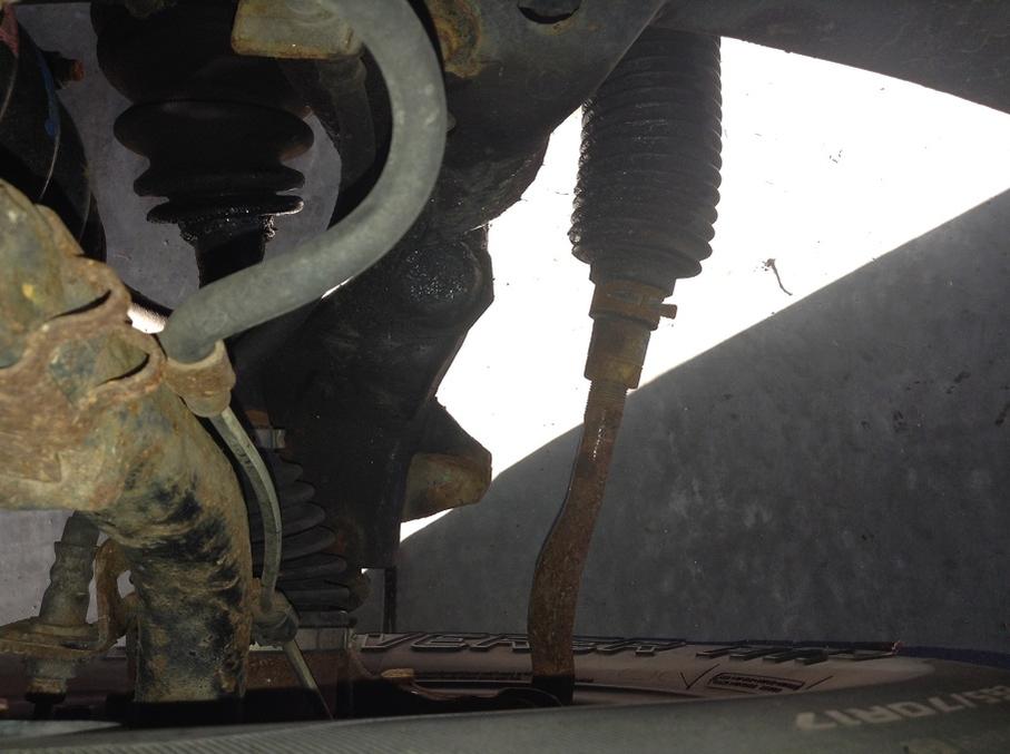

Picture of my 3rd gen, compared with my dads 09 Tundra.
The angle on the Tundra tie rods is less severe than on the 3rd gen as you can see. On the Tundra the tie rod is nearly in line with the steering rack. It makes me wonder if the 3rd gen does have something very close to true ackerman, while the Tundra follows the statement I quoted earlier which said "Modern cars do not use pure Ackermann steering, partly because it ignores important dynamic and compliant effects". And based on this, if I could slightly tweak the design. Again, its all conjecture until I actually apply some numbers to it, which I admit at this point I don't completely know how to do.

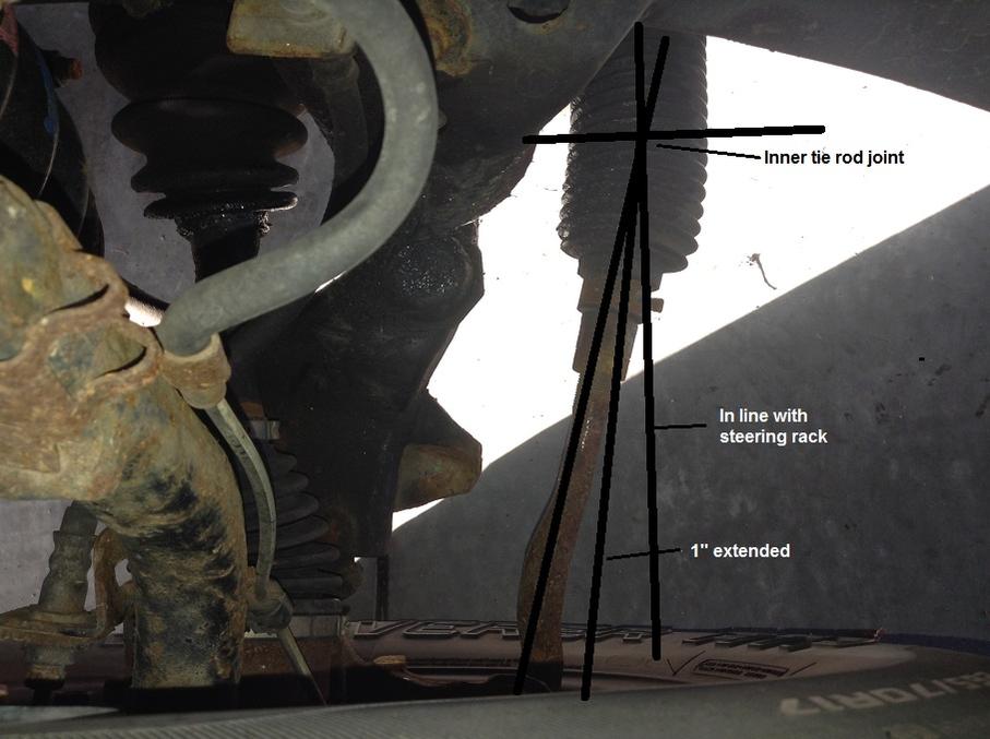

I was thinking something like this.
Pushing the tie rod back around an inch. There would still be a forward angle on the tie rods, which should still produce the ackerman effect to an extent
