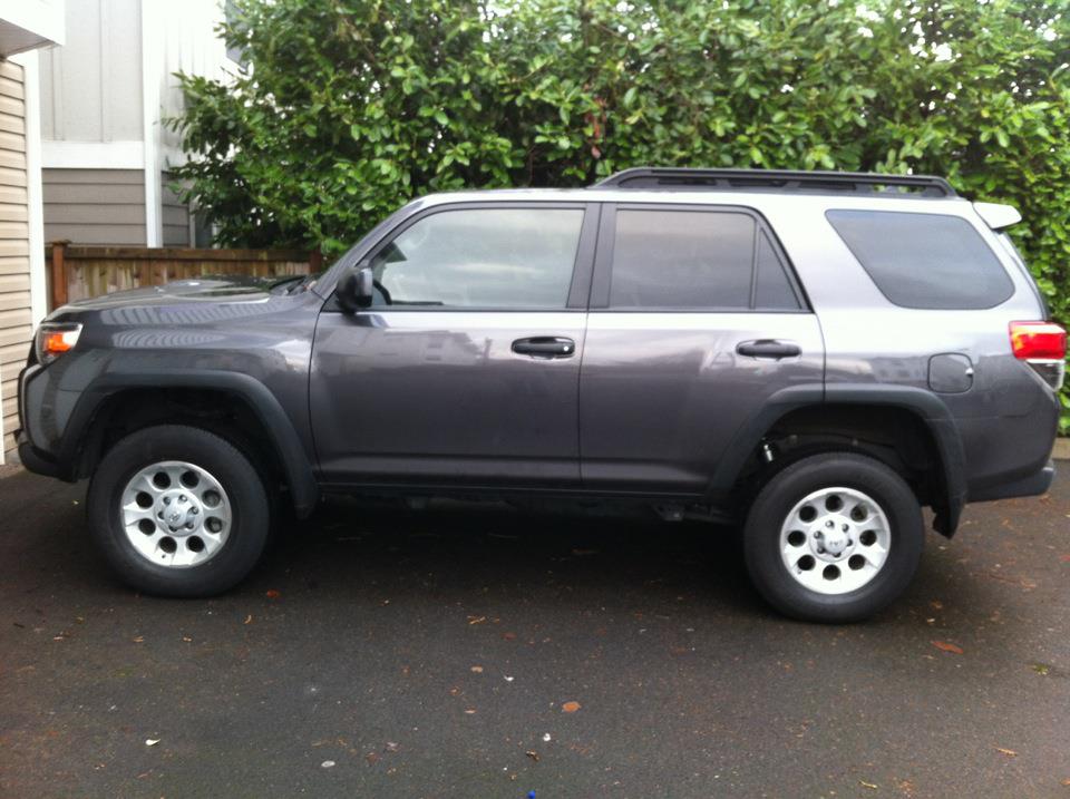

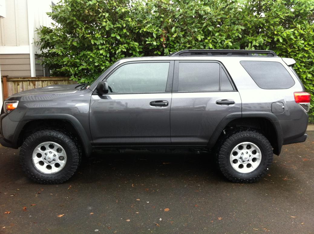

Finally installed my Bilstein Height adjustable front and matching 5100 Rear shocks, Rear 2 inch lift Toytec superflex rear coils. Took it to Firestone and had the alignment c/w. It rides great so far and I got lucky and didn't get crazy dash lights. My front is sitting at 37.5" both sides and my back is at 39.5" both sides. Figured with the front shocks set to 2.5 and the rear 2" rise coils it would be closer to level but I guess not. Install was easy except for the KDSS, which made everything just a tad tougher.
