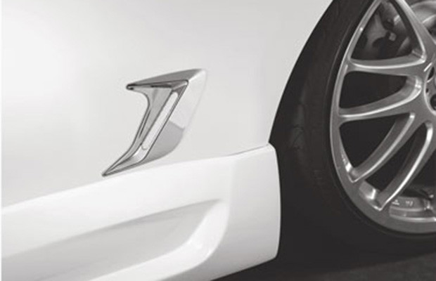

Hopefully those vents on the fenders are staying
Sadly, they were the first thing to go along with the extra 15 hp they added :/

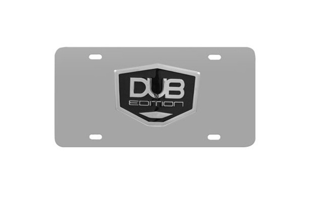

Dude! The Auto Zone's bullshit isle has some very impressive, horse power adding, modifications.
At least add these to your list if you make the mistake of removing fender vents.
Triple plated chrome vehicular enhancement baby! Woo Hoo!!
