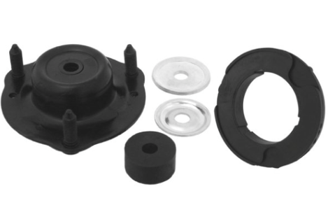

My guess is whoever installed the shocks did not put the bottom retaining washer in and it pushed through. I have a hard time believing it broke the washer on both sides. Unfortunately it probably ruined the strut tops.

Well the shocks and strut tops are shot. I just looked at the pictures again and you can tell that the one with it leaning to one side has eaten away the strut top and more than likely the shaft on the shock. I'd ask if they did the shocks themselves.

either he jumped the truck thinking it was a raptor, or who ever did the install was a complete idiot and didn't install it correctly. I'm thinking the former...
I would say for sure someone didn't put the bottom shock washer in. From the looks of the ride, I don't think it was jumped, the skid dent wouldn't be from a jump. I think the washer was forgotten, and the rubber finally gave way, maybe over a speed bump or something.

I agree, most likely they forgot about the bottom washer but hey, you can maybe have them lower the price and just get a lift kit off with the money you saved.
