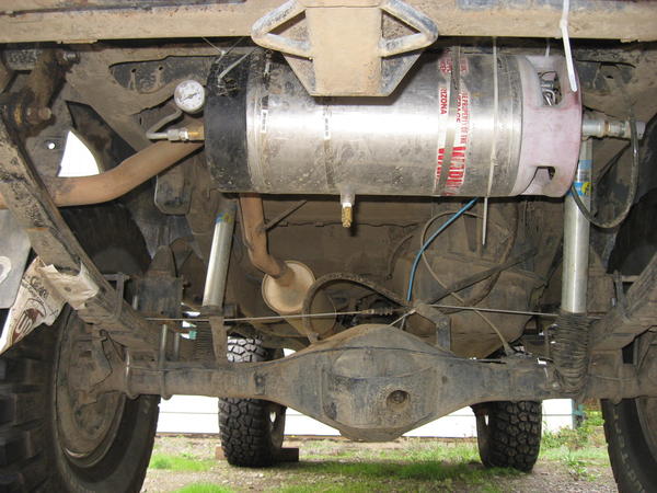

Just remember that A/C compressors are high pressure not high volume.......which having a tank will make it more efficient imo. Which is why I'm adding two more tanks.
Get a york
Spend the time to fab up a bracket to install a York and a tank. I put a 5 gallon beer keg as my tank where the spare went, and can air up my 35's from 9 to 30 psi in 45 seconds. It also nice to have a tank so you can blast your air horn at people when they cut you off.
