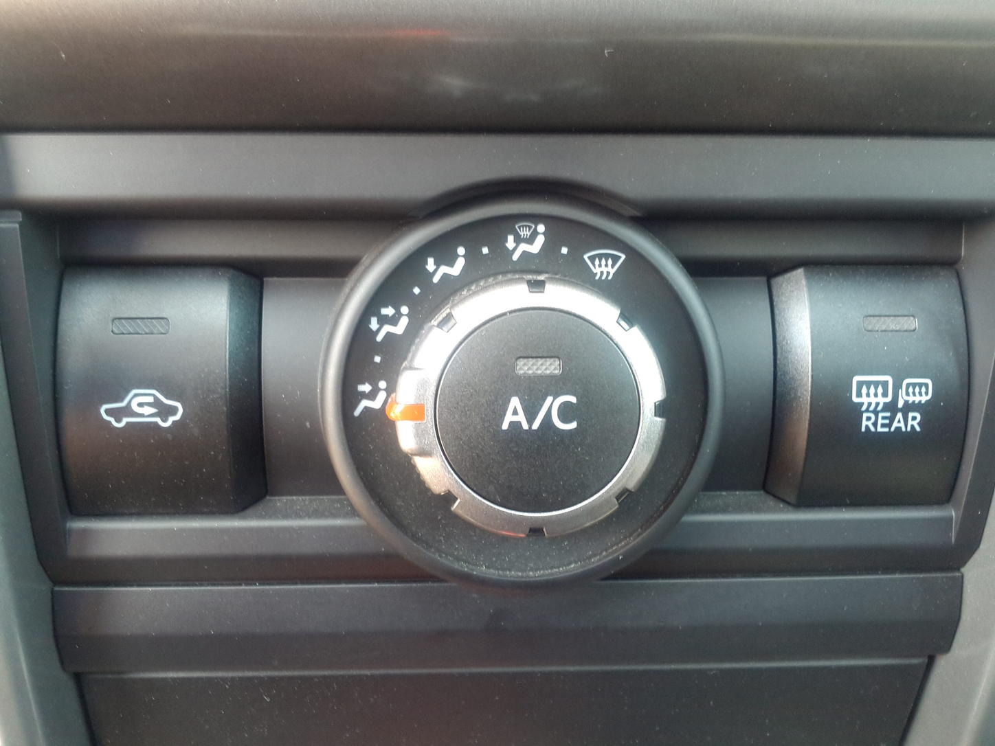

Hey guys just got an 2014 sr5 premium. I have a question every time I start the runner and turn the Ac on the recycle button light comes on I'm curious if this is normal. No matter what level the ac knob it's at. On my 2012 the recycle would only turn on if the Ac was at max. Just curious if this is normal and the new 2014 do this at a start up when u first turn on the Ac. Thanks guys
Turn your right knob CCW all the way and it will bring on the recirc air. From that position turn it CW one tiny bit and that will turn recirc off and outside air brought in.
Check the switch to the left of the AC knob too.
Looks like I need to clean my panel, noticed the dust.
Turn your Temp Control Knob CW one click to take it off of MAX, now if the Recirc Light is still lit up, tap it to turn the Recirc Off.
Now when you start your vehicle the Recirc will be Off until you either press the Recirc button or if you turn the Temp Control Knob all the way to Max, which automatically places the Recirc On.
That's how mine works!
Hope this helps.
