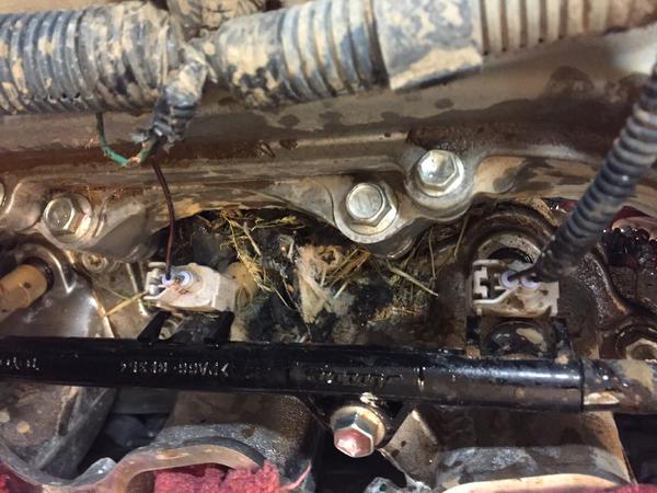

My TEP is currently at the stealership (my wife had it towed), apparently a rat has chewed through an injector wire. The service rep informed me they'll have to remove the intake manifold to complete the repair, and the charge will be $750.
I'm mechanically inclined and have no issue doing it myself, but I'm curious, how much of a pain is it remove the intake manifold and work on the top end?
I've changed the oil on it once so far, other than that though, I haven't looked at the engine much. We bought it so I wouldn't have to work on it! Damn rats.

I've had the Air Surge Tank(Toyota-speak for plenum) and intake manifold off another Asian SUV a number of times. Just a bunch of labor. Keep track of bolts - what hole(s) they go in, brackets, etc.
The factory service manual for a 2010 4.0 liter 4 Runner is here. Another member made it available some time ago:
https://www.mediafire.com/?91cliu5r6nb38
Once you read thru the pertinent sections, you'll need to buy new plenum gaskets and int. man. gaskets before starting. Could be some other stuff as well. Buy the parts from a dealer and not after-market providers.

They will, our deductible is $500. I decided to do it myself, I couldn't bring myself to pay someone to repair a wire. I pulled the upper intake off last night, pretty straightforward like lugnut said. The hardest part was figuring out how certain connectors came off. Here's what I found:
piggy14-albums-repair++upgrade+album-picture40278-rodent-nest-damaged-wire-said-rodent.jpg
The little bastard was making a nest using wire looming it chewed through, among other debris. No sign of it though.
