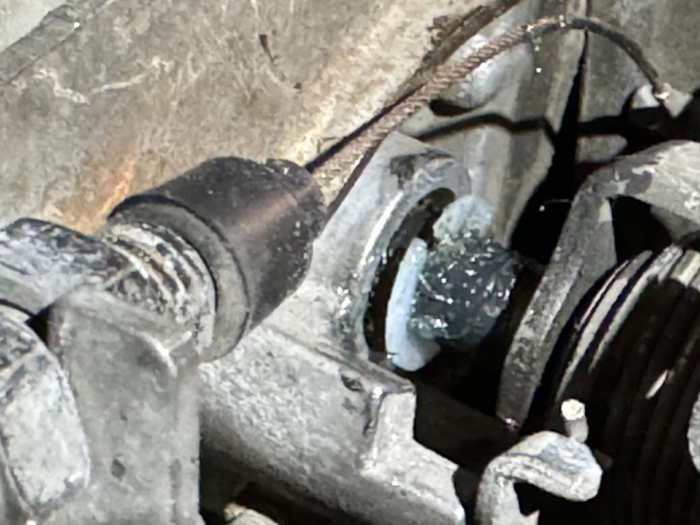

Another repair that was required was the broken antenna mast.
I purchased this kit and it worked well.
I pulled the antenna assembly from the wheel well and after taking the cover off the old broken bits were removed and the bail area cleaned. Then I lubed the bail area and reinstalled the assembly. After it was secure I installed the new mast and it works great.
A few youtube videos on this were watched beforehand, lots of wisdom out there.

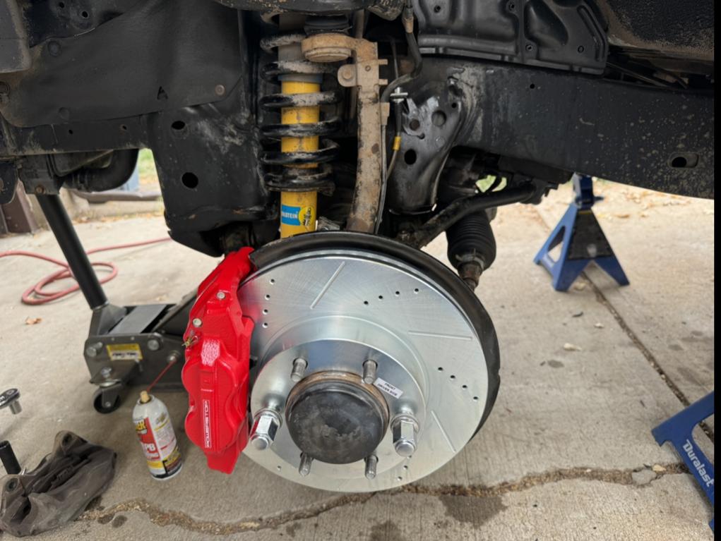

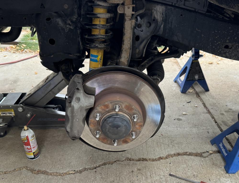

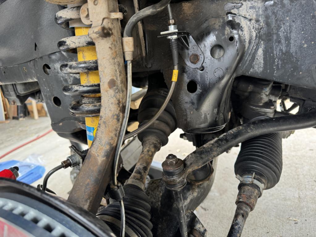

After, second pic is the new brake line-
Powerstop offers an $82 core return after you ship the originals back to them.
I used this Allstar brake bleeder, worked like a charm -
PhoRunner's video & bleeder recommendation -

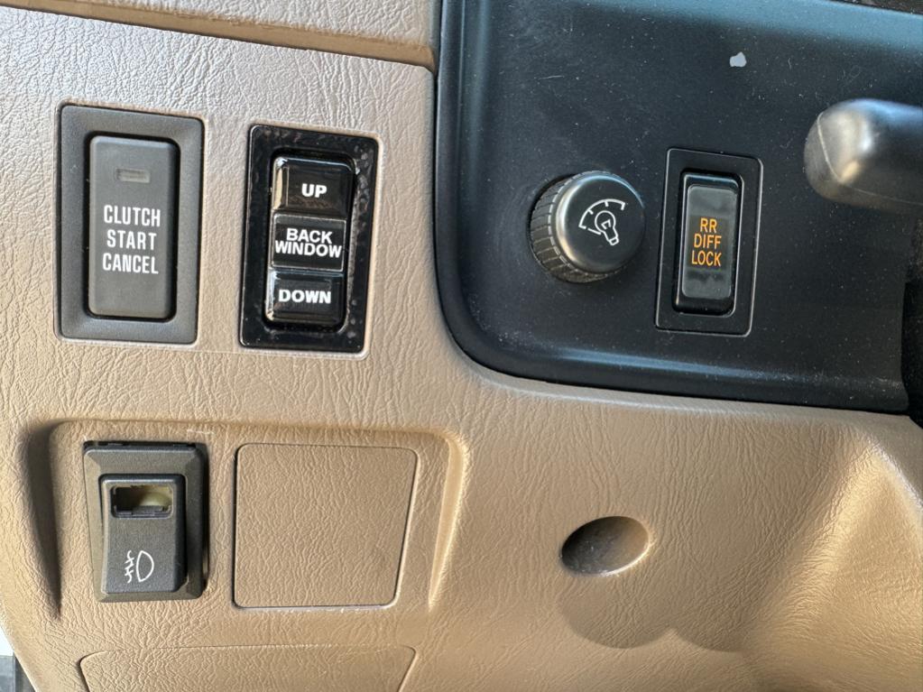

Then I moved the rear window switch from the center console to the switch panel to the left of the steering wheel. After I unwrapped some of the electrical tape the wiring harness for the switch reached easily.
The problem I found afterwards was that the switch labeling/action was reversed at the new switch location, DOWN was on the top of the switch and UP was on the bottom, not intuitive at all.
So I first reversed two of the wires on the back of the switch so that pushing the top of the switch put the window UP and the bottom of the switch moved the window down.
Then I relabeled the switch using plastic Dymo labels (white lettering, black background) and then clear coated the switch after cleaning.
It makes sense now -

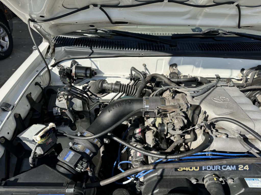

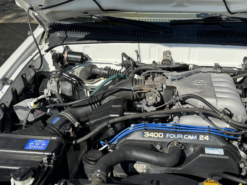

Installed an Airaid intake tube also. Eliminates the baffles and cleans up the engine compartment.
I've had good luck with one on my Suburban 5.3L with it's proven dyno results to a stock engine.
Before & after -

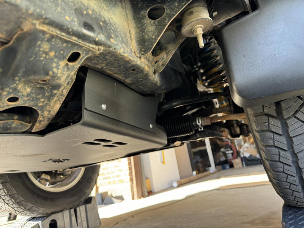

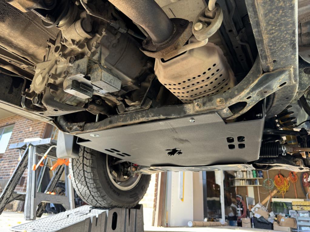

Catalytic converter theft in my area is pretty bad so I installed a Talons Garage transmission /Catalytic Converter Skidplate to protect my T4R-
Toyota 4Runner | Transmission & Cat Shield | 1996-2002
– Talons Garage
I bought the steel version and installation was easy.
It protects the forward area of the cat so that they can't cut off that end. I may install a DIY extension with steel mesh to stop a thief from mistakenly cutting the other end.
Another option is buying their transfer case skidplate.
A few pics -
Before & after -

Before I installed the Airaid intake tube I removed and cleaned the Idle Air Control and the throttle body. The IAC was a bit sticky but it cleaned up well with some carb cleaner.
I ordered an IAC gasket ahead of time from Toyota parts online and picked it up at my local dealer. I knew my 26 year old gasket would be stiff so I planned on replacing it. It did break when removed.

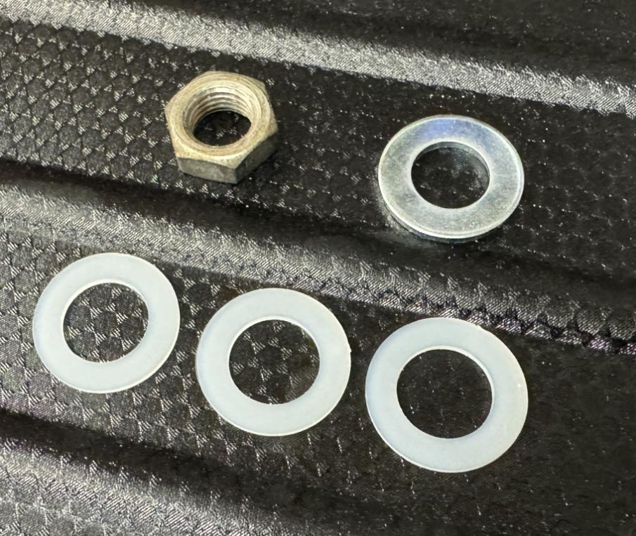

My idle is still sticky so I'll be trying this throttle bail washer mod today (my throttle body sticks like the YouTuber's did) -
I went to my local Ace hardware with the nut that holds the throttle body bail onto the shaft and found that the nut fit on a M8 -150 fine thread bolt. I used that bolt to find some washers and bought one steel and 3 thinner nylon washers.
I figured that I could cut a nylon washer with a razor knife and put it over the shaft without taking the bail off.
The washers & the nut-

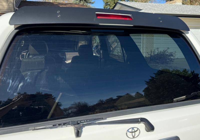

Removed, cleaned and painted the rear spoiler, it's brackets and the rear wiper assy with SEM Trim Black paint this afternoon -
