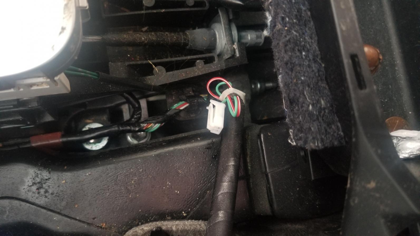

Does anyone know what this plug goes to?
Its under the shifter bezel with the 12v and window switch.

Have a link?
I think his post was about this thread and a link to what he called the “updated” choice of USB port I ended up going with is in the very first post. It’s the one by BlueSea Systems. Hope that helps, LMK if you have any questions.

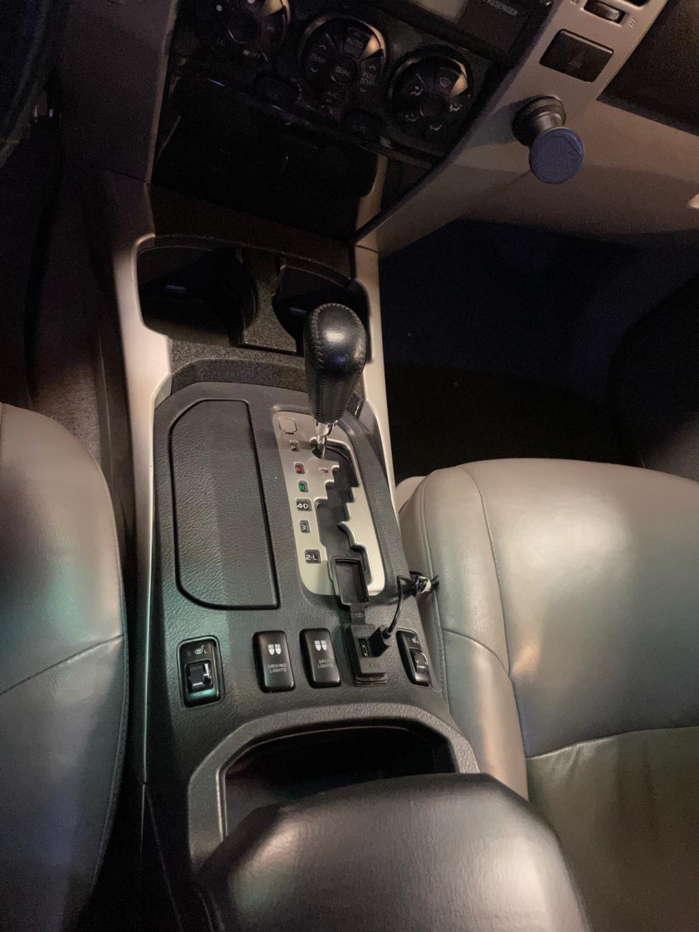

I did this Mod about a year ago and went with the BlueSea dual USB charger feeling it was a quality unit. I’ve been very happy with it. But yes it did take just a little trimming to get it to seat right and I used a silicone adhesive on the underside to help hold it in place.
That plus a “GTA” Bluetooth kit to connect to the factory head unit with hands free calling really brought the vehicle up to a more modern experience.
