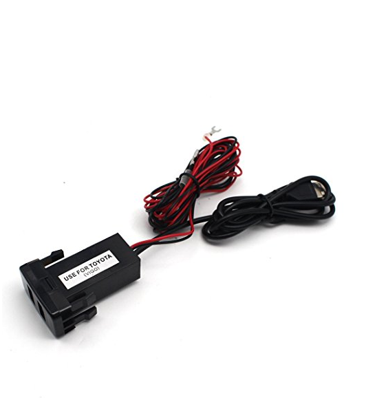

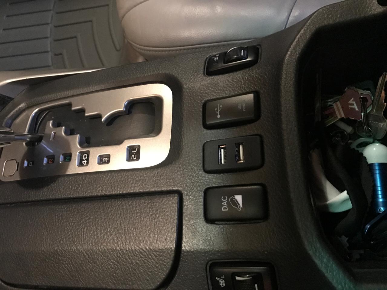

This was a great mod! I did a very similar thing in mine after I saw this post... with a few differences. I used a dual purpose USB, which allowed me to move an existing USB port hooked up to aftermarket Bluetooth out of the small compartment under the HVAC controls and over to this new space. I also added a switch to just the power portion which filled up the rest of the blanks next to the DAC button and it all looks factory. Very happy with the end result, as it removes a lot of clutter out of charging devices... it's especially nice on long trips. Here's a few pics.

Found this on amazon for little under $15

Amazon link to the part you used?

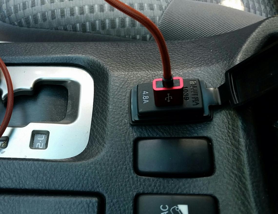

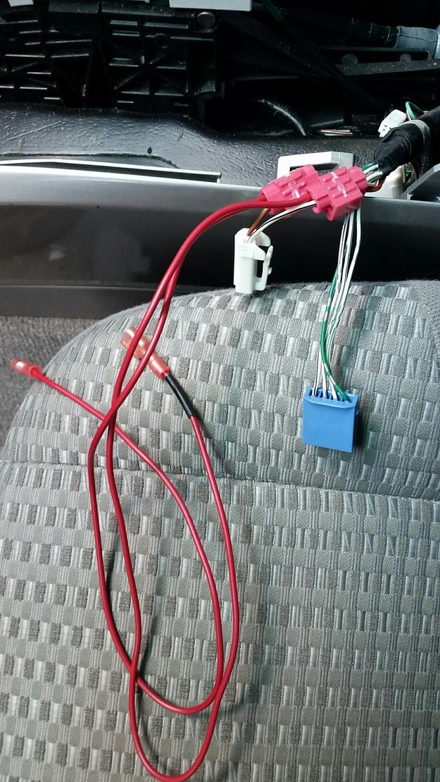

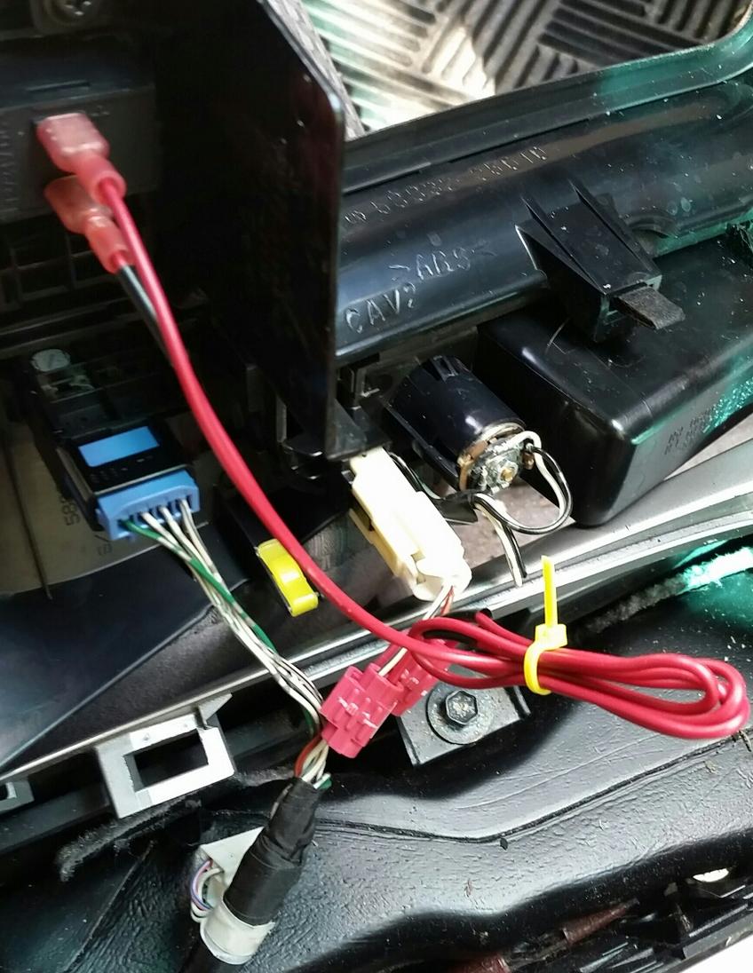

Just installed the 1039. Thanks to Bluesky_07 for answering a few questions!
I quick spliced into the 12V power and ground and crimped some connectors the the unit.

Got sick of the slow charging, partially due to the 2.1/1.0 ports and also crappy cables so I ordered a bluesea 1039 and new OEM fast charge cables to hopefully never get let down again. I will have the 2.1/1.0 up for "pay it forward" grabs by the end of this week. It is spray painted to match OEM buttons and block some of the blue light.
Threw my blue sea version in today, had to carefully file out the sides of the opening to 20.90mm for it to clear, leave the top and bottom as is. It looks a little bulky and a lot less OEM but works well.

Agree that the Blue Sea doesn't look stock, but imo there are good and bad versions of that and this is one of the better ones. ;-)

What put me over the edge is I have friends with the round versions of the Blue Sea mounted on their adventure motorcycles and they've been taking a beating for a couple years now, still charging fast and no worse for the wear.
Thanks Bluesky. I had looked at that earlier but clearly didn't pay enough attention. It mentions the rust-colored wire as the positive, but didn't mention the negative and I didn't look closely enough to where the tap was.
I just tried it and it worked out well. Then the crimp cap came loose. I'm gonna have to go get soldering stuff and re-work a few of the wires now, b/c I severed the cigarette lighter (never use it & don't want it - at least not right there) to make room on the wire for this new connection. :mad:
What was the negative? The OP post pics don't work anymore. I was going to tap splice the wires from the cigarette adapter too.
Rust is positive....what's the negative? Any why cant you just tap into the cig lighter versus after the white connectors???
