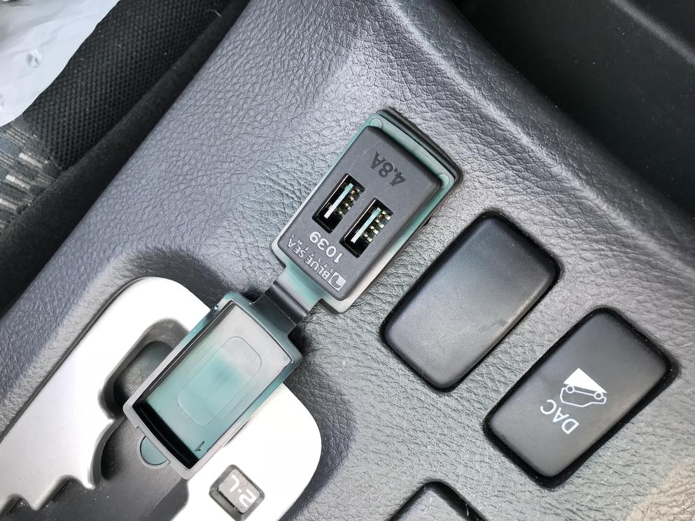

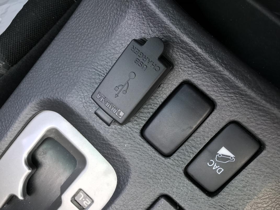

... replaced the original USB ports listed in this thread with ...Blue Sea 1039 4.8A model....
Thank you for this write up. I used your guide and your updated choice of USB ports and couldn’t be happier.
Nice! Buy once, cry once. Tnx for the info.
Many people write about intermittent problems with USB ports. This fixes one of the common causes - not enough capacity.
