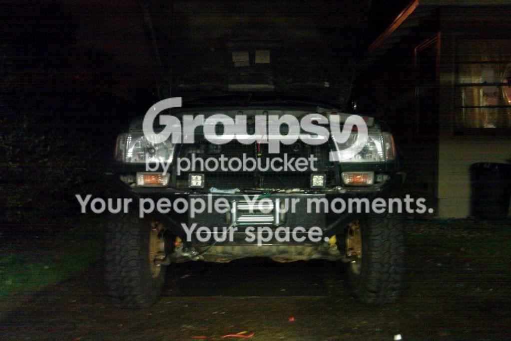

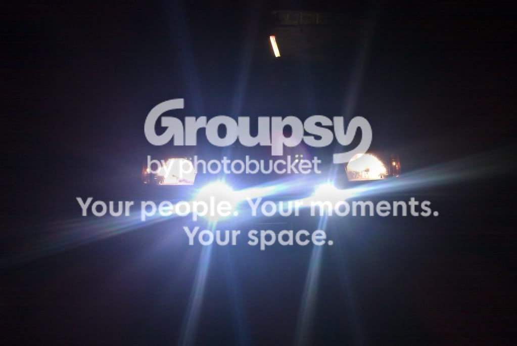

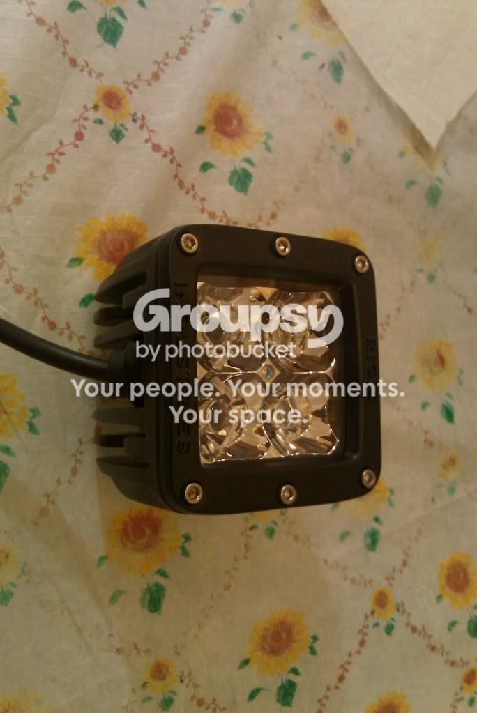

I don't want to hijack here. I just added some lighting up front. I used the factory fog light circuit witch I have never has hooked up. I installed some rigid industrys LED flood lights. Now I need help finding the fog light on mod. I have searched and found tons on foglights but have not found how to make it so I can use my fogs anytime, now they only work with lights on low been. Thanks to anyone that can link me up. Here are a. Couple pics.
