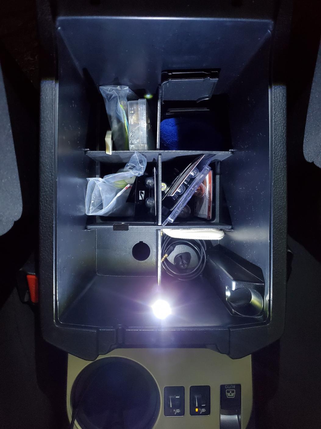

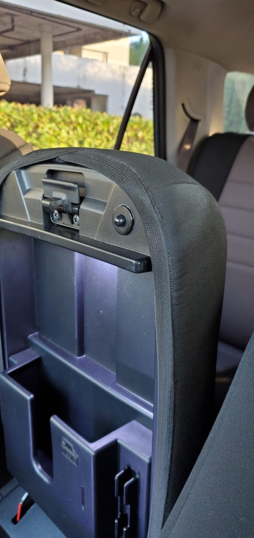

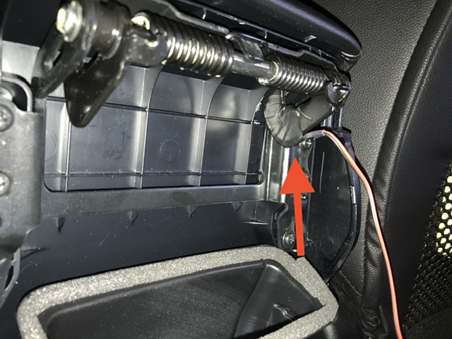

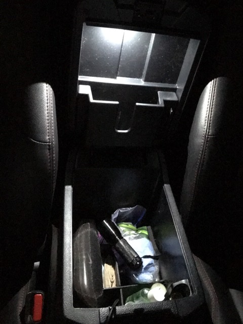

Thanks for this great idea. I’m really pleased with how it turned out. Here are a few of my tweaks to your design.
For the switch I first tried to devise a way to use a mechanical limit switch but couldn’t find a clean way to do it. So I took apart an old Leviton household power switch, the illuminated kind that used a small drum of mercury for silent operation, and soldered leads to it. I had to cut out a little of the plastic recess in the console lid to get it to fit snuggly. It’s kind of a heavy item so I put some foam under it and glued it all to keep it in place.
The LED I used was a cool white 1W 6mm Oznium bolt, installed offset from the center of the lid. I didn’t want a lot of light to shine out while driving at night, and this LED puts out enough to nicely light up the interior of the console box.
I installed a connector in the power leads for easy removal of the lid for any service or future mods.

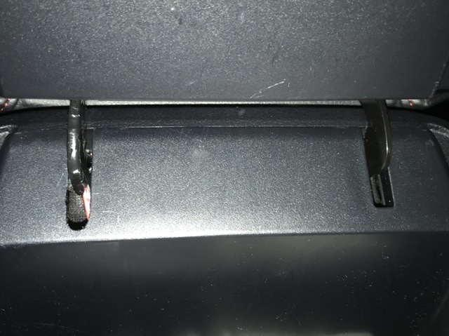

When routing the power cord and taping it over the hinge bracket edge I noticed that if was a tight fit, so I enlarged the receiver hole with a round file.
To keep the power cord from flexing too much I taped up an edge to create a service loop to minimize wire bending.
It’s working well, let there be light!

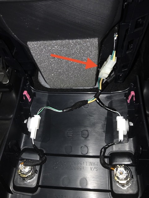

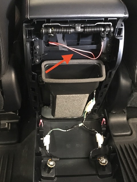

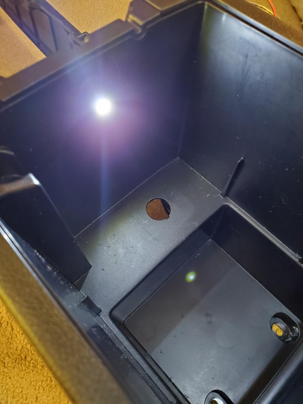

My take on the LED center console mod

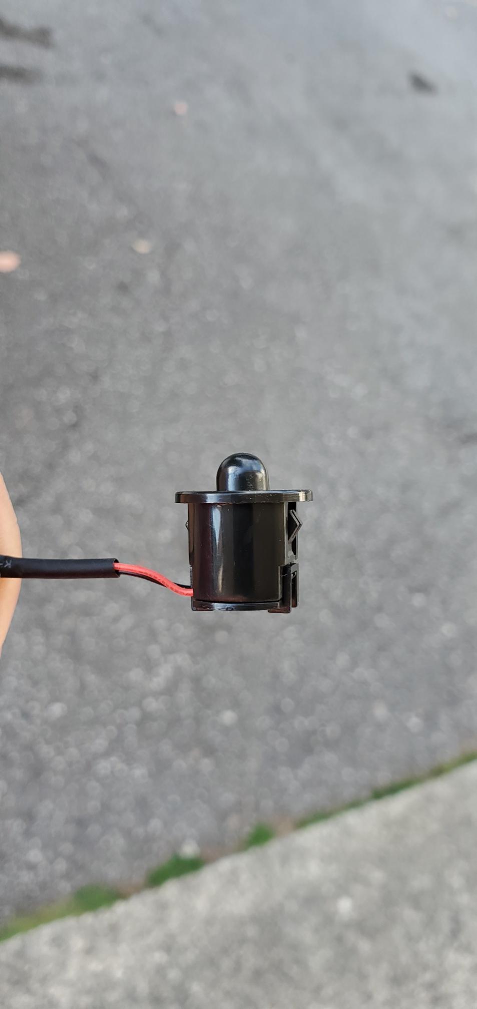

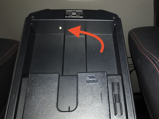

I tackled this project today. I did the dual-LED version with 6mm LED bolts.
Parts:
  • Oznium 6mm cool white LED bolts (2)
  • InstallBay IBMS-3 mercury tilt switch
  • Cable clips from Amazon
First, careful measuring for the holes. My holes are positioned like daytonaviolet's, but a little bit "higher" to move them more toward the center of the center console abiss. Drilled from the inside.
Mounting the LED bolts:

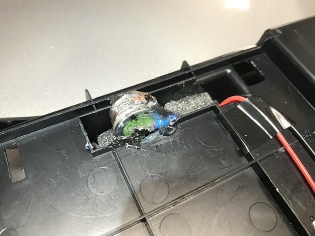

I chose to run a single pair of wires down the lid to the tilt switch to minimize the amount of material. I "T" soldered the two LEDs together in the gap between them:
I'm using aluminum tape, which I've found holds up better at high cabin temperatures than electrical tape:
Tilt switch mounted at an angle like emmantik figured out is necessary. This one comes with its own double-sided mounting tape:
I'm letting the tilt switch control the ground, and the power is coming from the parking light/dash light circuit. This way the new LEDs only come on when the parking lights are on, and only when the center console lid is raised. And this is important...the whole project MUST be done on a zebra-print towel on the kitchen table. Otherwise, it won't work. All wiring run and taped down:
Wire exiting the hinge slot, with braided sleeve for protection (and good looks):
HD090 2-pin connector added for modularity. The harness side (truck side) of the wiring runs toward the shifter just like the rear-seat USB ports do. Ground goes to a bolt inserted into an unused stock threaded hole near the parking brake bracket, and power comes from one of the dark green wires that run along the passenger side of the inside of the center console near the shifter:
The finished product, ready to reinstall into the truck:
I mounted the LED bolts flush with both plastic "nuts" on the back side, for a professional finished look:
