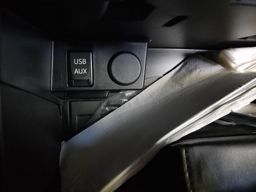

I also moved the factory USB/AUX. port to the glove box, and now have an aftermarket switch in its place (soon to be changed to a RJ45 port for a GMRS radio microphone).

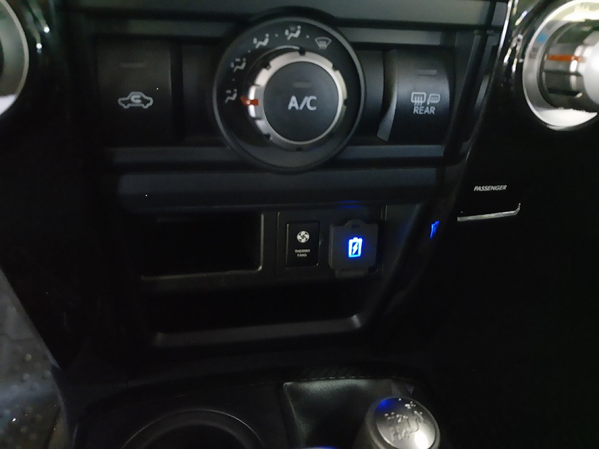

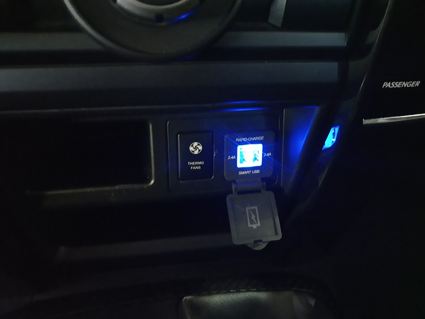

Yup, gets rid of the 12v lighter port! I just took some pictures so everyone can see what it looks like:

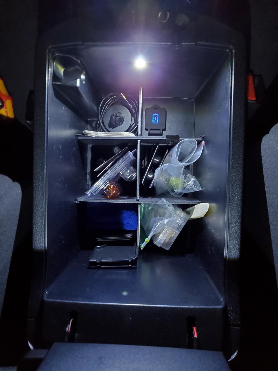

I used the same USB as Nauty but put it inside the center console. It replaced the cig lighter.
