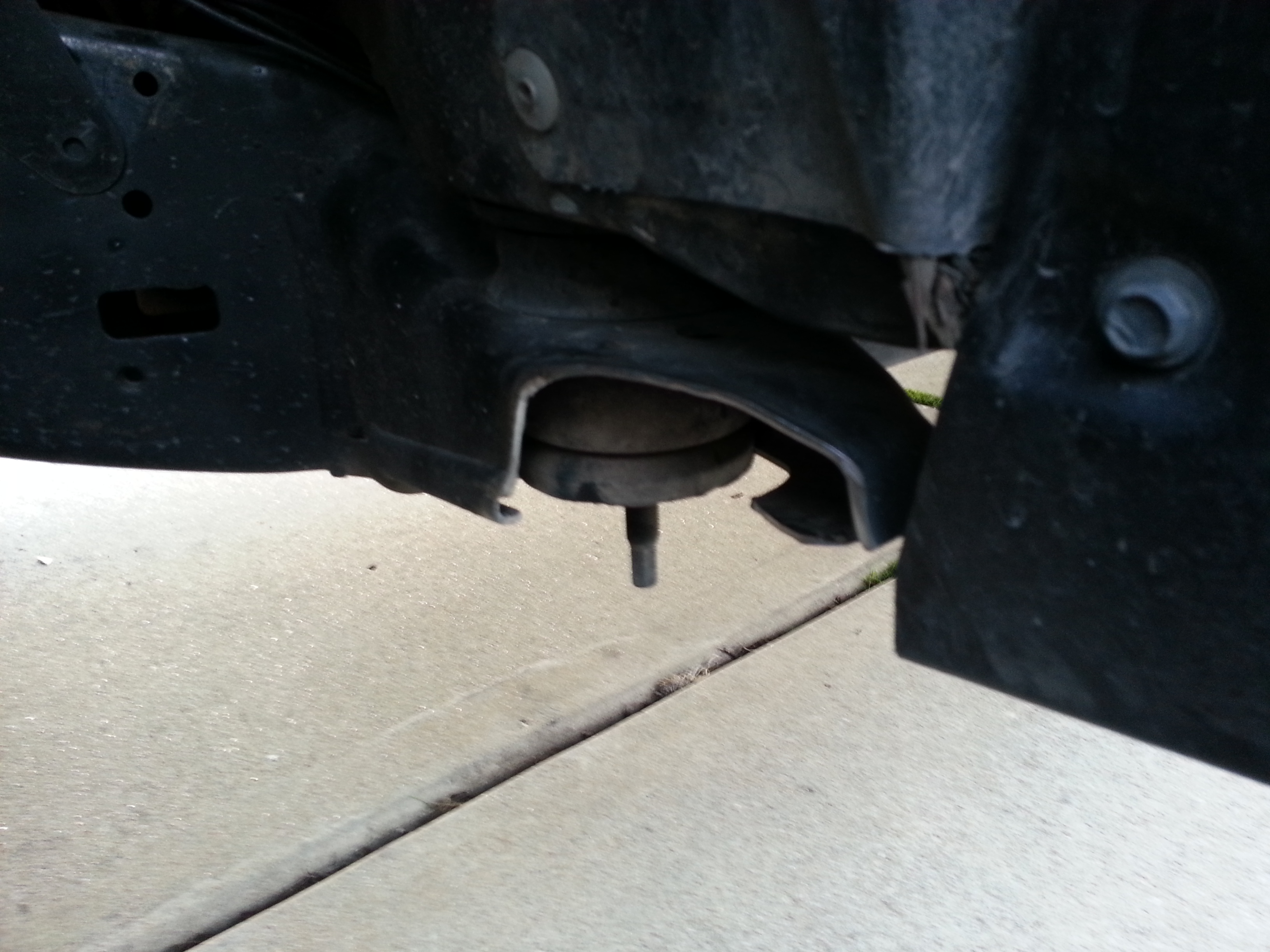

Still getting some rubbing, and noticed that (only) the passenger side tire is hitting metal at the back of the wheel well by just a little bit when the steering wheel is at full right lock (I have already removed the plastic mudguards). Looking at the alignment report the dealership gave me after the lift (see below), it looks like the passenger side tire is 1 degree behind the driver side tire, which I assume explains why I'm having this problem.

the metal you are rubbing on is the body mount, you simply cut that protruding piece and leave it or weld in a piece of metal to make it flat so no more rub, it is pretty standard for lift and rubbing

I sent you a PM but I should be able to fix that with little issues, the fact that your running a 265 and have a lift means there should be no rubbing . usually we run 285s on a 2.5/3" lift and still only have to remove the mudflaps and move the fender liner. The dealer is either uneducated or really lazy. most likely lazy.
