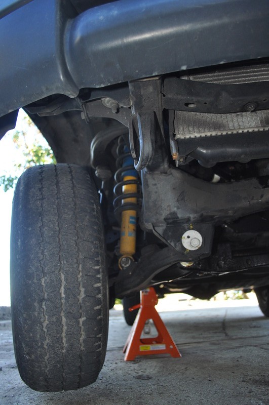

Today I had to replace the tire with the spare because it was worn to the belts on the outside edge.
I still haven't found anything wrong with the ball joints or the tie rod ends. Sigh.

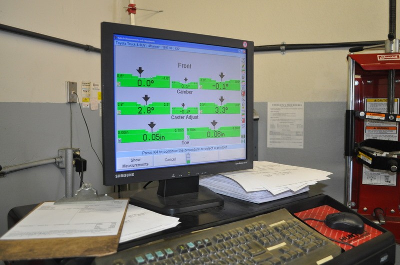

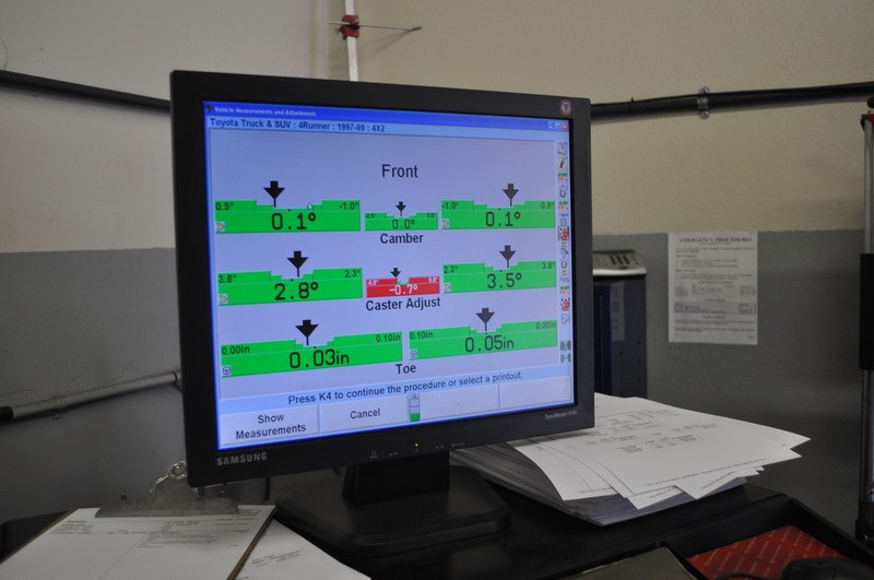

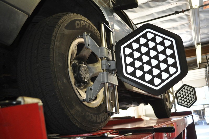

LONG TERM UPDATE:

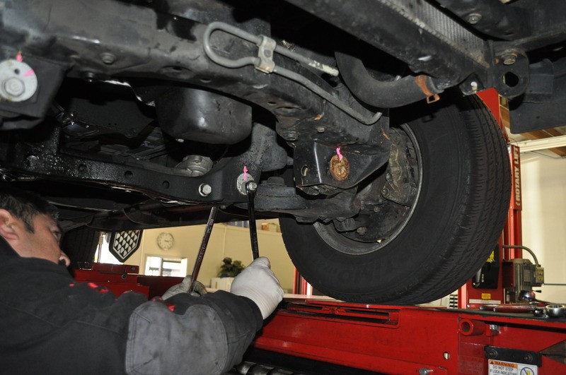

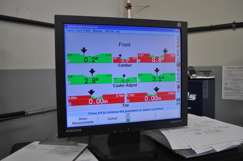

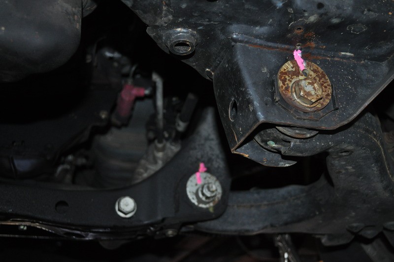

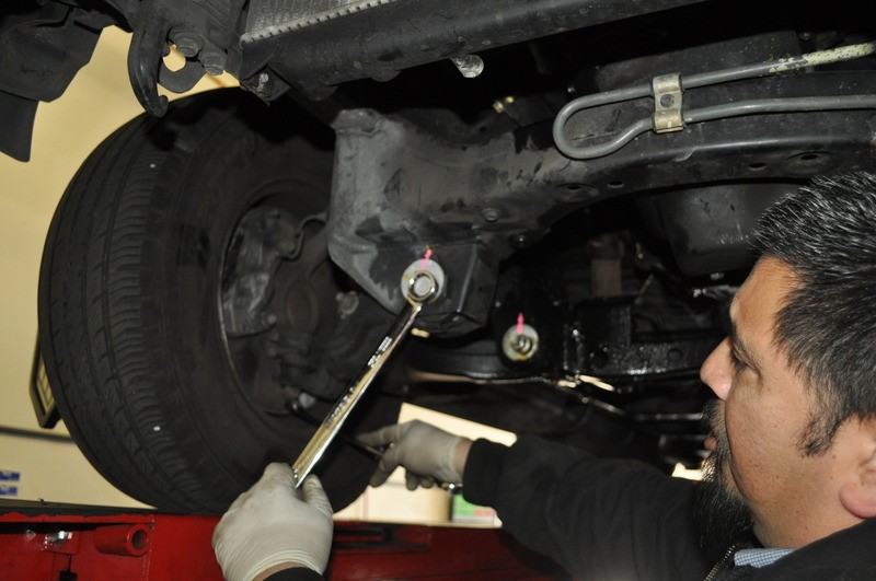

I had forgotten to update this thread with the photos showing that the alignment for the camber on the front driver side wheel was way off, and positive ... which was causing the tire wear.
Here are some pictures taken while the 4Runner was on the Hunter alignment machine.

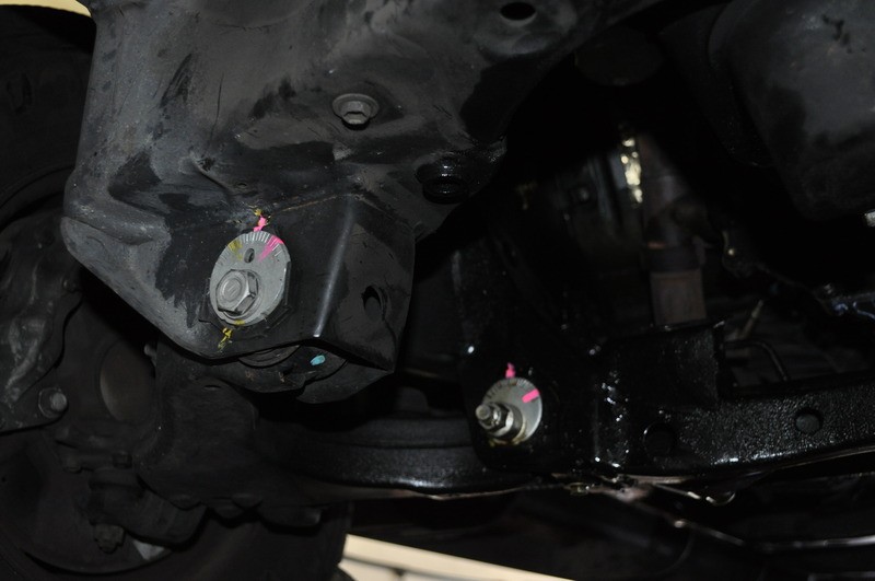

Here is a closeup of the eccentrics for the passenger side versus the drivers side.
Notice how much more the passenger side is moved based on the nail polish I had placed on the eccentrics prior to alignment.
