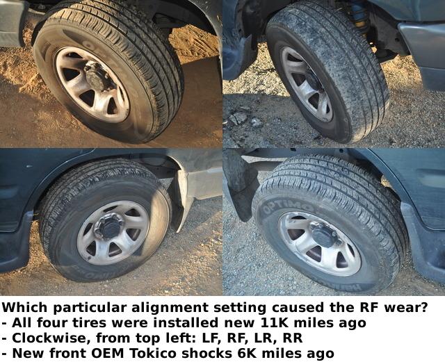

Attached is a picture of the four tires, all of which were new 11K miles ago, with an alignment 10K miles ago and new front shocks about 6K miles ago.
This is the second set of tires where this happened (the first set was before the new front shocks).
Any idea what the culprit might be before I bring it back for re-alignment?

Holy ****. I'm sorry this post won't be helpful to you at all, because i cant remember if thats camber or toe and like you i'm to lazy to do a goole search. Does your runner track straight? I wouldn't think so with that happening that quick. Where did you get your alignment done?
Ahh. Ok. This was the last set of tires it happened to? Looks like Billsteins in the pic.
I would definately get it realigned, but not by the same person who did it last time. I would probably also raise hell with whatever place did the last alignment. Although you probably could have mitigated some of the damage to that tire. Did you drive knowing you had a problem for a while?
best of luck to you
past bs aside, you should probably have them check your lower ball joints.
back a few years ago both my front tires were wearing badly on the outer part of the tire. I ignored it for awhile and finally complained to the mechanic I go to. He told me that my LBJs needed replacing for about $400 parts and labor.
I think I was very lucky because it is not uncommon for LBJs to suddenly give out when driving. If one of them breaks while the car is moving you will surely crash because the front wheel basically falls off.
Make sure they use a real Toyota OEM part but it probably doesn't need to be done by the dealer or anything. You can even do it yourself but my excuse is I didn't have a garage or tools when mine went out.

It should be easy for any competent mechanic to test the LBJs and tell you if they are bad or not. It requires less than 30 mins labor to check.

I cant remember if thats camber or toe
Thanks. Based on the answers, an alignment check [and LBJ test] will be the first priority.

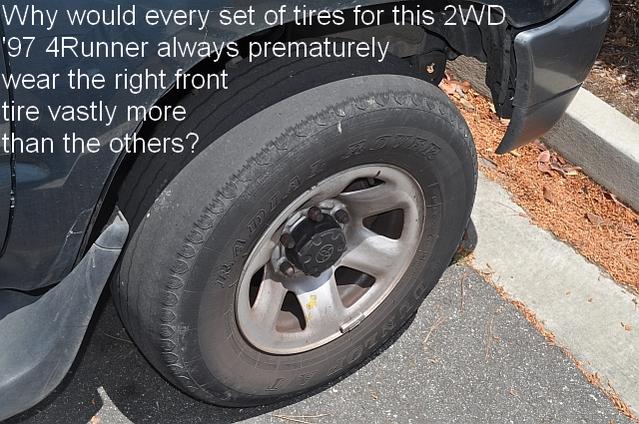

Here is a shot of the last set of tires:
45342d1306788763-1997-2wd-4runner-front-shock-blown-need-parts-suppliers-2wd-diy-steps-advice-front-right-tire.jpg

Thanks everyone for the advice. My first step coming home today from work was to check the lower ball joints.
I have a dial gauge & clamp mechanism (for testing rotor runout); but I can't imagine how I'm supposed to apply 66 foot pounds of force to the lug nuts as described in the Toyota FSM.
How would anyone perform the test in the FSM?
Moving forward, I floor jacked the 4runner up by the center jack point below the engine & performed the recommended simple tire-shake test with the tires up in the air. (Note: I tried to put the 4runner on jack stands, but failed as per this thread.)
After jacking the centerpoint so that the wheels were freely dangling in the air, I shook the wheel with my hands at 12 & 6 o'clock; there was no perceptible motion of the lower ball joints.
However, when shaking with my hands at 3 & 9 o'clock. there was an audible click which was hard to pinpoint where it was coming from. It seemed to be coming from inside the steering mechanism boot on the driver's side (see more detail below) but the tire that wore badly was the passenger side.
I then ran the LBJ pry-bar test from this URL - and (on both sides) my 4Runner lower ball joints didn't budge a bit:
- VERY BAD Ball Joints - WATCH THIS!!! - YouTube
Did I do that test right?
Here is the pry bar test on the passenger side (bad) tire:
Here is that same test on the driver side (good) tire:
Both sides seemed pretty tight to me.
The only thing that seemed awry was that slight clicking sound when shaking the wheel at the 3 o'clock and 9 o'clock position.When I shook either one of the wheels, I could see the other wheel moving also.
Based on this Ford Explorer video, it seems (I think) my driver side inner tie rod end (inside the boot) is where (I think) the slight clicking is occurring when I shake at the 3 and 9 o'clock position.
Front Suspension & Steering Inspection - YouTube
The weird thing is that the driver side is not the tire that is wearing abnormally!
I'm not sure if anything is actually wrong with the ball joints and/or tie rod ends yet.
Any advice?

a tie rod/rack play would lead to a feathering tread
Hmmmm.... The tread appeared 'feathered' before it was worn down to nothing ... so maybe it's the rack???
Oh look, its another thread where the LBJ HAS to be the problem, it doesn't have to be, it could potentially be the problem, but its not a surefire answer, Everyone here really wants everyone to drop $350 on new ball joints as if they are LBJ salesmen.
But yeah thats your alignment, my moms car's alignment was off the chart and the tire went in less than 8k miles and the car drove straight.
lower ball joints would normally cause wear to the INNER part of the tire, not the outer. that looks like the toe is way out. bad alignment.
has it ever been wrecked?
But i do agree they should be checked, but i would hope the mechanic doing the alignment would look at them cause they are right there where he is working.
truth. and a good shop would NOT do the alignment if it had worn parts. its impossible to get it correct.
long thread but for infos sake alighment shops can suck. I am done with them since I can ball park it better then my last two alignments. check for worn tierods, control arm bushings, UBJ, LBJ, rack bushings and then chalk is up to bad alignments.
maybe better than the last 2, but not even close to where it should be.
find a new shop.
That's starting to make sense since the clunking seems to be inside the steering boot. I'll try to measure the wheel-to-wheel toe - but I don't yet have the tools to measure single-wheel toe.
