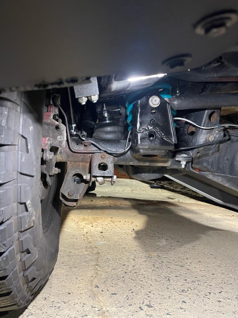

The diff bracket is welded and painted, just need to replace it tomorrow, but the skid plate needs to come off
Cut off the factory bump stop brackets to make it a cleaner look. With the springs off I was able to cycle the suspension and see where it needs to land. To my surprise (maybe it shouldn’t be..) I basically had to reuse my make shift spacer I built for the factory brackets in order to have the bump stop taking up the force when it fully compressed without bottoming out the shock. I welded the rectangular bar to the frame and will bolt the new stops to it tomorrow.

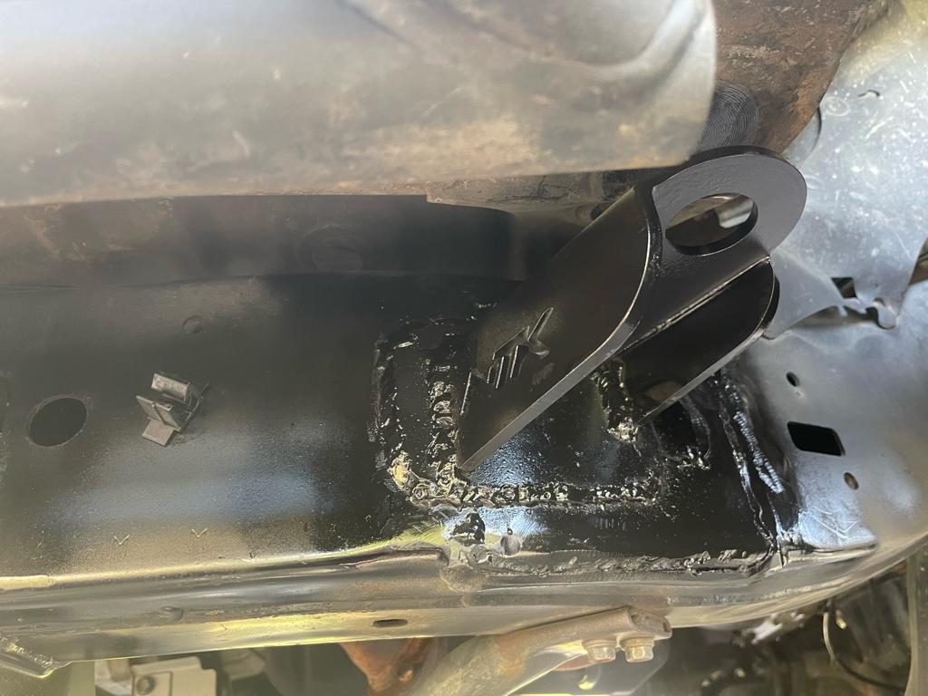

The pan hard bracket is also on and painted. Haven’t messed with centering the axle bc I ran out of time. Hopefully my welds are solid enough…because they certainly aren’t pretty lol

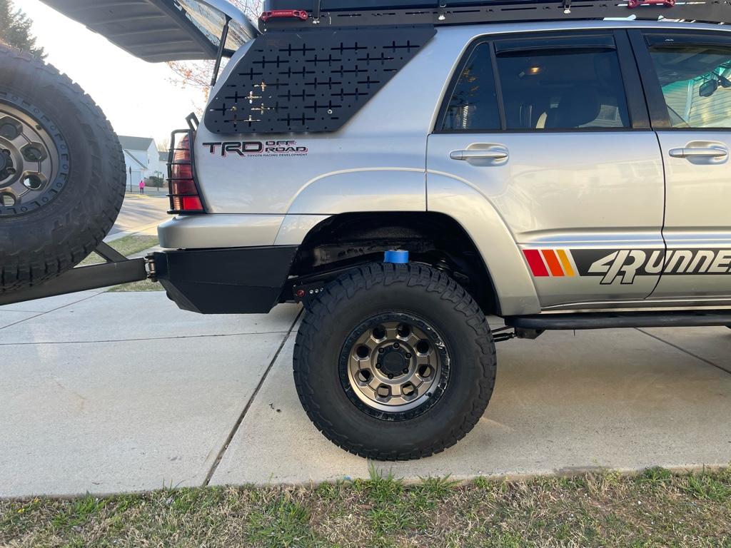

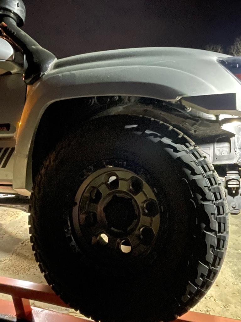

Also welded on the bumper caps again. I was pleased to see that I really didn’t have any rubbing at full stuff anymore. I can definitely see fitting a 37 a real possibility. Need to adjust the pinion angle tomorrow before I put the springs back in.

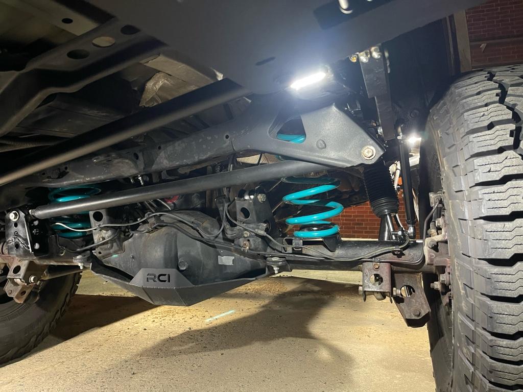

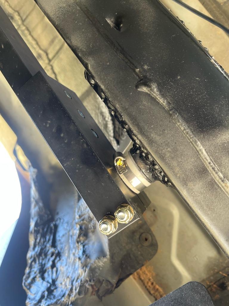

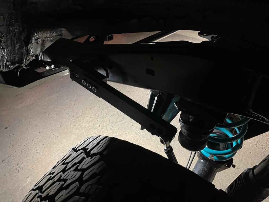

For the tk 1 racing sway bar.. it’s on. I’m certain that it isn’t perfectly configured.. At ride height the arms should be parallel , but with where I located the bar that was impossible to do unless I really cut down the links, which it said should be at least as long as the shock travel, which I believe is 12 inches. I probably should have located the bar a bit higher and more forward, but it should still work.
The tabs that weld to the axle are surprisingly small.. I hope I put enough heat to get good heat penetration to the axle.. a bit worried that these could snap off since this is what is transferring all the force from left to right but I guess we’ll see. Didn’t get a chance to cycle it with the links connected because the paint was still wet but I’ll see how it does tomorrow.

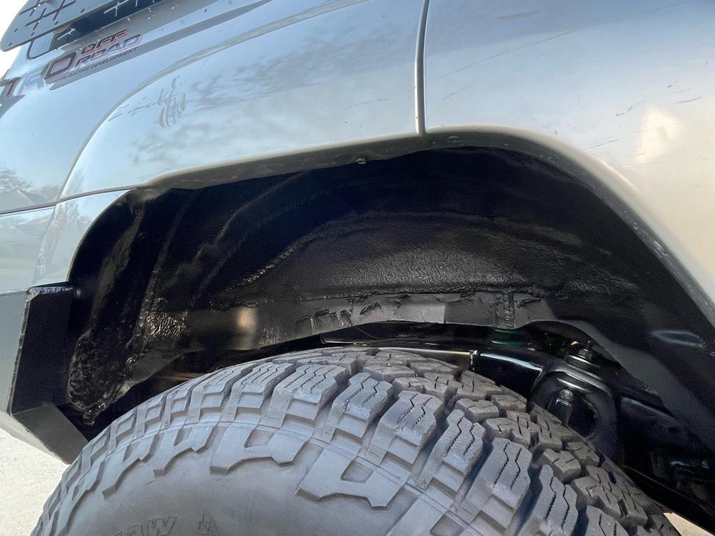

I also took some time to smear some seam sealer all around my trimmed and hammered wheel well to keep water and rust away. Will need to hit it with some paint tomorrow and should be good to go. Getting excited about finishing all this work up.

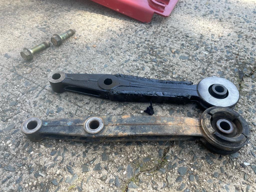

Oh yea.. I also recycled 2 of the mounting tabs from the factory bump stop brackets I cut off and welders them to the lower links so I can have a proper mounting location for the parking brake cable. It was zip tied before and was rubbing the paint off and rusting.

First impression is that there is certainly an improvement in body roll. Let’s see if the tabs hold up on the axles and not rip off ;)
Everything is trimmed and installed, wheel wells are cleaned up and painted. The rig definitely has significantly less body roll. The tabs on the axle housing held up so far and haven’t popped the welds.. so off to a decent start I guess. Lol

Here is a little additional feedback on the sway bar side of things.. still impressed at how much of a difference it made.. very noticeable for sure. I haven’t tried just the stock rear bar but this TK1 racing bar (even not setup 100% accurately) works awesome for on road driving.
One thing I realized I should have done is probably also have the weld tube longer to match the wider torsion bar. What I ended up with is about a half inch gap from the inside of both arms to where the bushing sits in the tube. This allows for the hole bar to slide left and right an inch or so. Not a huge deal, but when both wheels unload and are even it allows it to move and give a slight clunk.
What I plan to do it get some schedule 40 pvc tube , cut it on one side and slip it over the bar to take up the difference with a simple worm clamp to hold it down. A quick fix , but something I wish I paid attention to before I slid the last arm on. It was a TIGHT fit. I beat the hell out of it with a mallet to get it on so I’m not trying to take them off if I can at all avoid it lol.
Once again... if you have been running with no sway bars I would highly recommend going to a TK1 racing, or something similar, for an off-road style sway bar at least in the rear... I don't know if its just me, but so far I have been pleasantly surprised by the reduction in body roll under normal driving conditions.. pretty damn impressive.
I can only imagine how much better it would be if I positioned the bar more up and forward to get it to sit level at ride height and have the links completely vertical (mine are at a slight rear facing angle so some of the force translation isn't direct ) but even as it is , pretty amazing.
I am hoping to do a flex test in the next couple of days to see if I it allows full articulation/bump stop compression. My bumpstops seem to limit the complete upward travel JUST a bit, probably have almost .75" of shock travel remaining, but I would much rather be on the safe side and give it some breathing room in the case I really come down hard on a single wheel when already almost fully compressed so that I don't blow a shock out.
This will also greatly help with stuffing a 37 down the road without having to worry about rubbing too much on the inside of the door.

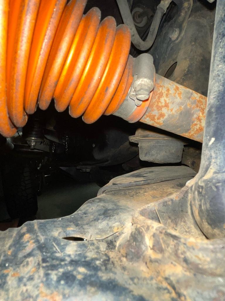

Simple problems call for simple solutions. Used a 1 1/4 inch pvc pipe, cut a part of it and slid it around the torsion tube and used a worm gear clamp to secure it in place. No more lateral movement (well, very minimal, about 1/8” ) on the bar. Should do the trick just fine. But this is where I was saying that if I had the weld tube wider to take up all the slack in between it wouldn’t have been an issue.

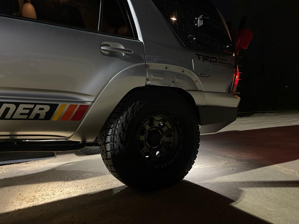

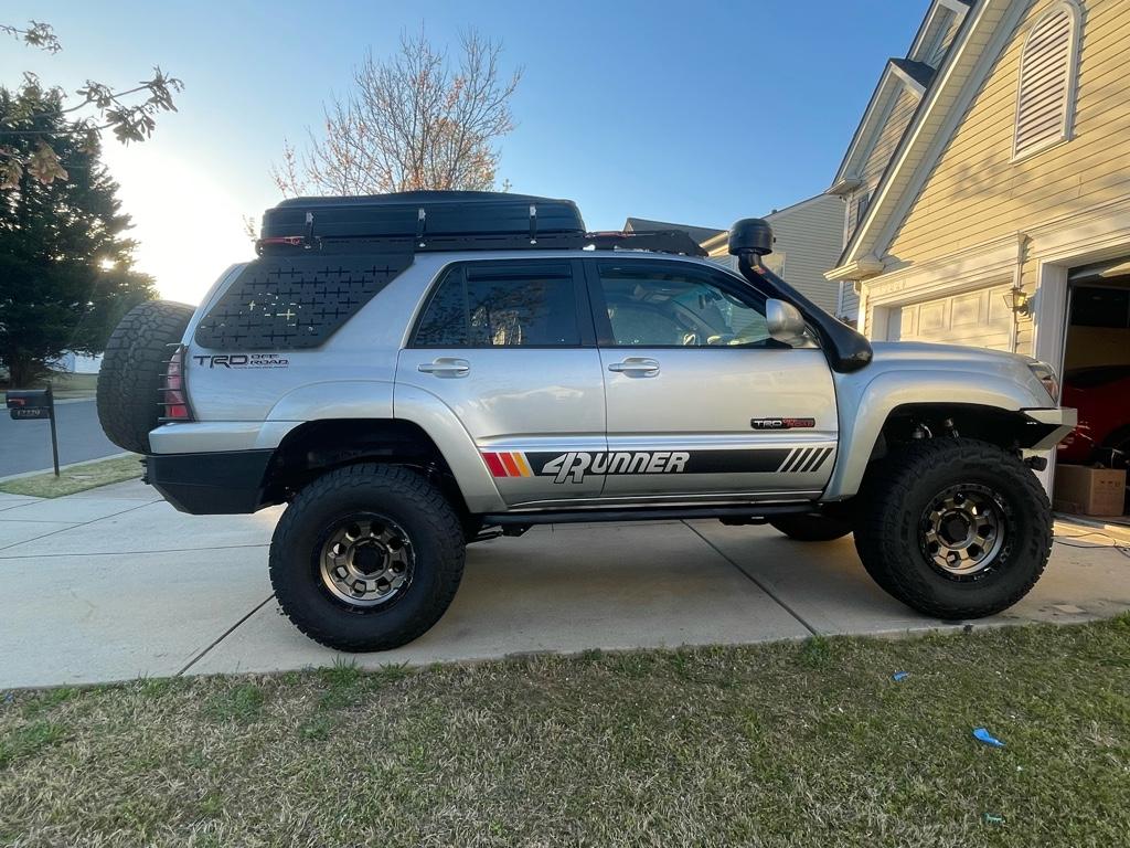

After getting the panels back on and getting the bumper welded up and painted I couldn't help but notice how funny the factory rear wheel arches look compared to the wide-fender fronts... I am finally going to fix this.. and since there isn't any off-theshelf options that I currently see available (at least not ones that done also required a tone of fiberglass work anyway) I plan on building out my own wide-body molding pieces.
The plan is to shape it out in modeling clay to where the shoulders more or less match the fronts and then turn to fiberglass to finish them out. I feel like it should be very doable, and hopefully shouldn't take too much time... and will ultimately get me one step closer to my latest, completely unnecessary idea which I think will suit my build oh-so-good.. it will involve a complete color scheme change, isn't paint, and isn't wrap :)

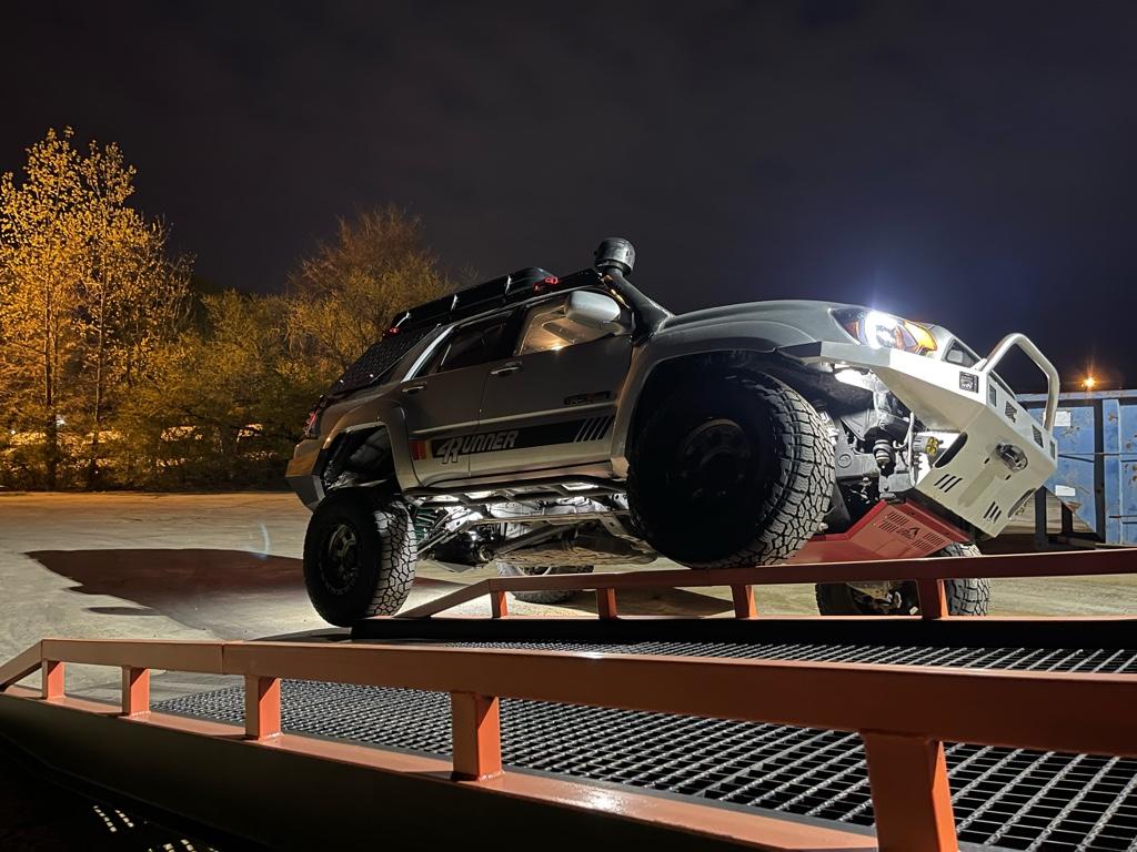

The articulation test went well. Everything is still intact and the sway bar works awesome.
I think the rear bump stops limit just a bit prior to full bump, but I think I’m willing to live with it to be on the safe side. This is static loading and not dynamic so I’d rather have some give left.
I maxed out the loading ramp.. the front tire still had a bit more to go until the bump stop.
Next step is to verify all this off-road.. but so far amazing
