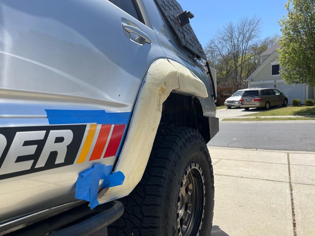

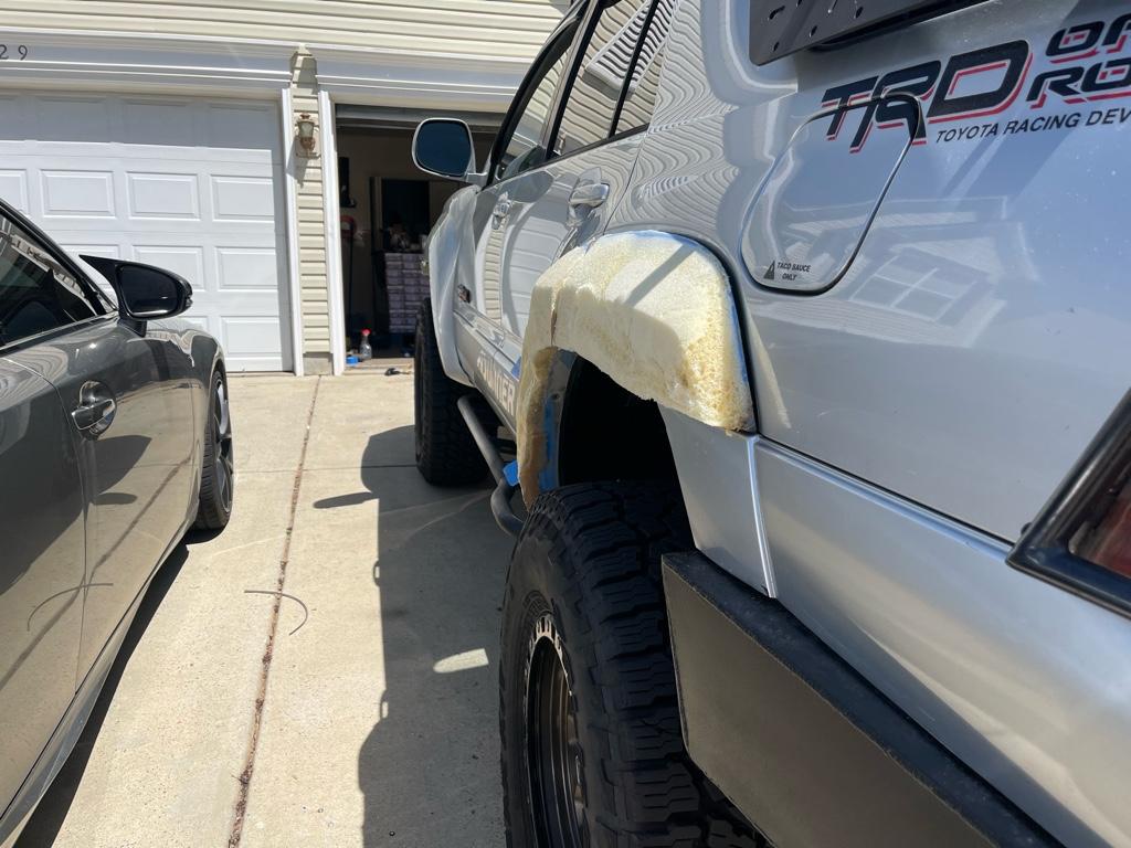

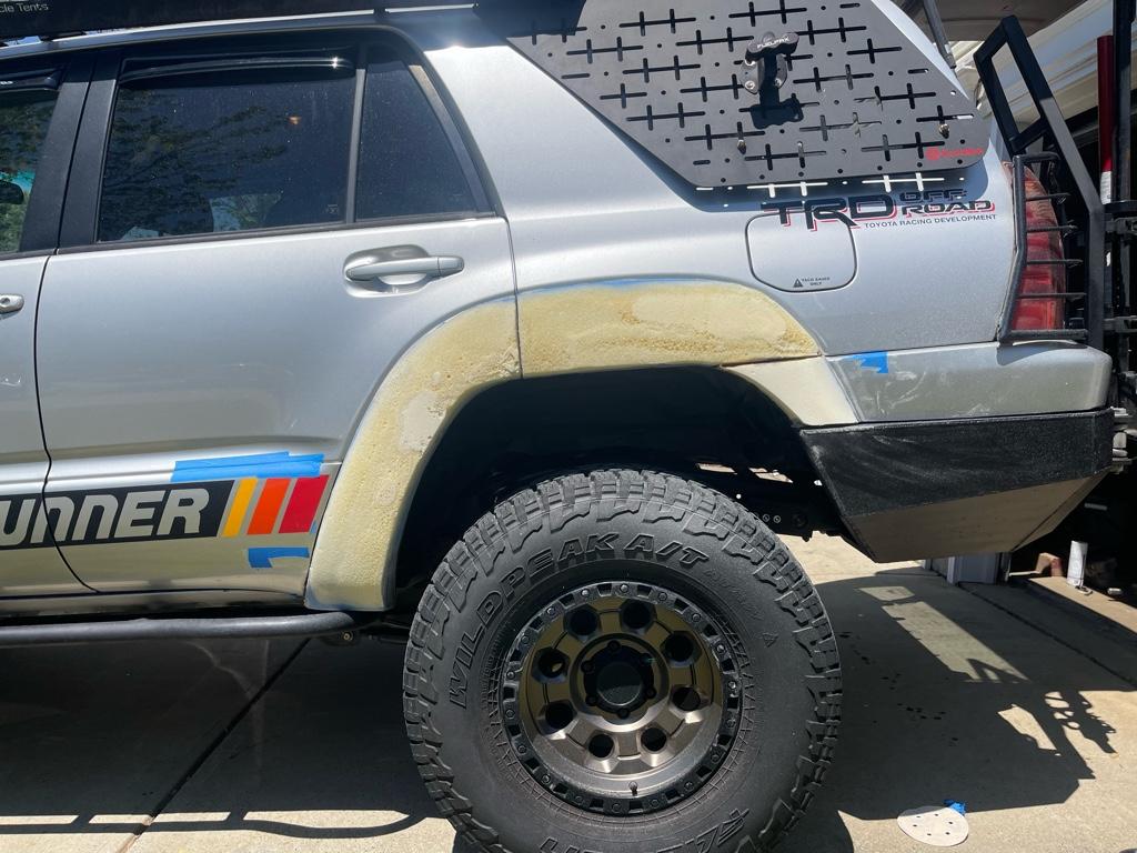

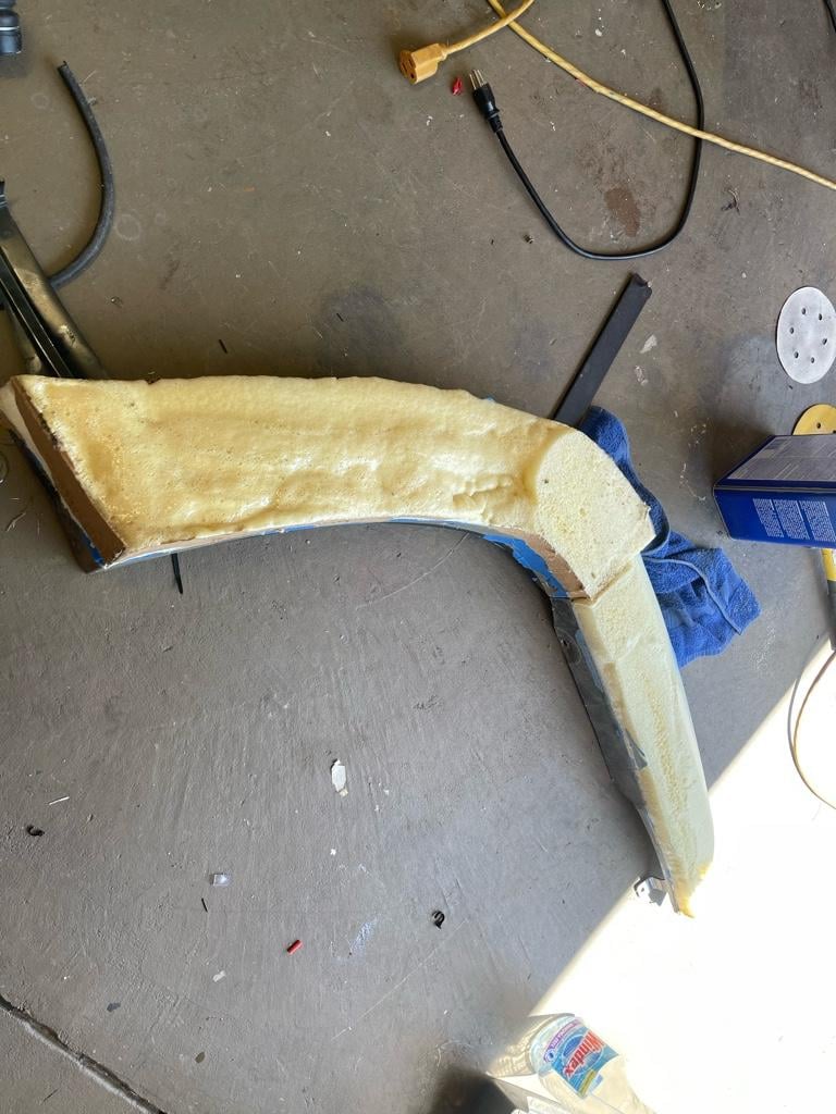

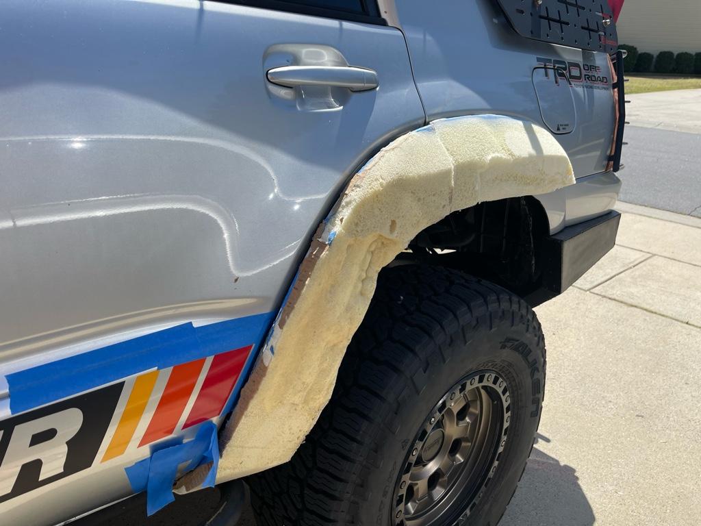

Modifying the shape to a different style is more labor intensive than I had thought.. so what I'm doing is sanding it flat with the bottom of the original flare, staying flat on the run vertically, and from there just rounding it out to the original top edge of the flare. Getting it to match the multi-step look of the front McNeil racing fenders is going to be too challenging and time consuming, not to mention then having to mirror on the other side lol. So I think I'm pretty happy with the general shape and bulge of these so as soon as I get some holes filled in and built out the small rear portion I should be able to cake it with some body filler and do a final shape-out.. or.. I may just go right into laying it with some carbon right over the top... I'm not looking to remove the foam from the inside, I want it to have some structure, so we'll see.. with a good inner structure of foam a single layer of carbon fiber would be more than enough to stiffen these. I'll need to measure and see what the final outcome is, but I think these are about 1-1.5" wider than stock.

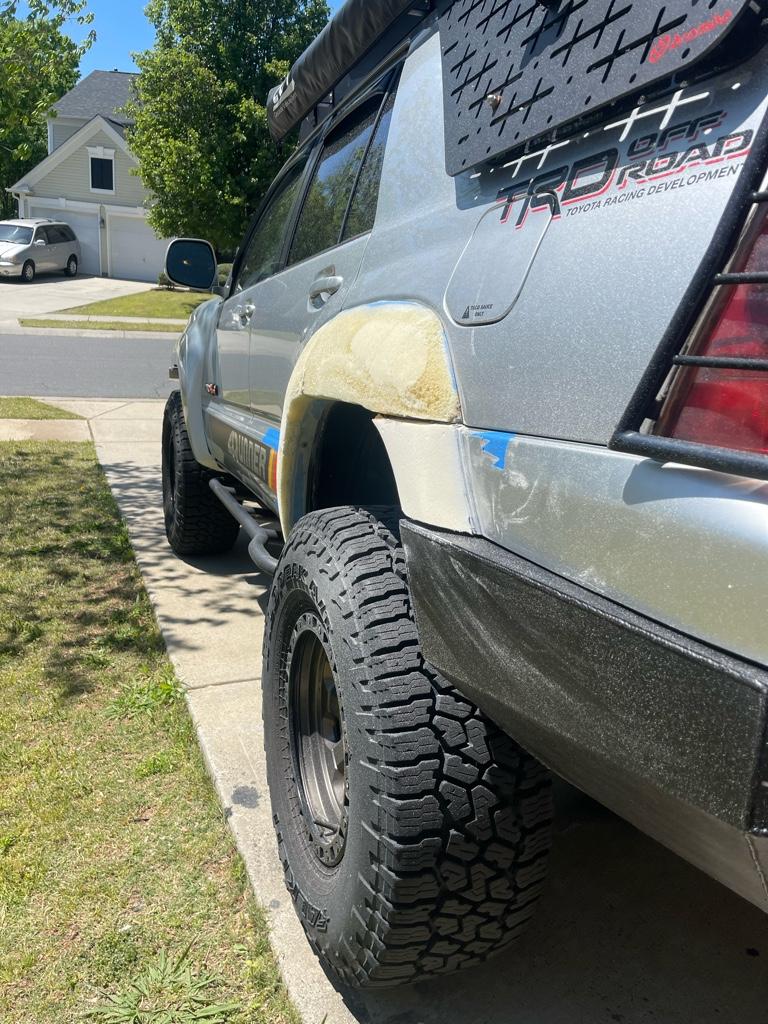

Made a bit more progress today at lunch with the last rear piece. I think I like it.. and realistically to change the shaping much from this would be a whole lot of work. My initial thought was to build in hard body lines/flat faces, but after realizing how much work it would be to hand craft a straight line into a custom foam fender flare I don't think I am up for the challenge. I elected to more or less follow the factory faces/line and just sand out to the edges top and bottom and then go through and lightly round the transition in the middle. Should be pretty easily replicable on the other side. It is about a 1.5" wider than stock and flows pretty good with the rear bumper I think. Definitely a huge difference over the stock rear being super flat. These are a lot more bubbly. How does everyone feel about these?
The foam is stuck on pretty damn good to the flares themselves.. and with how thin I have it shaved out to the edges I don't think I want to try and take it off. I could make a "shell" of fiberglass that would come off of the foam and then work on sanding the foam completely off but I really don't see a point.. I feel like what I may do is go over all of this with some fiberglass reinforced body filler and smooth it all out and start shaping the flat transitions. One thing I am not certain on is how "permanent" the bond is between the foam and the flare (not to mention I have painters tape under it so its not a direct adhesion).. so without taking some fiber glass and "wrapping" it around at least 2 edges I don't know if these will hold on permanently so I still have some figuring out to do.. It may be enough to sand through a couple of foam spots all the way down to the plastic and just fill those voids with the reinforced bodyfiller.. we'll see.
