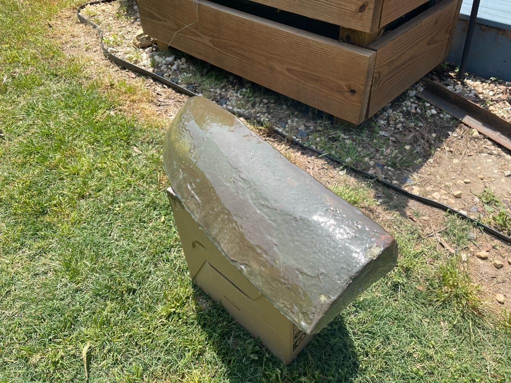

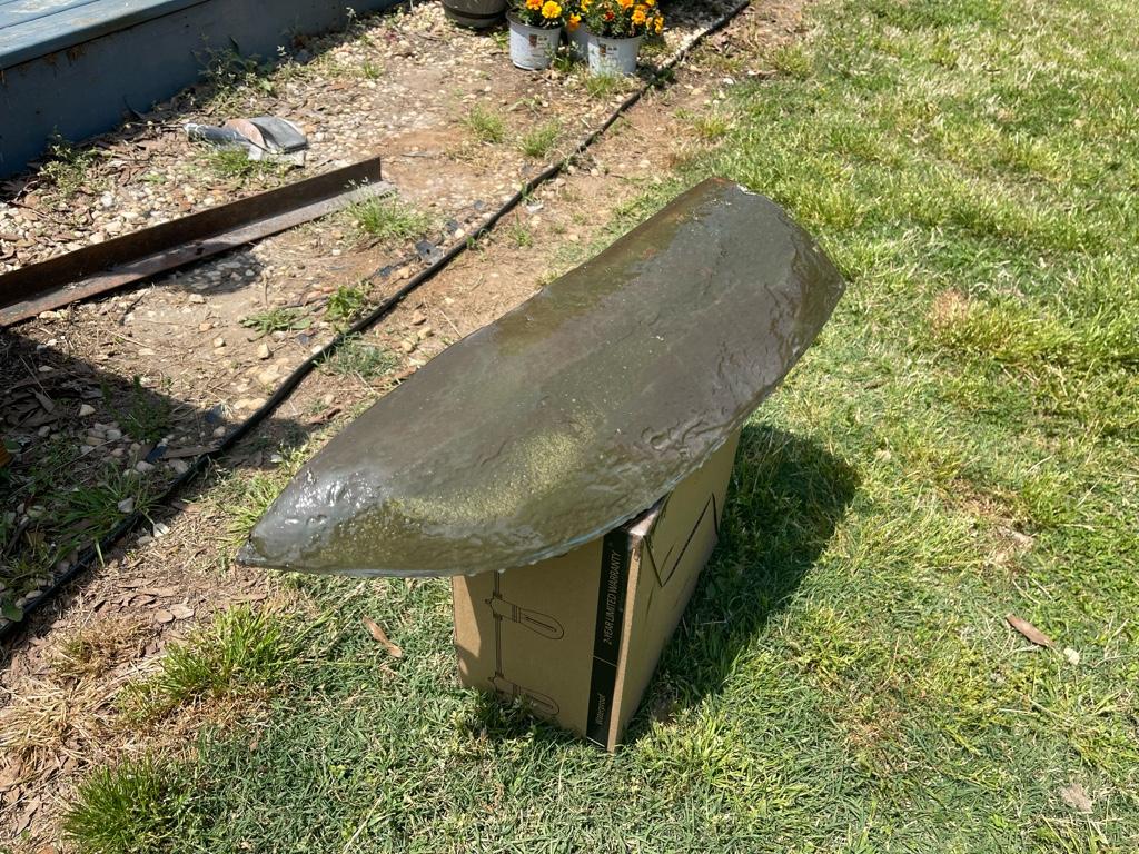

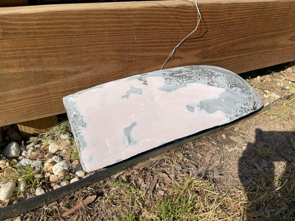

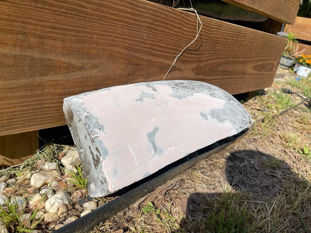

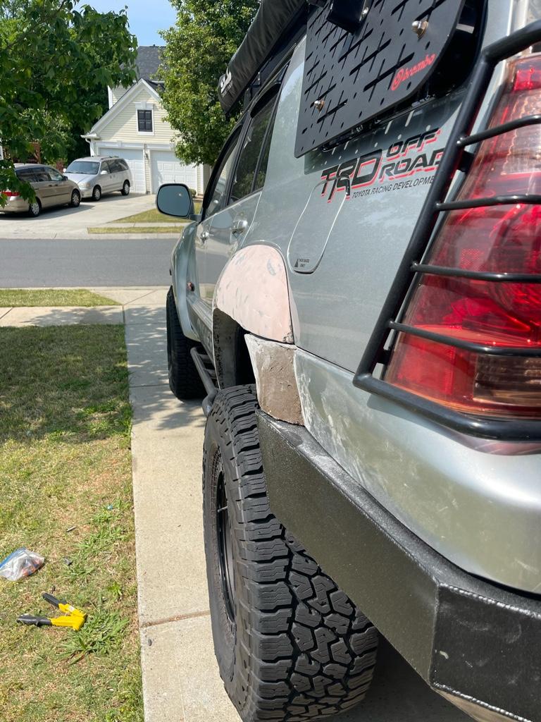

Well.. here goes nothing I guess... I spent some time yesterday using some bondoglass body filler over the foam for the central flare piece. The foam was too imperfect and squishy to try to wrap over, so I figured why not try bondo glass. It also gave me an opportunity to even out some flat spots and build in a rough hard edge all around.
I made the decision to use carbon fiber (since I have a ton of material left over from other projects) instead of fiberglass in hopes that it will give me a smoother, closer to finish surface once it is hardened. Fiberglass is great and cheap and fairly quick to work with, but it leaves a super rough surface to have to sand through and even out and I'm really tired of sanding.. lol.
I have the piece coated in epoxy resin now and allowing it to dry to a tack so that I can easily lay over the carbon material and allow it to cure over night. The plan after this is to just do a single epoxy layer for build-up and then start doing final shaping/finish with body filler. I want ot keep the amount of body filler to a minimum in case I band these against a tree.. I want the cracking to be to a minimum and the carbon fiber and foam beneath can be quite forgiving when it comes to flexing and not breaking. If this goes well I should be in good shape to finish out the other two pieces and then start building out the other side and hope like hell I can get them looking close :)

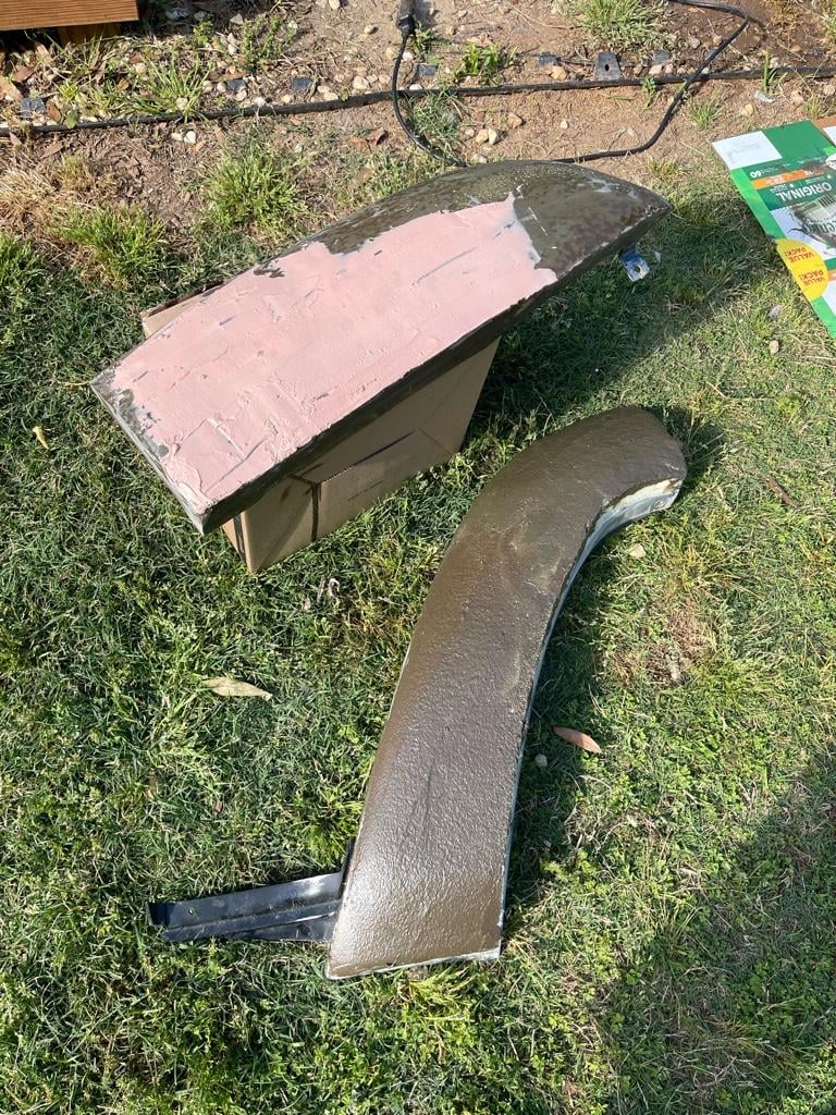

I decided that I’m skipping the fiber glass/carbon fiber layer and letting the bondo glass filler do the work.. it hardened super hard and I think will be just fine as is. This is going to save me literally days of work with laying fiber glass and sanding it down.

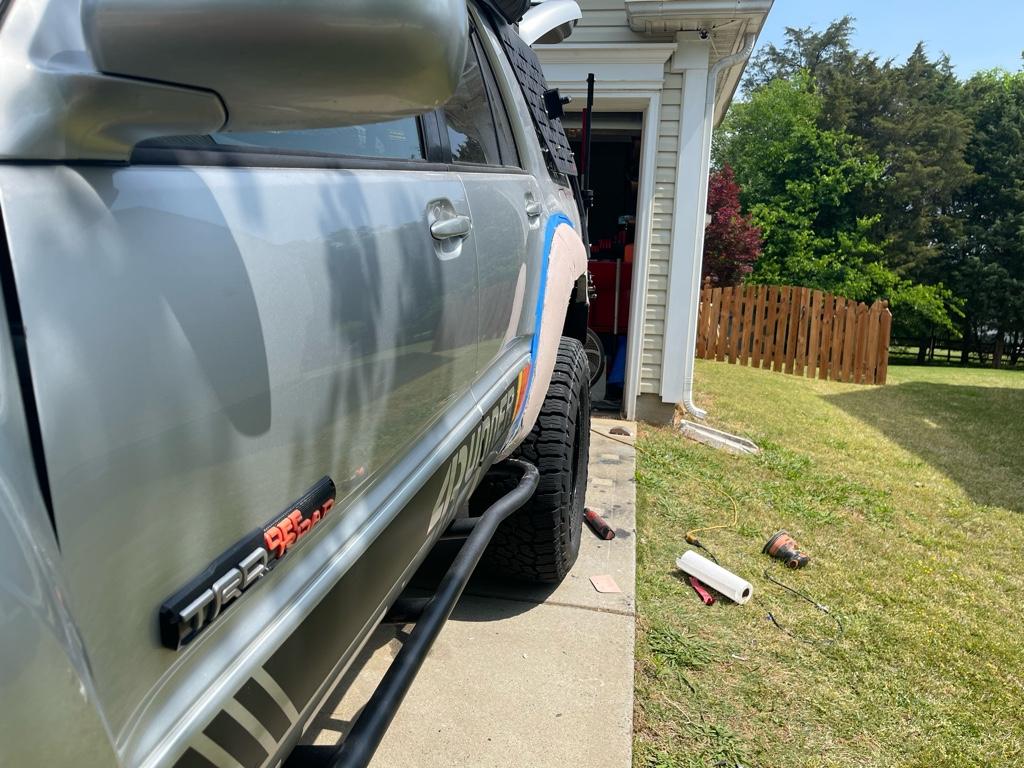

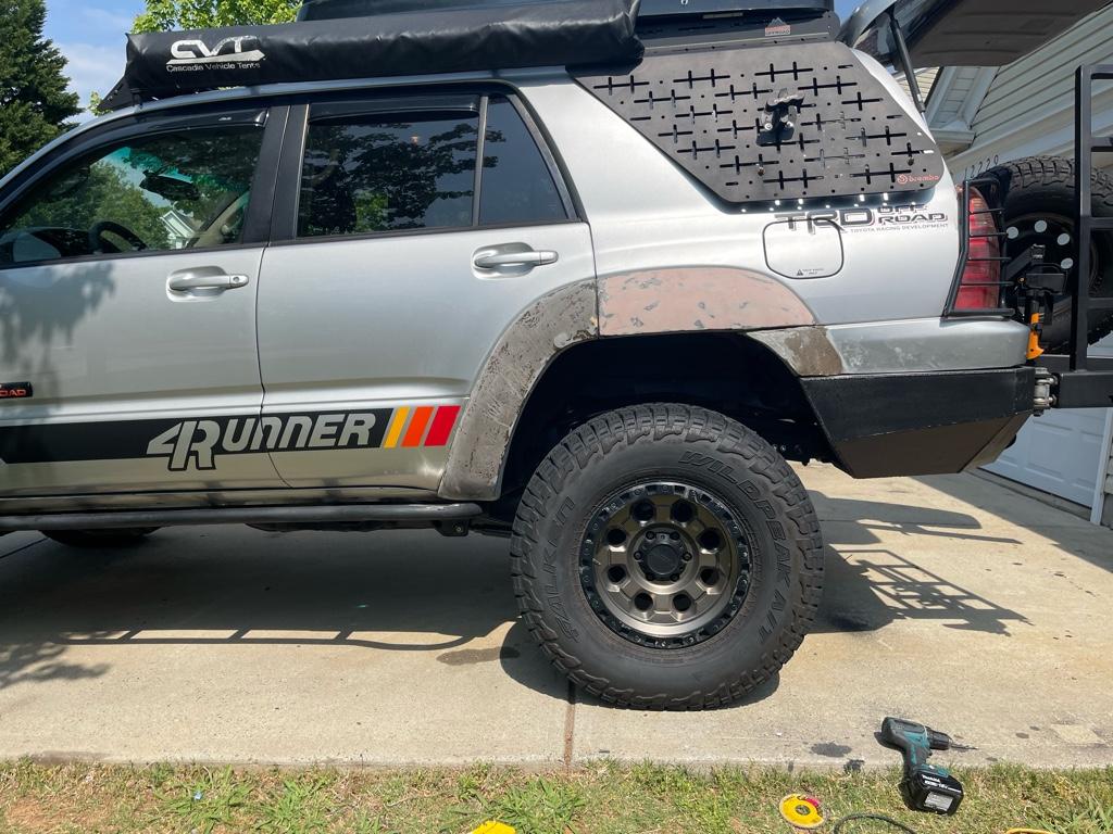

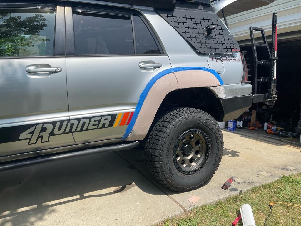

The door piece is drying and looking promising. The quarter trim is already into the first layer of body filler. Definitely a lot of work to do to get it perfectly flat and straight, but coming along decently quick. If things keeping going at this rate I may have the drivers side ready for paint in just a few days.. need to go and get more body filler, this is definitely a lot of surface areas and filling to do.

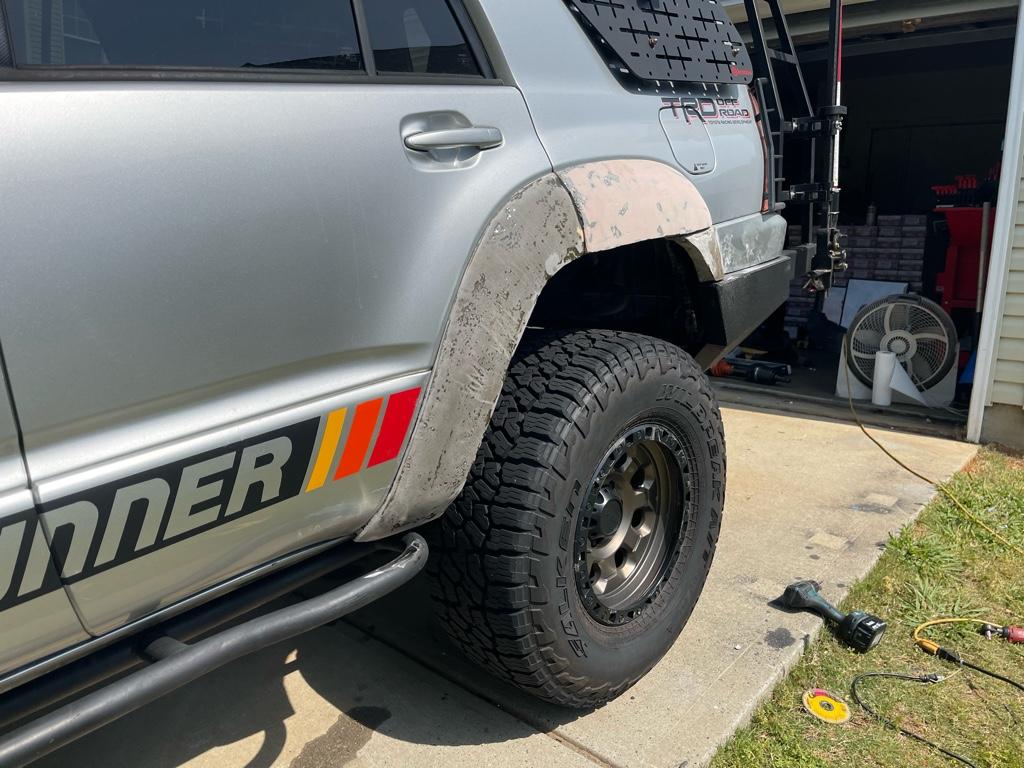

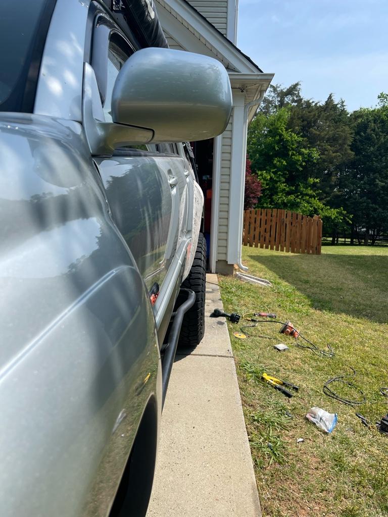

Slow and steady wins the race. Very slow.. but very steady. Got the flares hard mounted to the rig today and started with the body work. There’s a lot more left to do.. a lot of sanding and filling and sanding again..

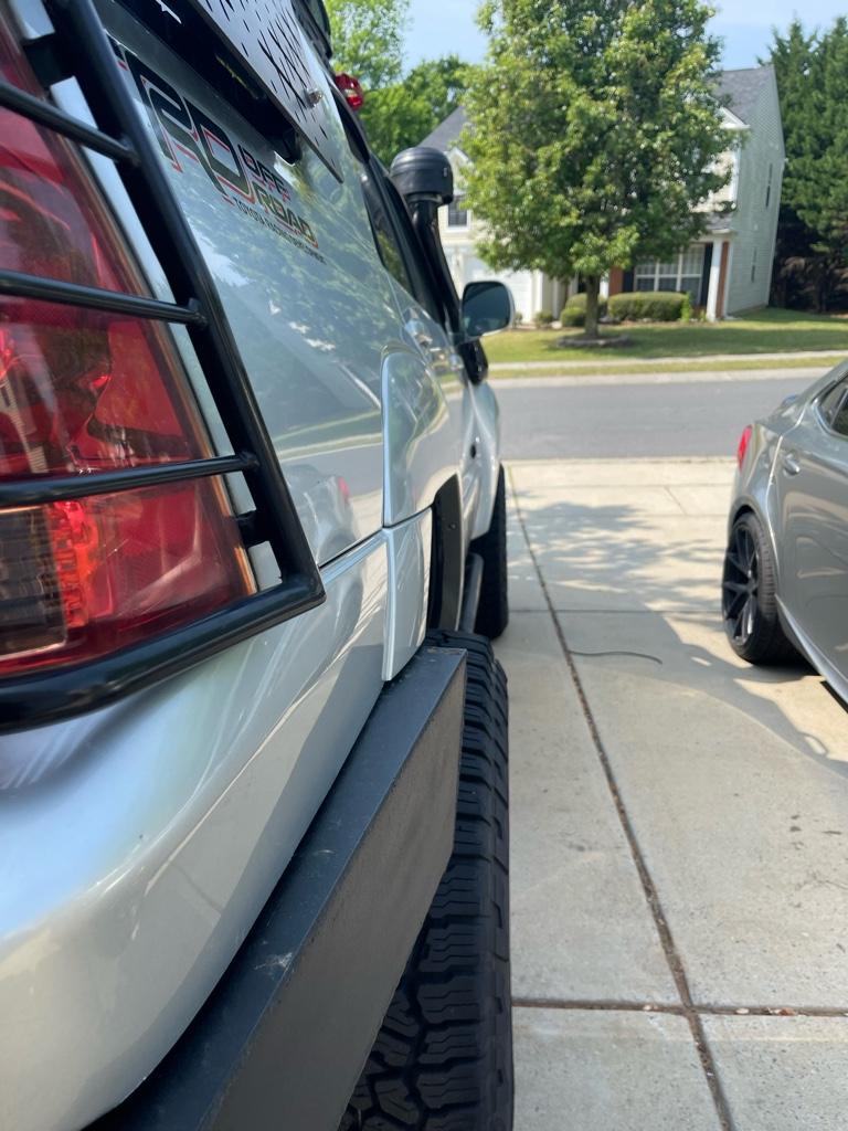

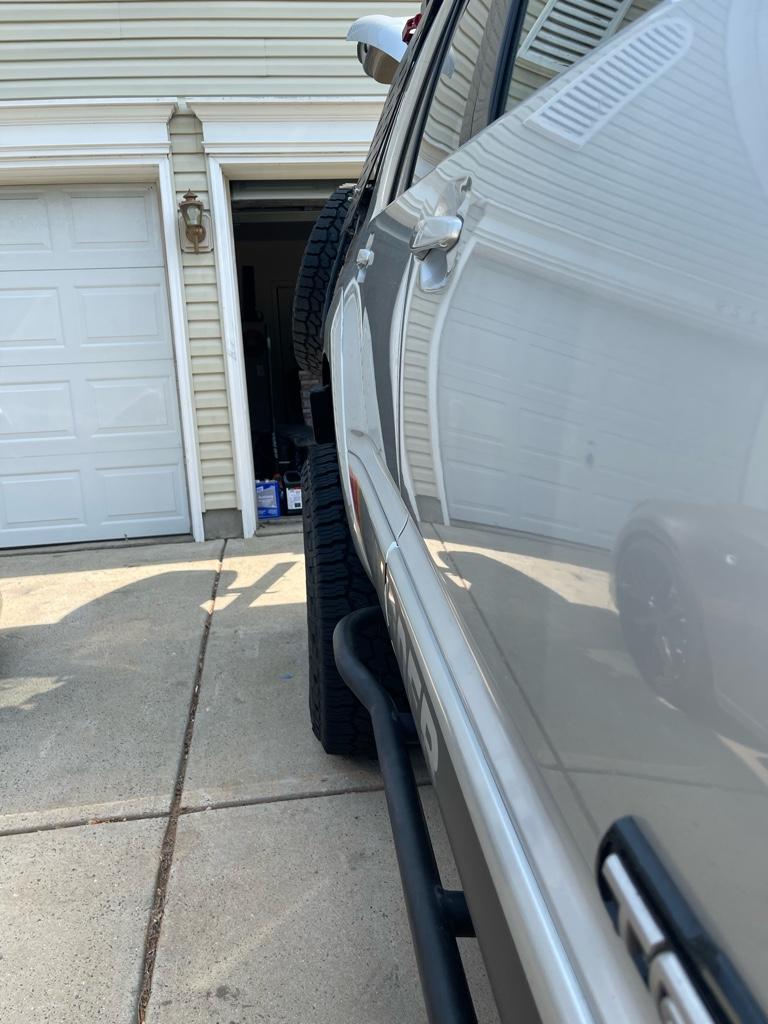

These came out different than I envisioned.. not the hard line, steep kick out like the fronts.. but.. it is amazing how close to stock these look shape wise. Other than being almost 2 inches wider the general shape is pretty much identical to the factory flares. What do you guys think ?
Found out that the small sanding block I have is too small to properly block a panel this size. Keep developing areas of recess because the 4 inch block follows the contour too easily. Have a 12 inch block on order with some 100 grit paper for tomorrow. It should hopefully let me get the transition between the pieces nice and flat. This project is definitely not for everyone and is borderline outside my grasp of ability. But it’s coming along pretty good.
I’ve thought about how I could replicate these once they are complete and just don’t know if it will be possible or not.. At least not very affordable. I would have to create multiple molds, which would be very large. And then figure out a way to have these attach to the factory flares. Because I’m using expanding foam directly to the factory flare there is no back to these that can be easily adhered to the factory piece and it would still be an involved project to mold the wider flares to the factory ones. Long story short.. even if it was something I could tackle I would price myself out of being able to make another set for someone because it would have to be financially reasonable for me to undertake, which would most likely make it unreasonably expensive for someone to buy lol
