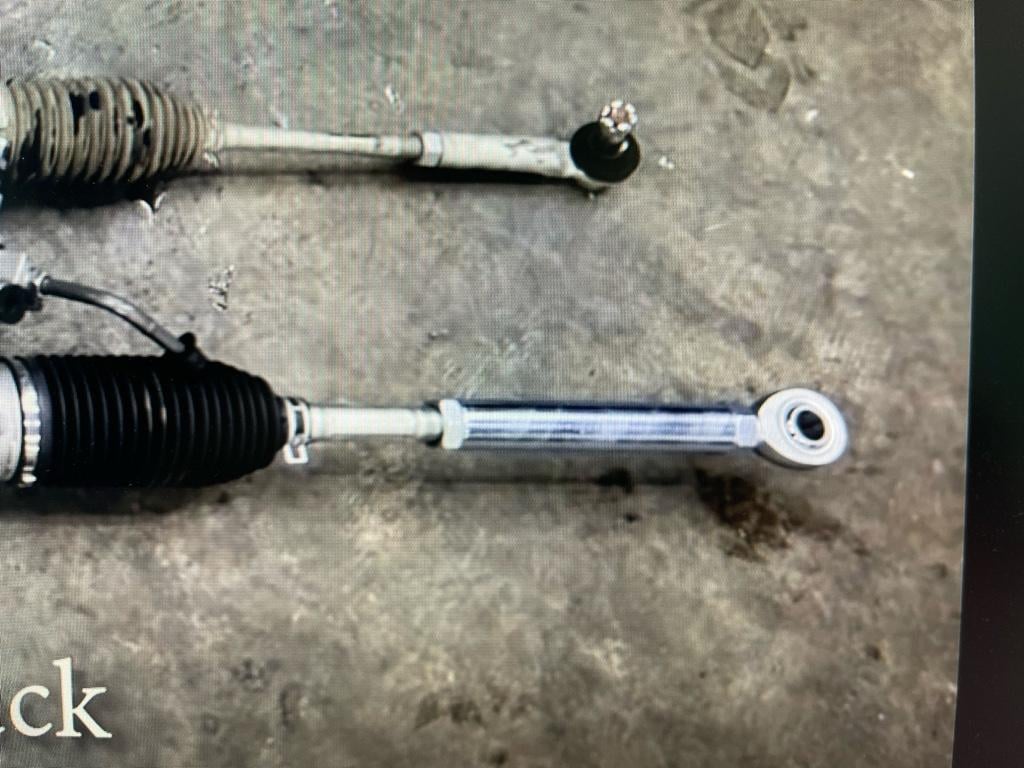

after pulling a few more measurements and doing some thinking I decided to pull the trigger on the diy heim outers.. for this LC200 rack.. I'm too deep into this thing to try and change course.. can't necessarily afford to go the proper LT route that I want, and don't trust my current rack/tie rod combo to last very much..
I bought some 1 1/2" OD .375 wall x .750 ID DOM tubing, 6 in piece. I estimate that for the cut down tie rod size I only need 3 inches at most.. I then also bought a 7/8" x 7/8" heim joint kit from Ruff Stuff. I went with a 7/8x3/4" high misalignment spacer so that I can run 3/4" hardware to get this mounted to the knuckle. So far that is $177, and I still will need to buy a 20.5mm drill bit ($15) and then hardware , probably another $30.

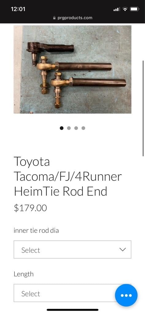

Have you seen these? Prgproducts.com
got excited at first, and then realized that it wont work. These are for the factory rack.. so if you wanted to get rid of the factory outer these would be great. The LC200 rack is 22mm diameter threaded shaft vs the 15mm for the 4runner rack. This is however exactly what I am trying to accomplish so it does give me a better peace of mind that it should work with minor issues.
I'll also mention that the price point is right in line with what I will be at when everything is said and done.

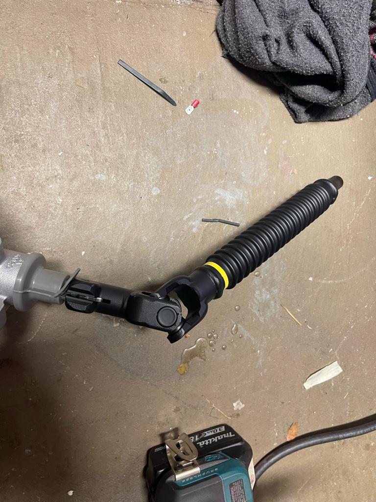

The lower steering shaft delivered today. So nice to have fresh, OEM parts.
With that said.. can someone explain the ribs on the shaft to me please...? I was baffled when I found out this wasn't a rubber cover but rather very hard material instead lol
my guess is its an easy place to have a guaranteed failure to prevent the steering column from spearing the driver in an accident
That and maybe vibration damping. It definitely adds a little weight to that section, and with a series of bellows it might disrupt varying frequencies.
Just saw a video on the RCLT install using a lc200 rack, and looky looky, they’re using the same idea for thr outers lol , I feel much better. Theirs is 3.5” longer than mine will be, but the ideal is the same

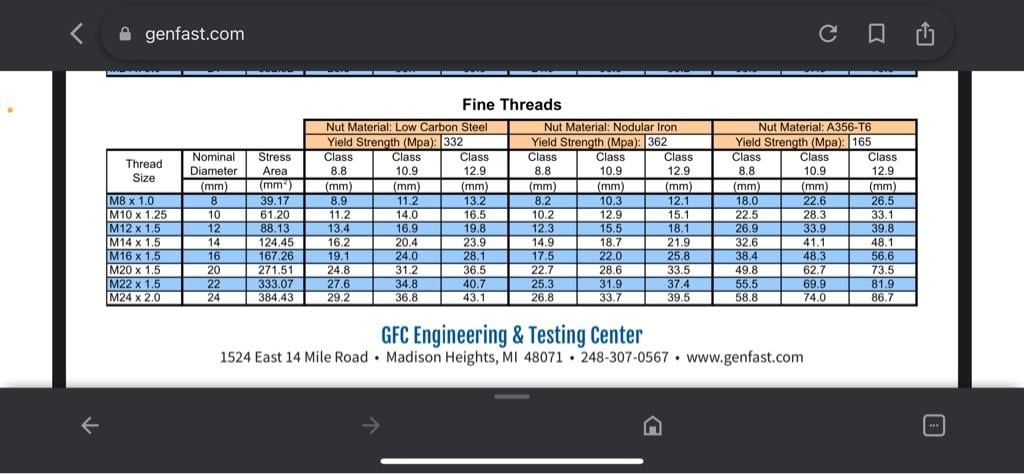

Yesterday I confirmed the thread size and pitch of the LC200 rack tie rod threads. The inner-to-outer tie rod thread connection is a M22 x 1.5 for anyone curious/interested to know.
Luckily we already have a pretty nice tap/die set at my dads garage, so between that, and the 20.5mm drill bit I just got from amazon I should be in good shape to start fabricating the outer rods as soon as the DOM tubing from metals depot shows up. I have a feeling it will end up being a VERY short tube since the heim joint and weld-in bung will add quite a bit of length alone. I'm hoping I can have at least 1" of thread engagement to the inner tie rod since that is about what the factory LC200 rack came with, maximum engagement all the way turned in yields 1.5" of engagement but I think that is excessive.. realistically even .5-.75" should suffice, but I need to do some thinking on that and see how much room I have to work with within the DOM tubing itself prior to bottoming out against the heim.
Edit* looks like for grade 8 hardware for an m22 x1.5 thread you’re shooting for a little over 1 inch for min engagement, so if I can get it closer to 1.5 I should be perfectly fine. The steering system will never see the type of forces that would make the threads of this size fail even at 1” but I like a little safety factor lol
I'm no expert on threads but from what I've learned the first 6 threads hold all the force in tension. So any further thread engagement imo is meaningless regardless of bolt size or thread pitch. For rough estimation I assume you can also use a bolt's nut length to determine minimum thread engagement for that bolt, or also the rule of thumb of 1x the bolt's nominal diameter. I think they make the majority of standard sized nuts with 6 threads or at least that's what makes the most sense to me if my info is true. Just some info I've found interesting, I think you're on the right track.
That is a very good point. The lock nut for the tie rod on the m22 x 1.5 thread is only 1/2" thick. Now granted one could argue the lock nut is only used to keep the combo from turning, but to your point.. if you were to use this size nut/bolt combo to actually fasten something together, the nut is still 1/2" thick and regardless of how many threads the bolt has ends up being your lowest common denominator. I'll feel plenty good with anywhere from 3/4-1" engagement just for peace of mind :)
