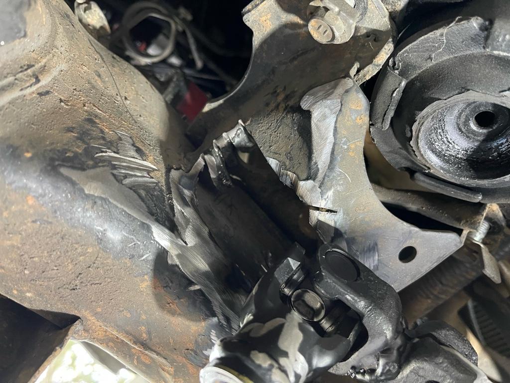

Damn, Not lookin forward to the steering shaft fix.
DocME in the FJ forum has a pic of his patch for the MM clearance, if you haven't already seen it.
Maybe he has a couple tips...
Just curious, you have a body lift on your Runner?
I do, 1.5 inches I believe and yea o saw his pics that’s what prompted me to don mine .. I’m guessing you haven’t fitted your steering shaft yet ?

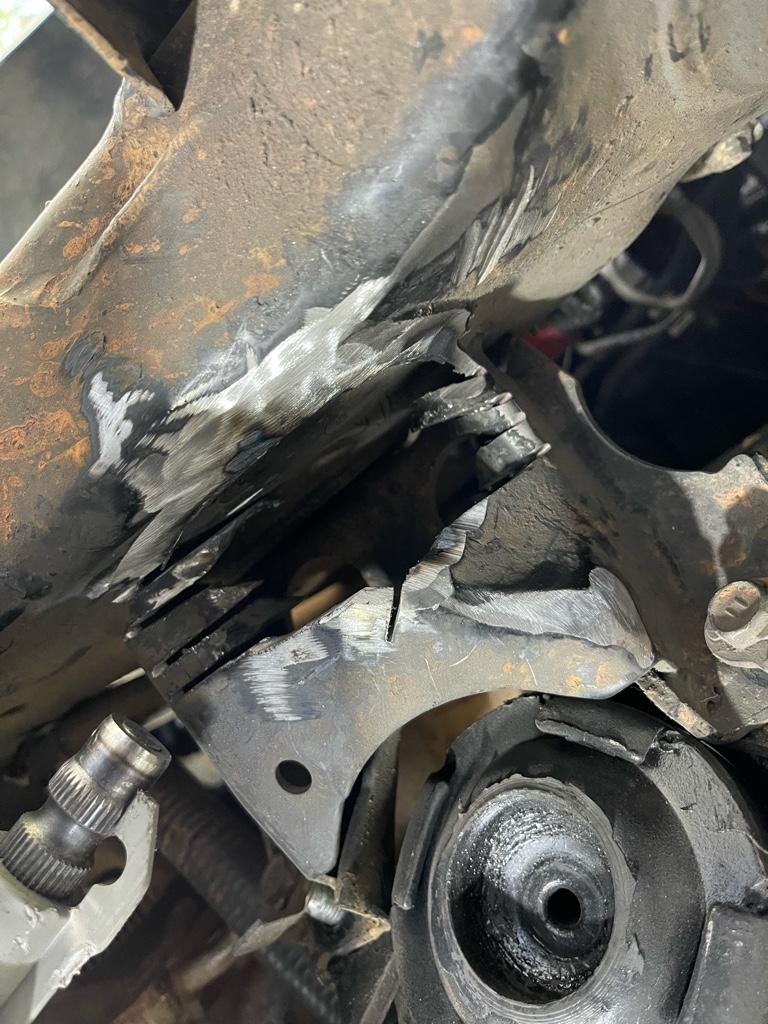

Just for a quick test fit, enough to know it's probably not going to clear. Wondering if the body lift (1" on mine) creates an angle that affects the clearance.
I think if you mock everything up, you can probably mount the rack further back, and get it to clear the MM, but the tie rod may contact the CO.

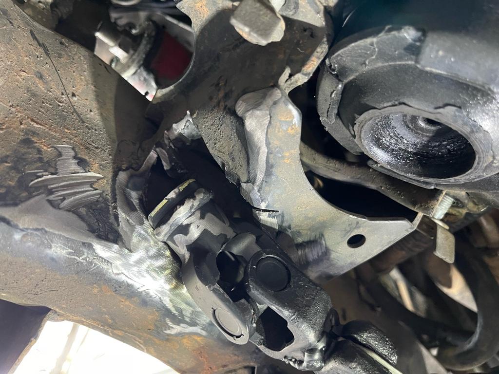

I don’t see a way to clear the mount by pushing the rack back, it’s very minimal that it could move back and the risk of hitting the coil over is not something I’m willing to take. Modifying the steering shaft is certainly a ton easier I feel like (plus I already started :rofl: :rofl:)

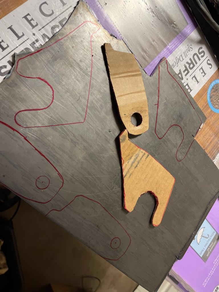

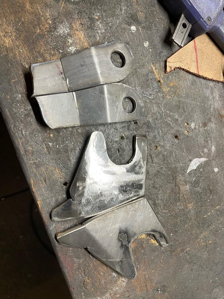

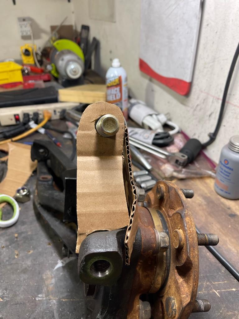

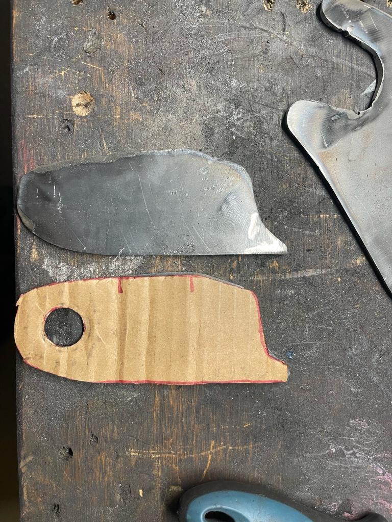

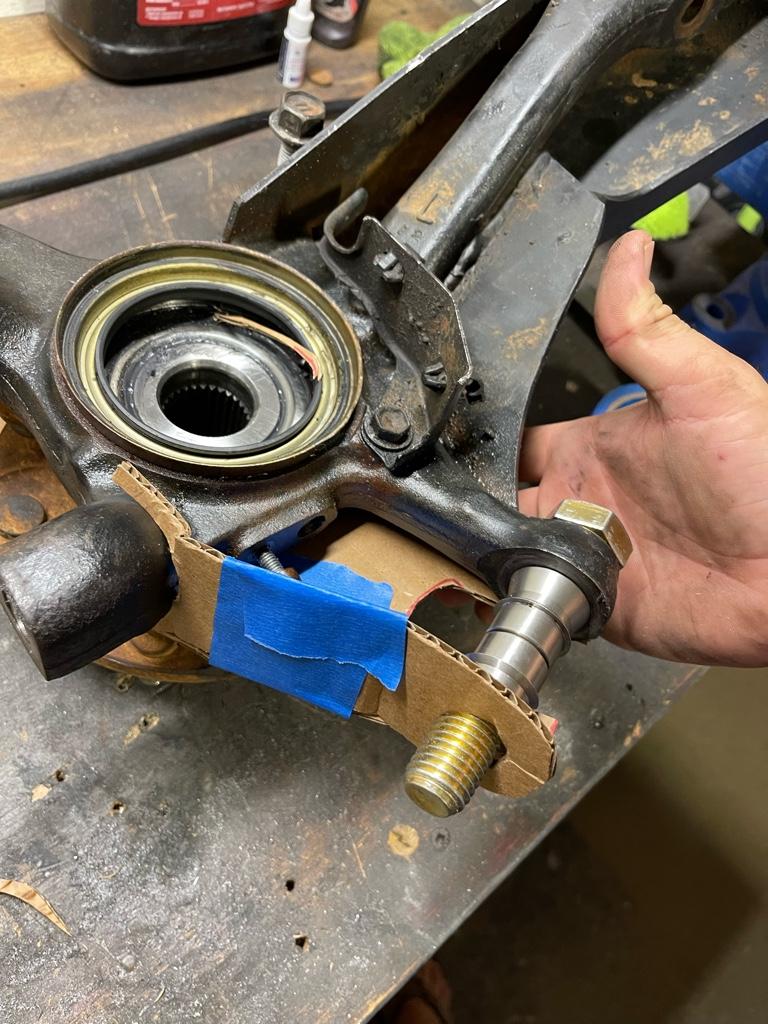

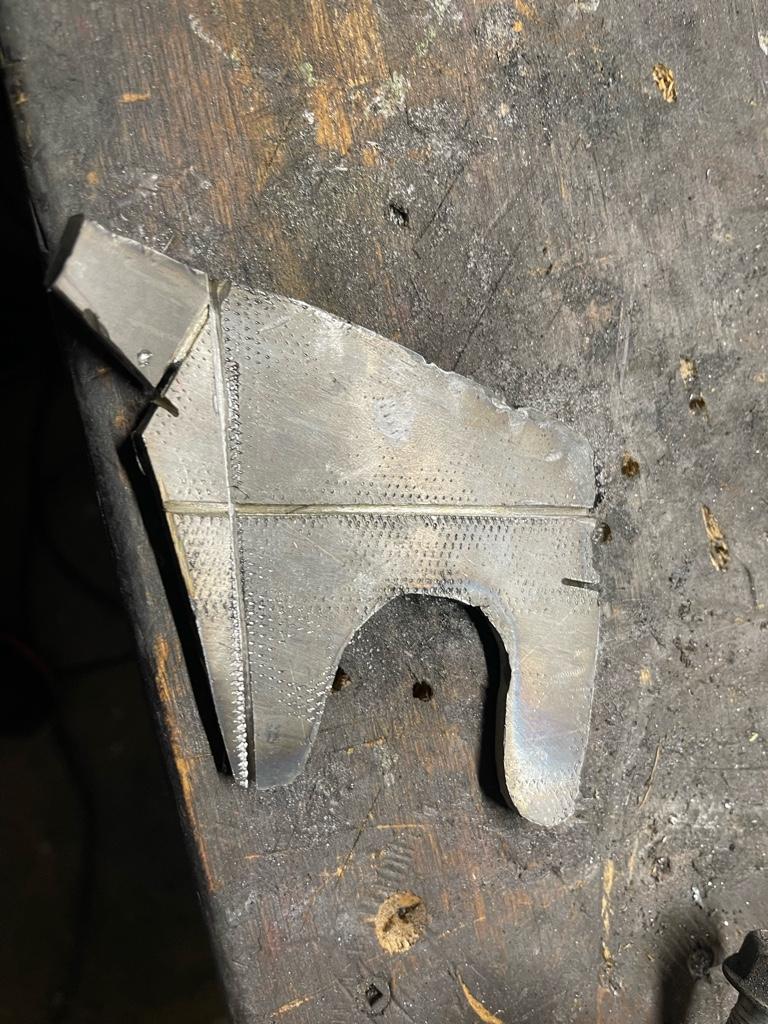

Thanks in the double shear ! Hoping to make a few adjustments to the board tomorrow and do a test cut with the plasma torch.

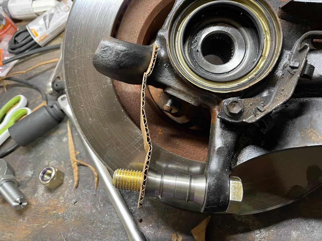

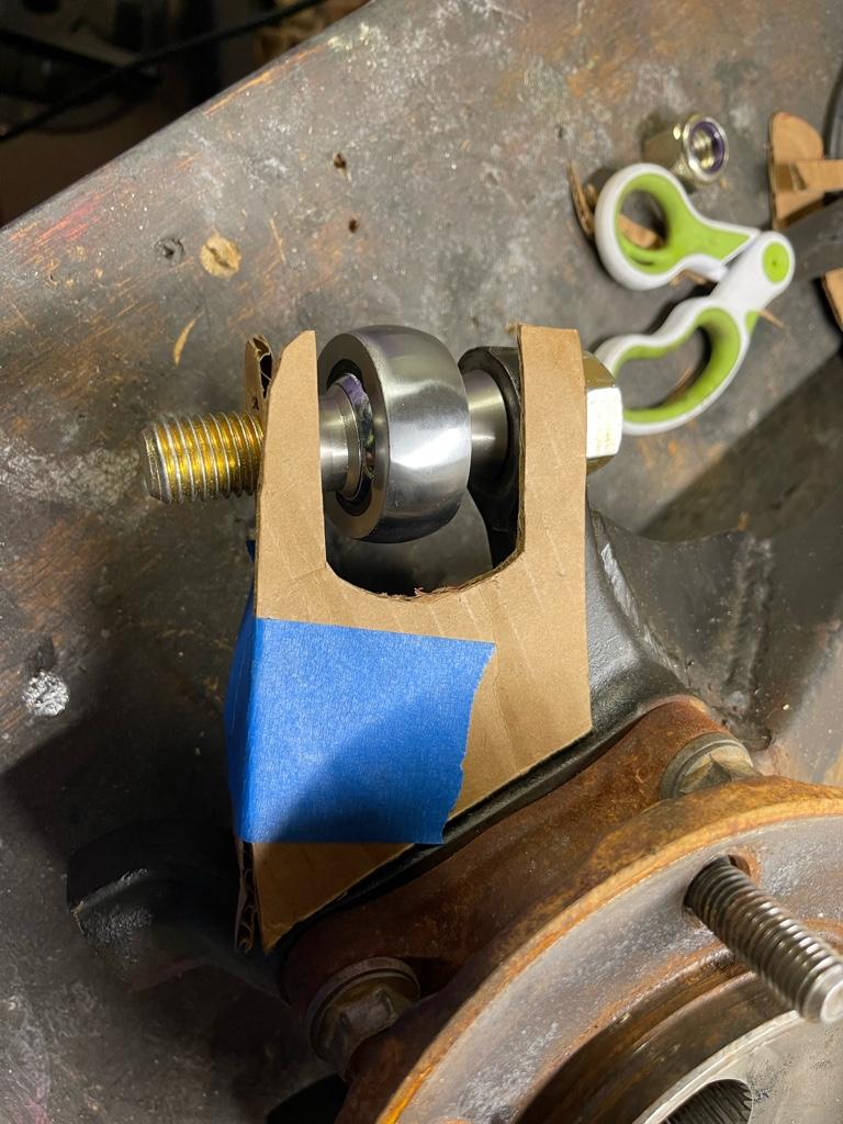

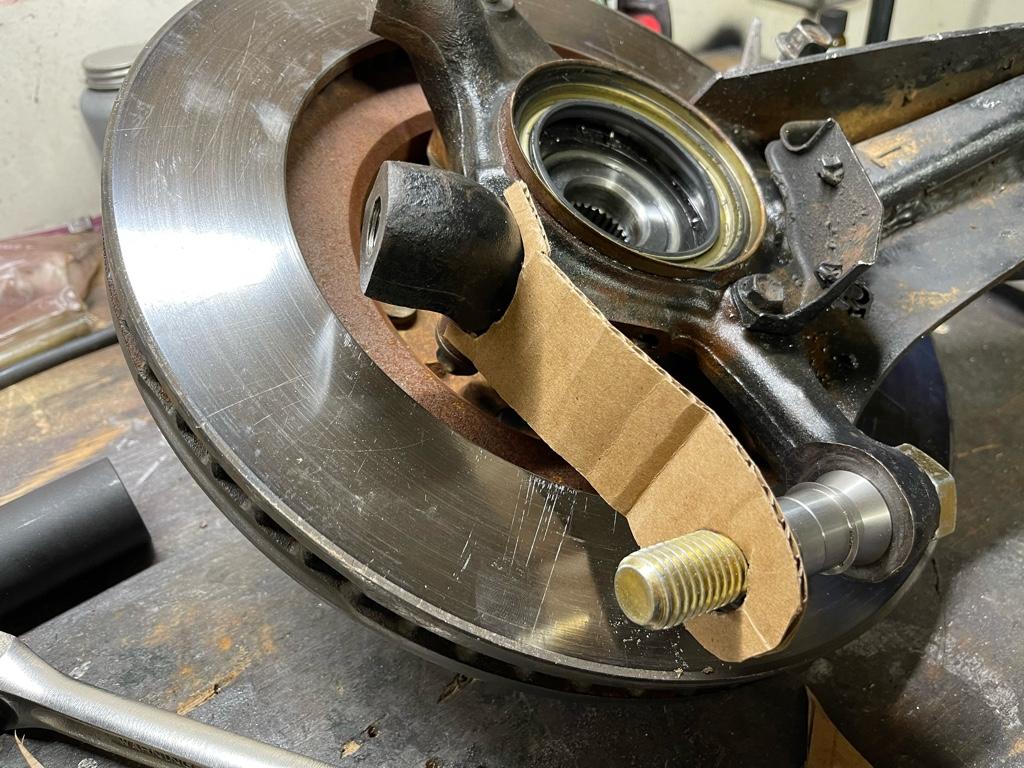

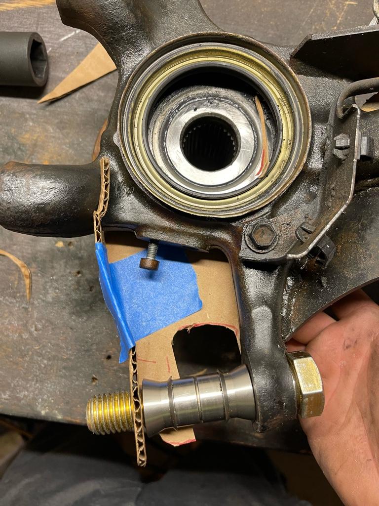

Template 3.0 should be fairly close.. I think it’s as close as I can get flimsy cardboard. Got them laid out on my flat sheet and will attempt the first set later today. At first I thought too thick.. but just so happens to be the exact thickness of my cardboard template so should work out ok. The bends should be fairly simple… one on the vertical plate and two on the horizontal.. tempted to use the plasma on these and clean up with the flap disk.. but I’m pretty terrible at freehanding the torch so we’ll see.. may end up just making more messy noise with the cutoff wheel instead .

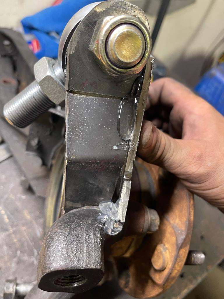

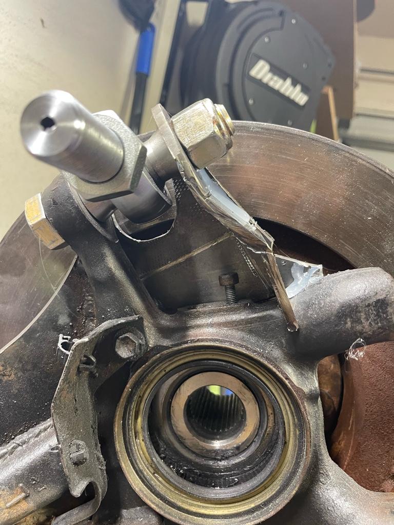

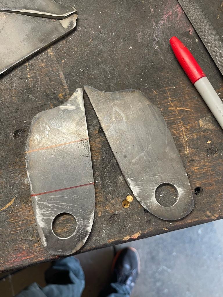

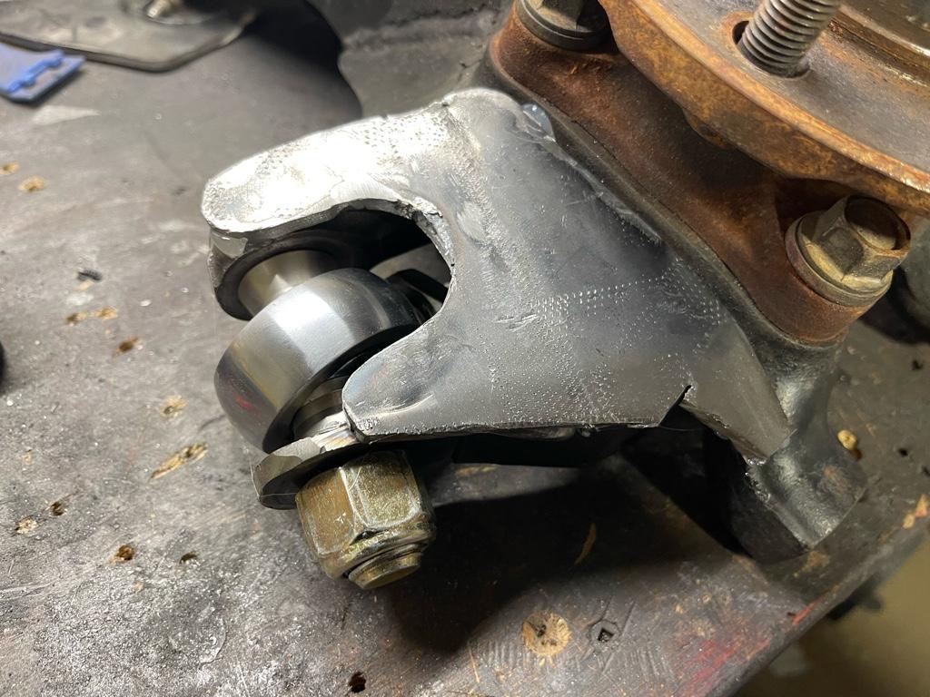

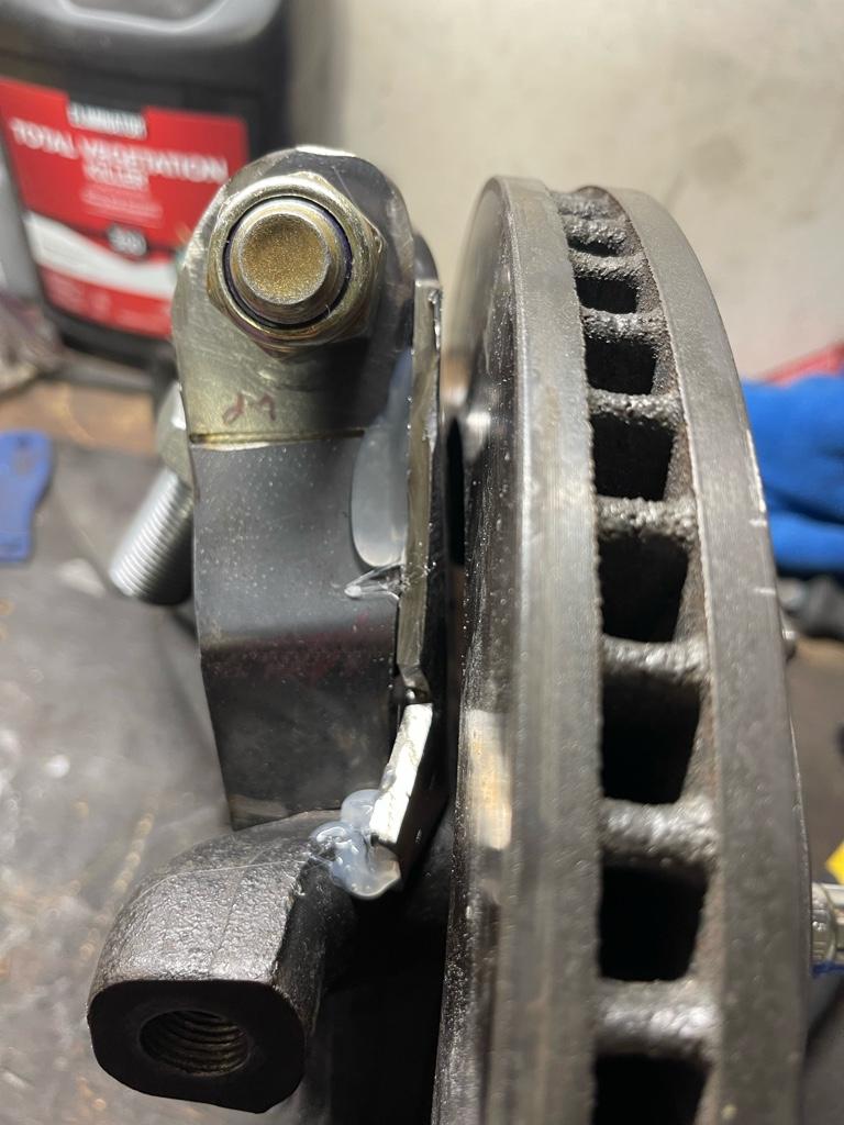

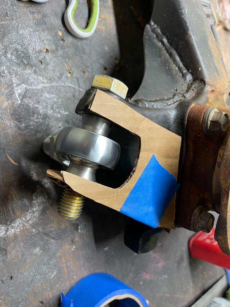

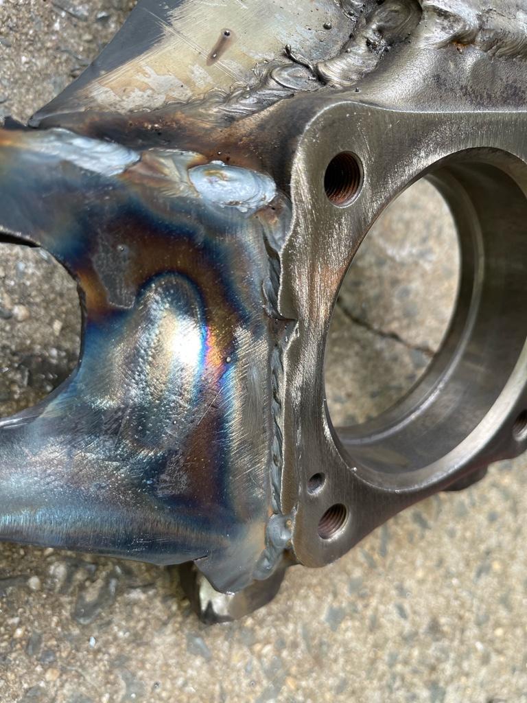

I’m a few hours into this now but making progress. The first round at the metal template cutout didn’t workout due to interference to the rotor, some pretty sever interference. So I had to trim down the brackets and beat them into shape. Using hot glue I got it to sit in place and I think it’ll clear everything. Unfortunately I don’t have the sensor with me to make sure it also fits.. but worst case I’ll just blow a hole into the side bracket for clearance. This should do OK as long as I really burn this bracket into the spindle.

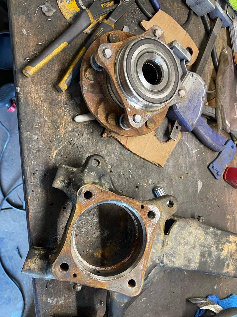

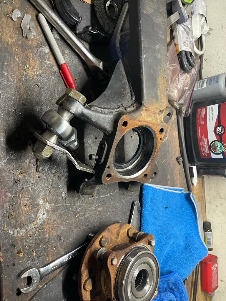

Had to pull the bearing so I can weld these later, but probably would have anyway to clean up all this surface rust and give it a fresh coat of paint before putting it all back together. Going to tackle the second side tomorrow and see how close I can get it replicated.

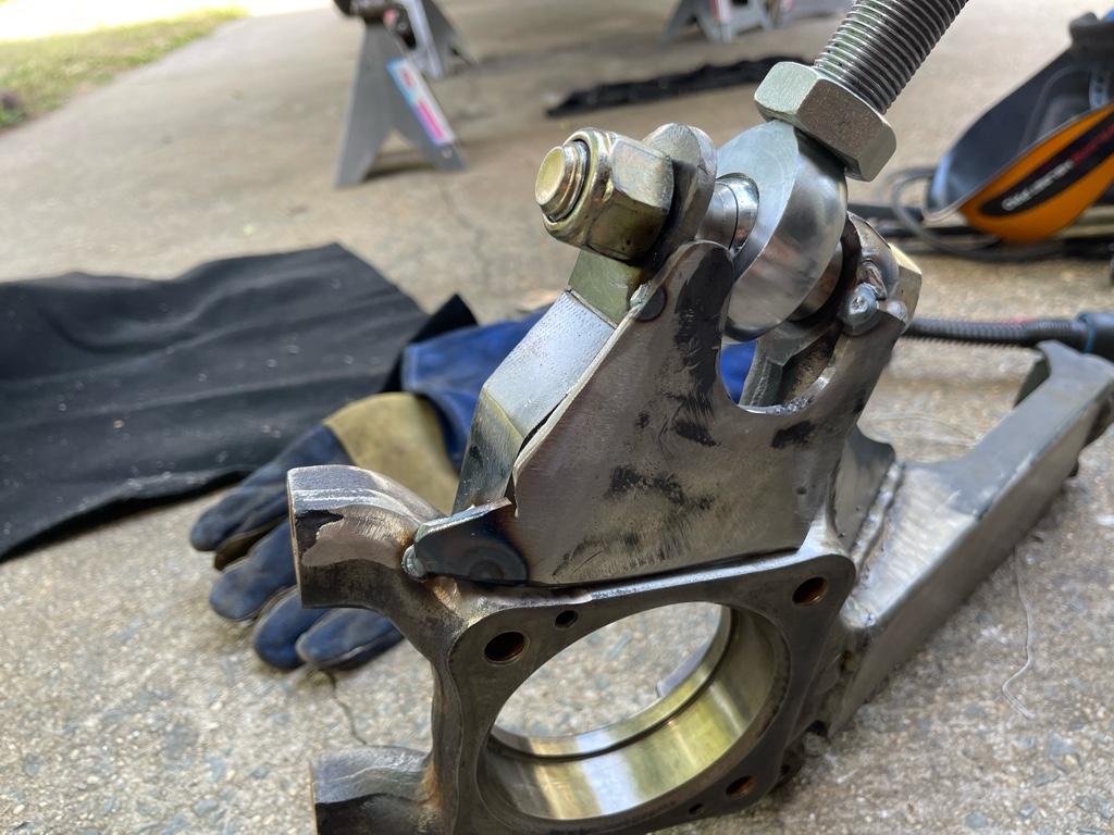

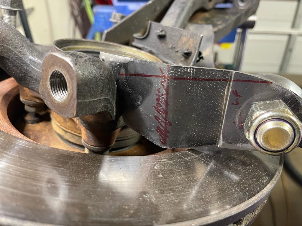

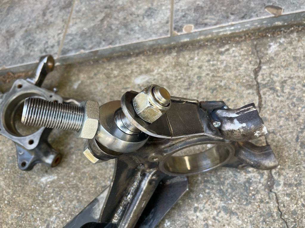

I was just browsing my pictures from the double-shear brackets Im making and something about how unprofessional it looks bothers me lol. I will definitely take the cutoff wheel and flap disk to it ahead of welding this bad boy on this week. Comparing the my pictures to the purchasable kit I see where some of my difference came out.. my bracket runs just about to the top of the original pivot arm, their bracket stop about mid way and is a bit shorter. The bottom bracket they have also ties in closer to the sensor mount, but I elected to make mine as low as possible since I have clearance to the rotor and it doesn't hurt anything but does give me a bit more wiggle room inside to weld and mount the sensor.

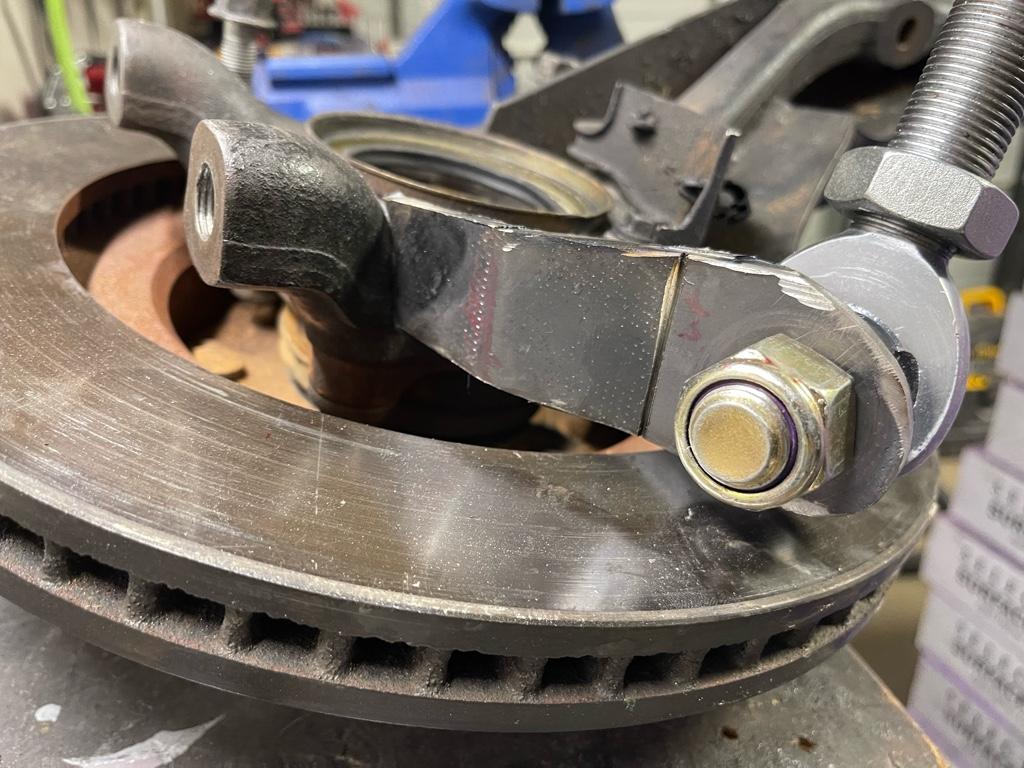

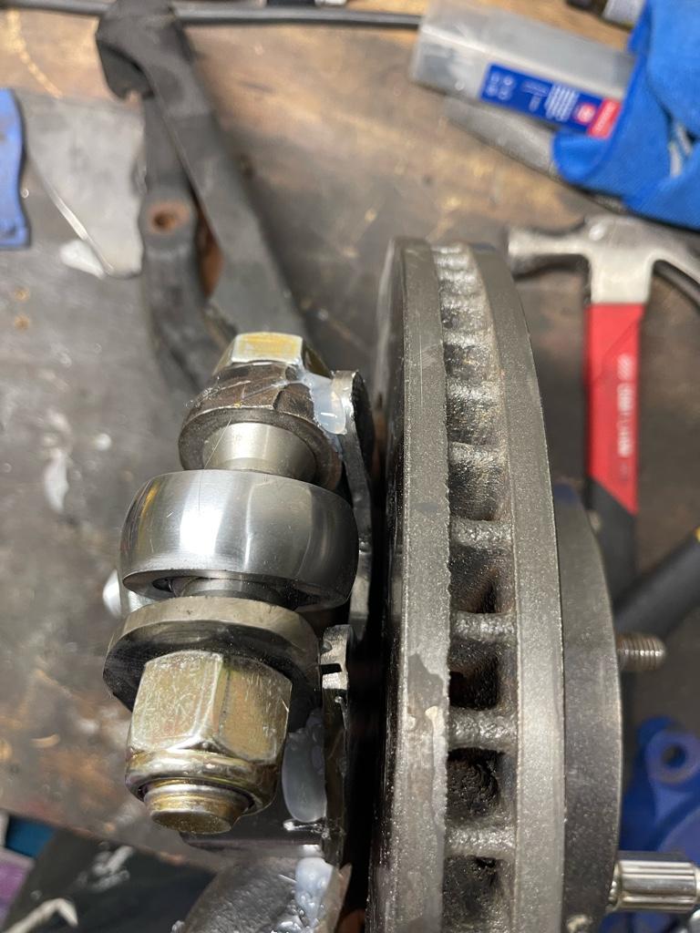

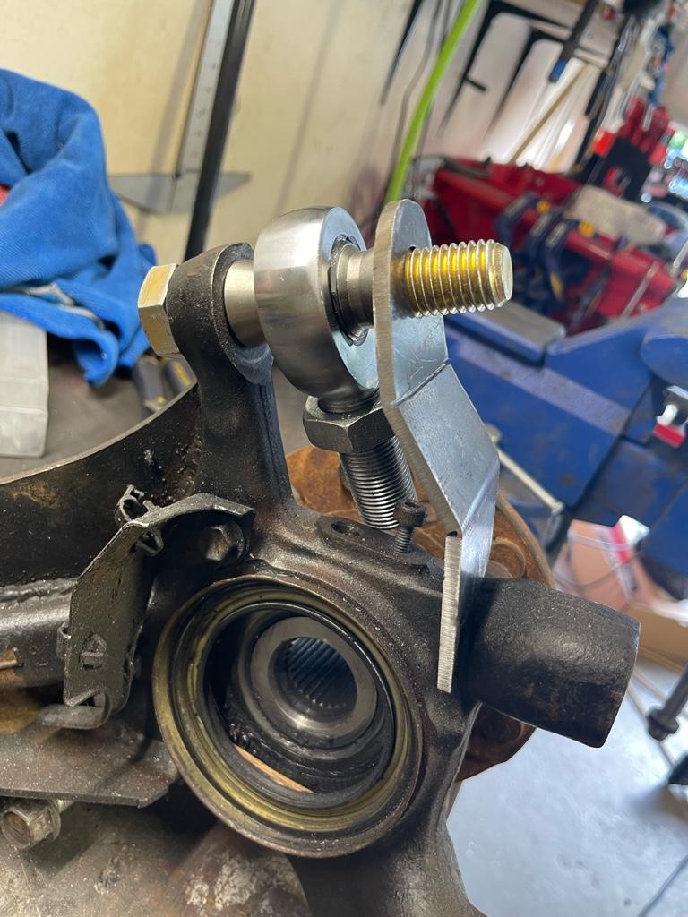

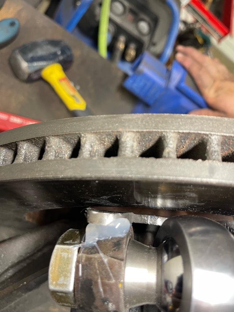

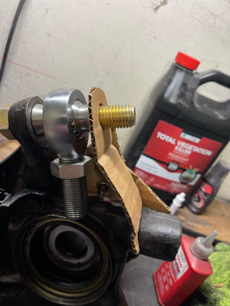

One thing I noticed is that I have full clearance to bottom out the heim upwards (so as if the suspension was fully drooped) but when I try to bottom it out downward (in extreme uptravel scenario) the lock nut on the heim impacts the lower bracket. It gets worse as it turn out.
I was originally going to clearance the bracket for this, but then realized that at ride height, the tie rods sit pointing down quite significantly, which leads me to believe that my up travel will run out of room a lot sooner than my heim will, so I should be in the clear, no pun intended :rofl:

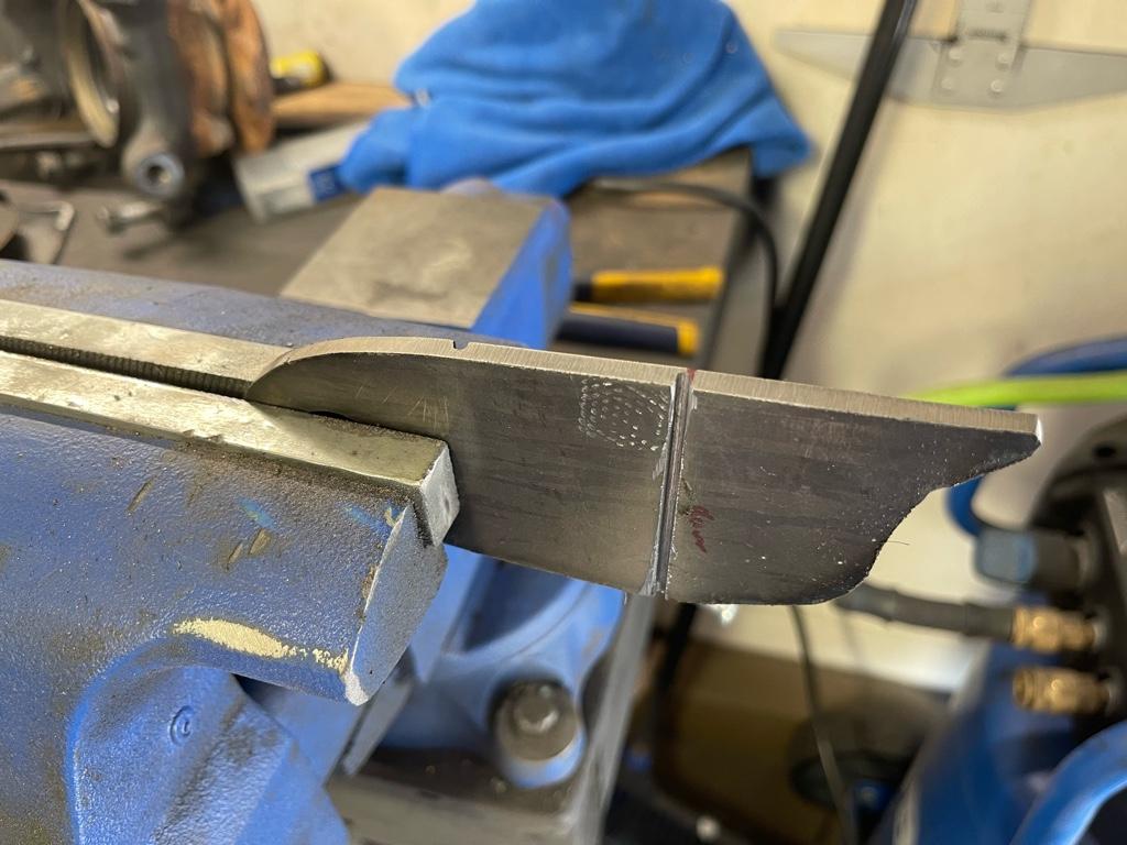

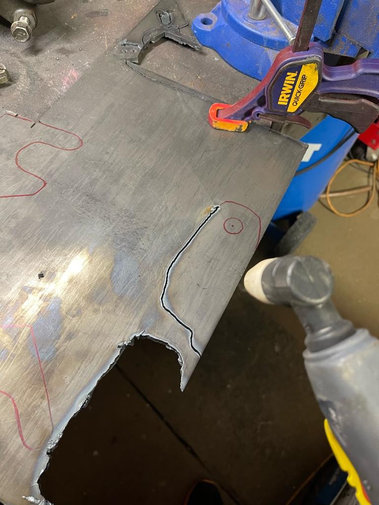

The plasma cutter is really hard to have a steady hand, which I think makes my parts look all wiggly. What I like to do is cut a template it of MDF on a woodworking bandsaw that accounts for the tip to follower distance. Then clamp and trace it with the plasma. Takes extra time, but makes it a tad neater
That is a great idea.. i'll have to keep that in mind. Also a good excuse to acquire a bandsaw... lol.
What I have been doing is cutting my parts slightly larger (following the tip just to the outside of my outline) and then using a 40-60 grit flap disk to do the final metal shaping. This is especially helpful when I want matching parts.. I just clamp them together and grind them both down to the necessary shape. Not perfect by any means.. but at least it results and pretty similar parts at the end.

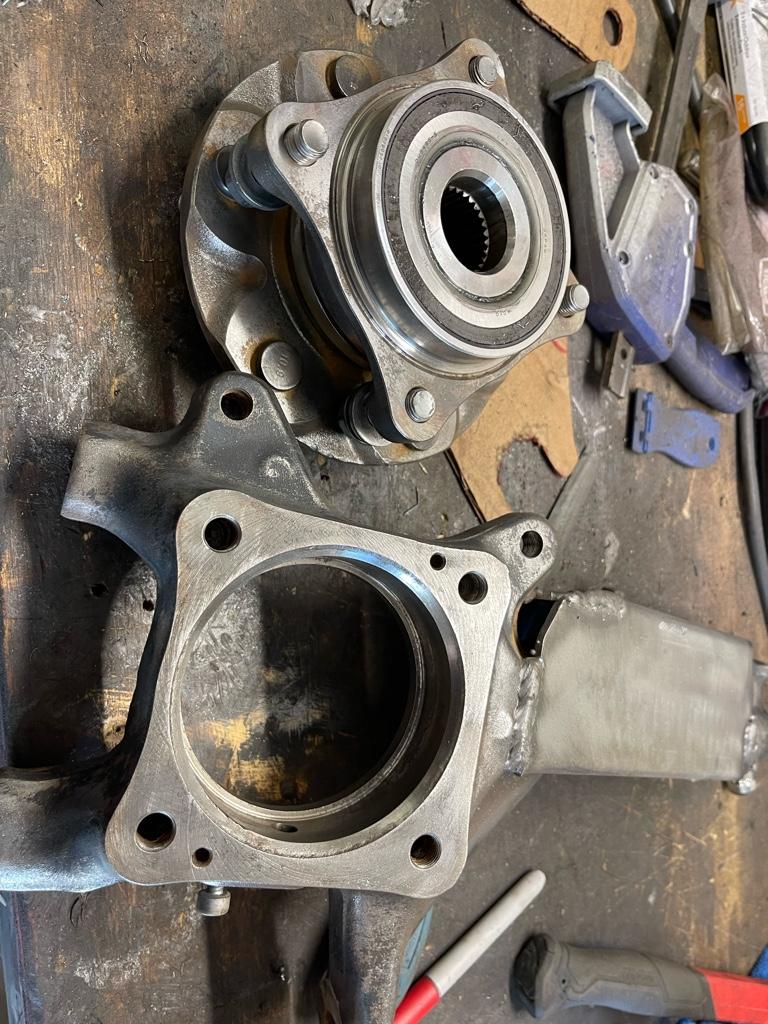

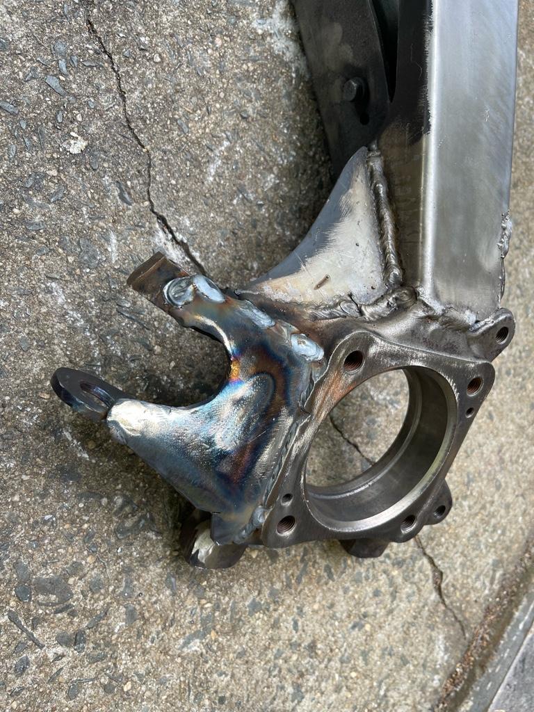

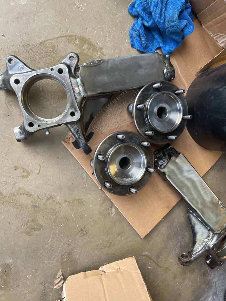

Well.. I think this is as far as I’ll get until I can weld these up tomorrow.. should be close from what I can tell but who knows. I’ll throw some tape on these to pull templates before I weld them up for those interested to DIY these… no promises that it’ll work but should at least be a good starting point.

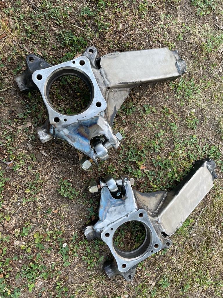

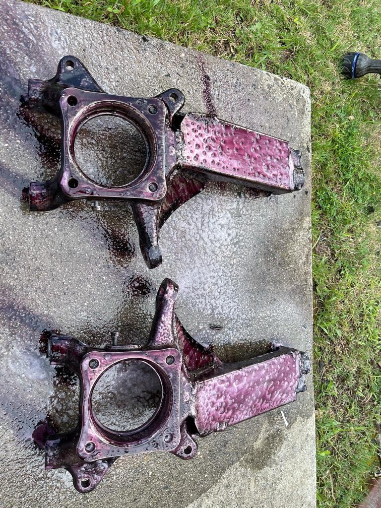

So much surface rust… spent a good hour with a wire wheel.. not perfect but significantly improved. I have some more Steelit coming Friday since I didn’t like how the paint held up with these spindles from last time. What’s a project budget ? If you find out what that means please let me know.. lol.
Getting anxious to get this welded on and test fitted.. last night hurdle should be the steering shaft so we’ll see if my mods will work. Fingers crossed.

You probably know this already, but be careful getting those bad boys too hot.
Yea.. definitely not ideal welding cast but certainly doable, the gussets I welded on last year seem to have held up decently. So we’ll see, fingers crossed haha

A little more progress.. a bit more fab left before I start throwing it al together .. I’ll update some details in a bit
