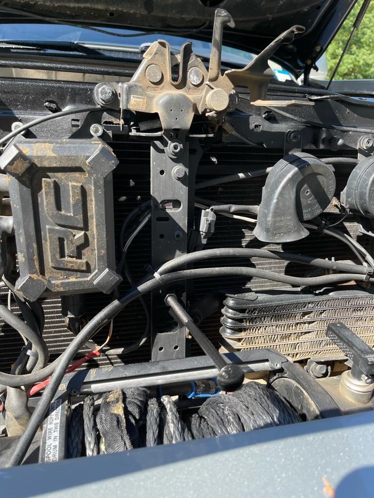

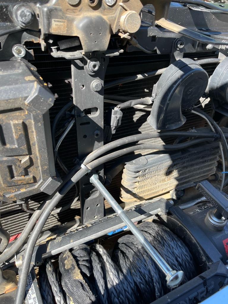

My taco grill has been sagging ever since the swap and I’ve been too lazy to fab up a support rod at the bottom. Fixed this with about 15 minutes of work and an 8” carriage bolt.
McMaster is insane.. order yesterday afternoon, estimated Tuesday, delivered this morning .. lol. Too bad I already planned on not doing the swap this weekend.. but getting exciting.
I don’t have a good before picture. But here is what the after grill looks like with the support bolt. So much better

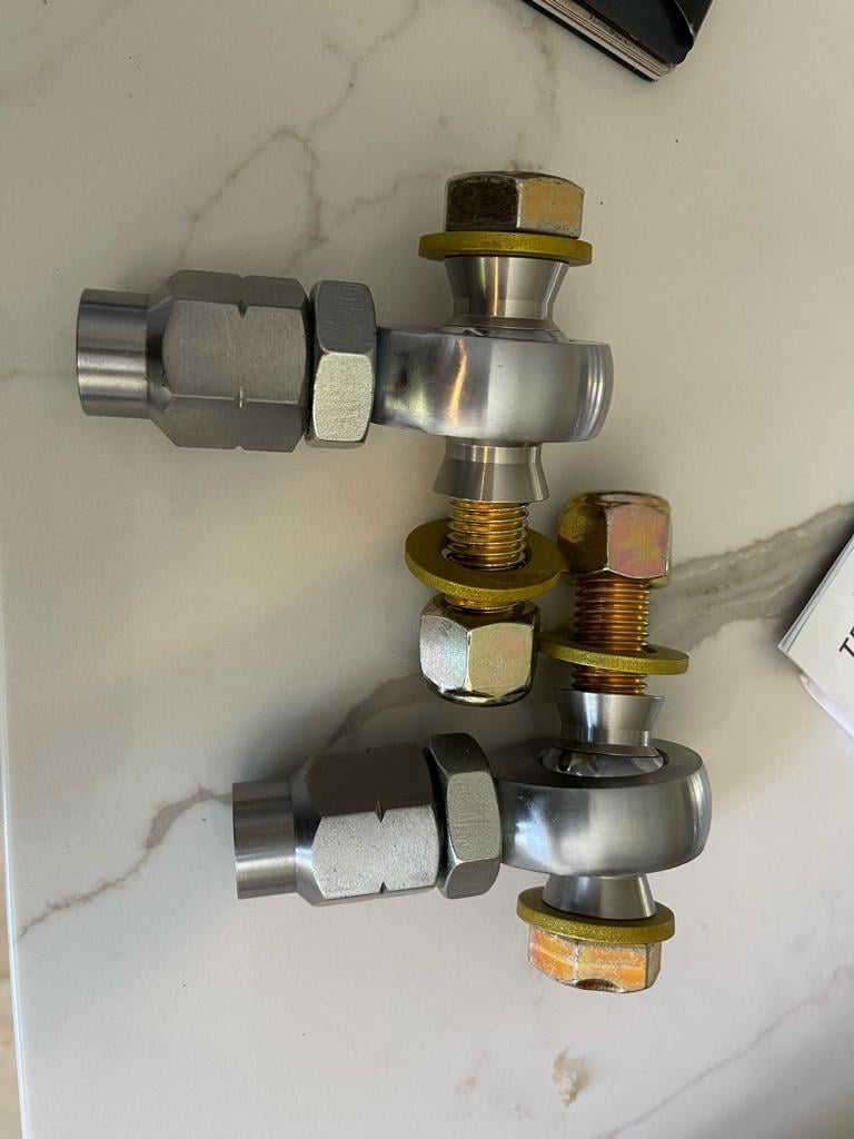

Unfortunately no.. since I’m using a heim joint I’m having use a bolt, the bolt I have is 3/4”.. so I’ll have to drill out the taper to a straight 3/4” hole in the spindle.. so in the future I won’t be going to a tundra outer unless I get new spindles and drill out the taper again. This is all in theory still of course.. so we’ll see how this actually works.

I already made a parts-run to my parents house to drop off all the components, and the remaining hardware arrived from McMaster yesterday. Still not sure exactly how long i'll need the bolts to be so I have 2 different sizes for each side and hoping like hell it works out :)

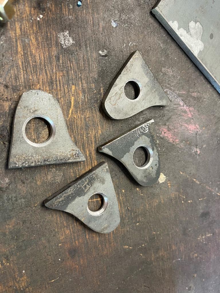

-cut-off old cam tabs
-weld on new tabs

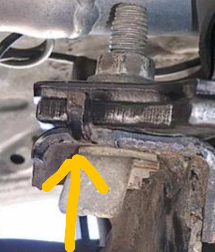

This is probably a silly question.. but which way do the offset bushings position the rack? Is it to allow left to right positioning to center ? Or front to rear ? I imagine it’s left to right.. correct ?
Not at all silly, I studied Devons FJ write up and the Marlin instructions for a couple days.
The nice thing about Devon's design, is you can take some measurements and move it around a little one way or another, before you drill the hole for the passenger side mount. (I used an old rear upper link sleeve to weld into this position for the frame support).
I focused on pushing it forward as much as possible as well as getting it centered side to side, and then squared it up w the core support. It's not perfect, but it's close.
I wanted it pushed forward to make sure the OTE clears the coil over through all the movement and angles it will see. This might bone me on the steering shaft clearance, but the coil over clearance is the most important parameter imo.
So as a reference, if your looking at the front from the bumper, the bolt hole in the bushing is between a 3 and 4 o'clock position on mine.
Also, the biggest mistake I made was cutting too much frame for the pinion clearance and had to weld some metal back in there to try and keep it from being too weak. This hole only needs to be about the size of a 50 cent piece.
