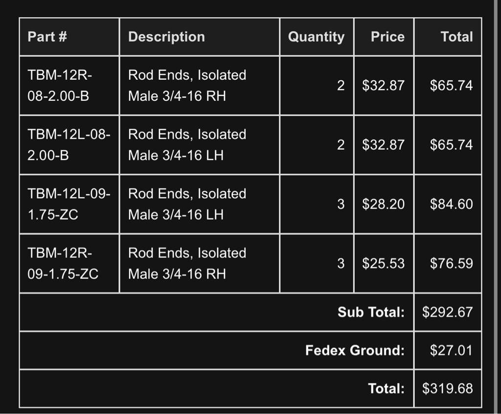

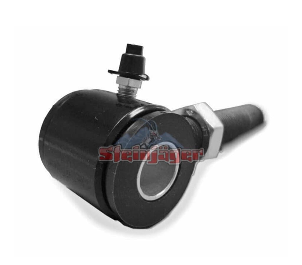

After doing some searching I “think” I found the rod end bushings that will work with my current setup… I think I have the right combination of RH and LH threads with the appropriate 1/2” hardware holes for the upper links and the 14mm(9/16”) hardware for the lowers and panhard bar.
The width of the bushing for the lower links and on a hard bar is not ideal and will be about 3/8” not wide enough, but I’ll just shim them out with the proper amount of large washers on each side to compensate.
These have zerk grease fitting so we’ll see how that works out.. $300 isn’t the cheapest route to go… but my links work well other than having heims in them… I don’t think the heim joints are bad one bit, I feel like metal on metal just translates too much rode noise in an already still and loud , heavy ride… we’ll see hot this goes…. I’m anticipating quite a reduction in down travel but I’m willing to sacrifice.

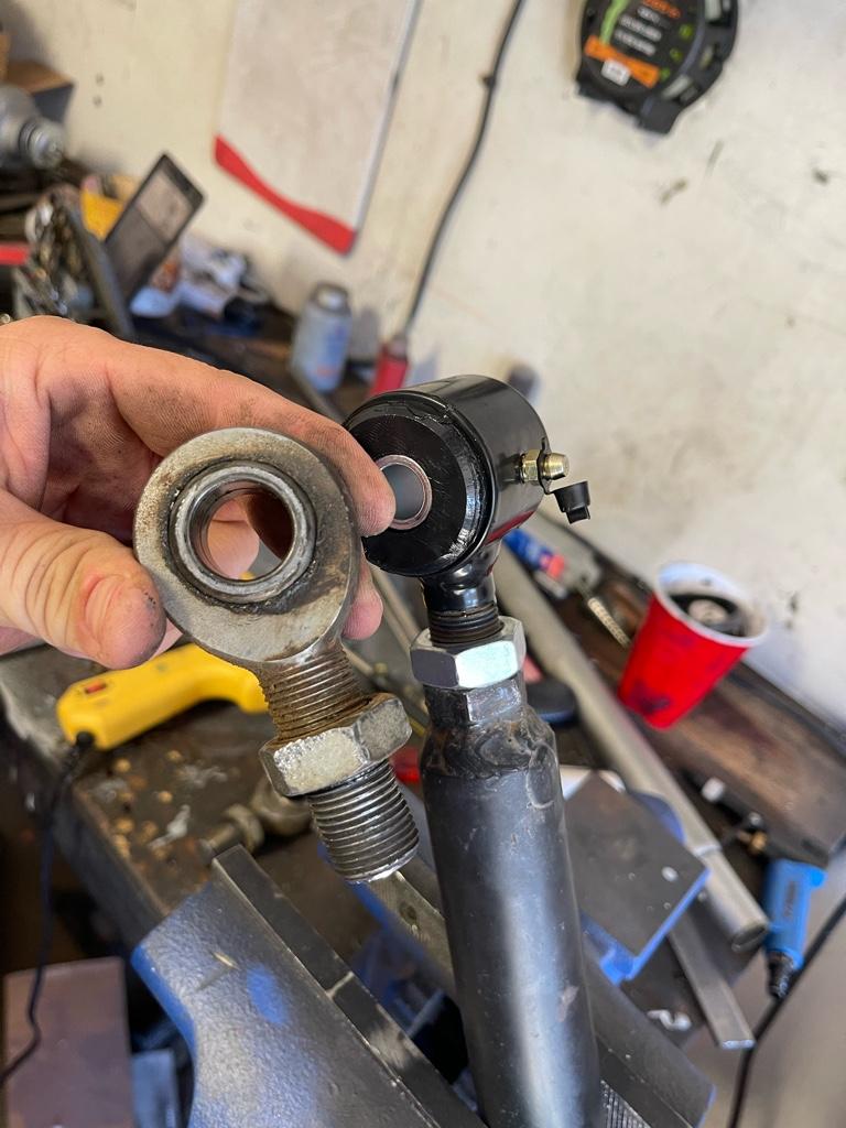

Out with the old in with the new. Less maintenance and better ride comfort is a worthy sacrifice of a little articulation..
The upper link is done and everything fits like a glove.
I also did the panhard bar and found out that the factory bolt is noticeably undersized for the 9/16” insert and could very well be the cause of some added noise I’ve been tracking down .. I should have enough hardware coming to throw in actual 9/16” bolts into the panhard bar tomorrow as well.
spent some time this weekend and got the remainder of the links swapped out along with installing the 9/16" hardware in the panhard bar and lower links in place of the factory 14mm hardware. Definitely noticeable slop between 14mm hardware and 9/16" bushings and heim joints... equivalent size? Yes.. ideal? No.
I must say.. having bushings in place of heims definitely improved the ride, in particular at low speeds over some uneven road surfaces around town.
