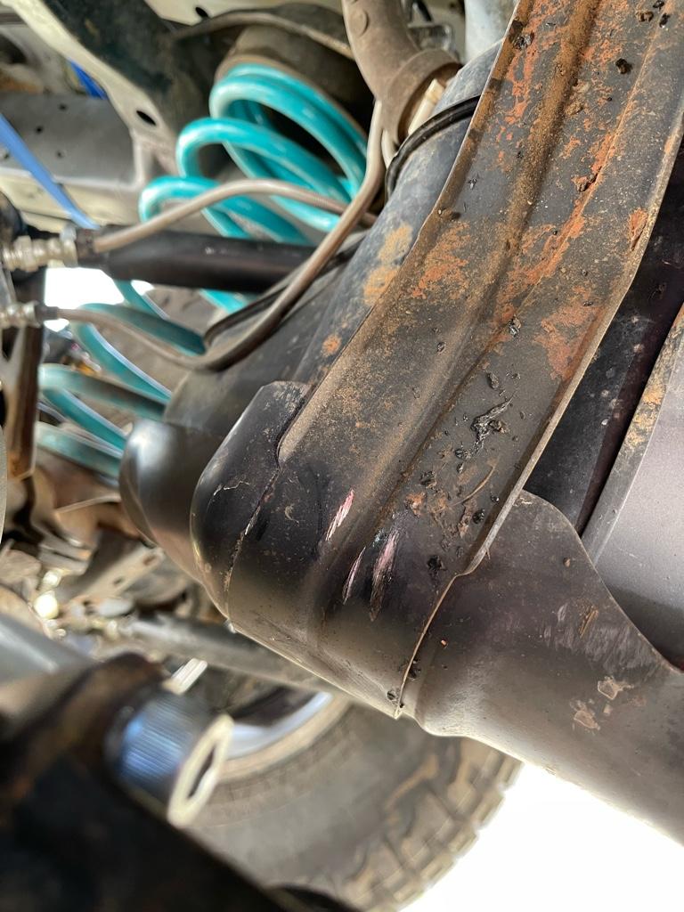

Anyhow, back to the potential noise... I just got done pulling the TK1 Racing links from both sides and strapped the bar to the frame to get it out of the way. I haven't yet tested this out.. but did want to mention somewhat of a promising find... A while ago since I shifted my axle back, i had some contact from the drive shaft to the gas tank skid. After the first time it hit, I bent it back, and heard it hitting hard again. I left it alone for a few circles around the neighborhood and the noise stopped. After inspecting it, it looked like the weights on the driveshaft "self clearanced" the skid by pulling back a few spots. I decided that was the end of it.

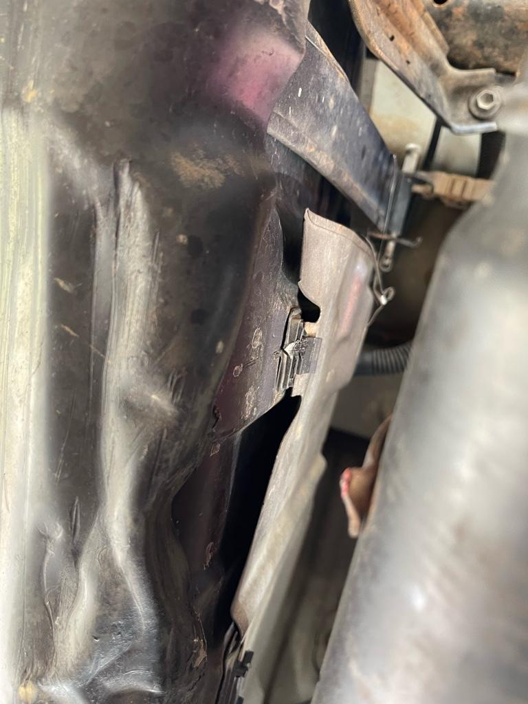

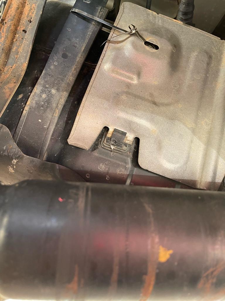

While inspecting the links.. I just happened to look at the skid.. and to my surprise, found what seems to be some-what fresh impact marks, but not only on the skid plate, but also on the rear strap. I'm throwing in a couple of pictures so you can get the idea. It wasn't just a single spot making contact, but rather a few of them near the back of the shaft.
I went at it with a pry bar and really pushed the skid back into place and as far away as possible. I also adjusted my panhard bar to the shortest possible configuration I could get with the passenger side link. This should obviously pull the axle a bit further to the passenger side, and the driveshaft further away from the skid plate....
Thinking back to last night... while making a left-hand U-turn, I hammered the gas to get out of the way quicker, and this resulted in 1-3 solid "thuds" which I originally attributed to the same "clunking" noise I was getting under hard, straight acceleration.. I am now thinking that it is quite possible that what I was hearing was the impact from the driveshaft to the skid.... it makes sense in a hard left-hand turn with the body rolling over right and rearward really hard.. this would have put the driveshaft to the closest position to the skidplate... or am I crazy here?
Anyhow... I'm waiting for my gopro to finish charging so I can strap it under the rig and go do some test runs really quick with hopes that between moving the axle over and disconnecting the sway bar I won't be hearing any of the noises coming from the rear end.. If I do hear the noise.... maybe I can at least have some video assistance to help track it down from this point... if that doesn't work keep you eyes peeled in the For Sale section :banana:
well.. spoke too soon lol. The issue isn't gone, and I can clearly tell the noise I'm hearing isn't the gas tank skid.. So I guess I can conclusively say that the TK1 bar is not slipping the splines, which I guess is good, and that there isn't any additional clearancing needing on the driveshaft to the skid.

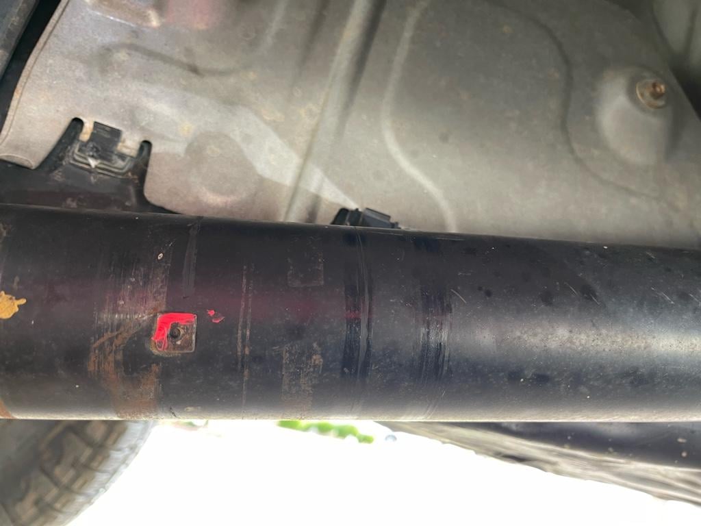

Edit* just went back through my thread.... and I am just about certain that I only changed out he u-joints on the front driveshaft because that was the one that was a bit tight when I was working on getting the FJ t-case into the rig.... could it be as stupid as the driveshaft failing? Maybe some of the vibration I am feeling out of the rear end that I have been attributing to tire balancing is also caused by it? can't imagine be being that lucky... I guess it's time to pull the rear shaft out and see what the u-joints feel like...
Wireless driveshaft for the win... Made quick work of pulling the rear driveshaft out , and guess what??? Absolutely 0 binding/locking up/noise, etc. :nod:

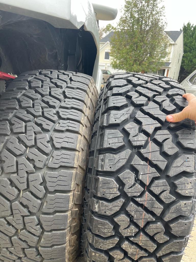

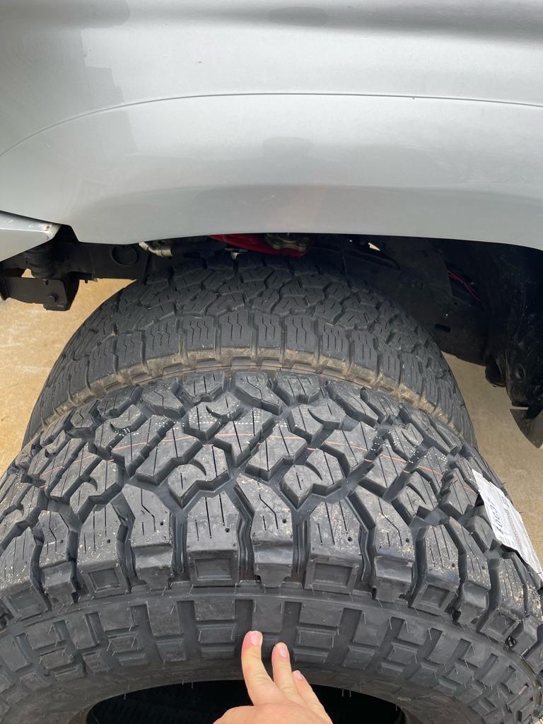

BTW, those 35s look small, I would have gone 37s :jk:
I no joke almost just say screw it and ordered 37's since I was upgrading anyway lol. But I decided to stay logical for the time being and get 35's..
They are meatier than I anticipated.. can't wait to get these on and hope like hell they can balance them out perfect.

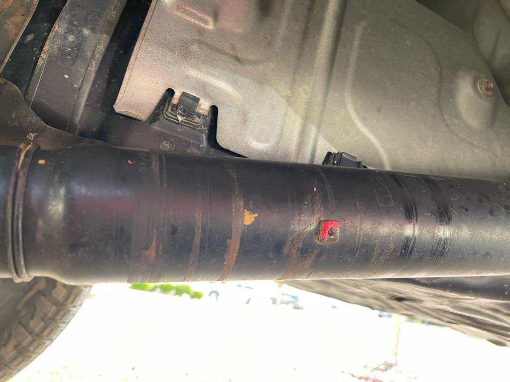

-greased the drive shaft u joints and yoke
-adjusted rear links to zero in the pinion angle to match as close to the transfer out as I could

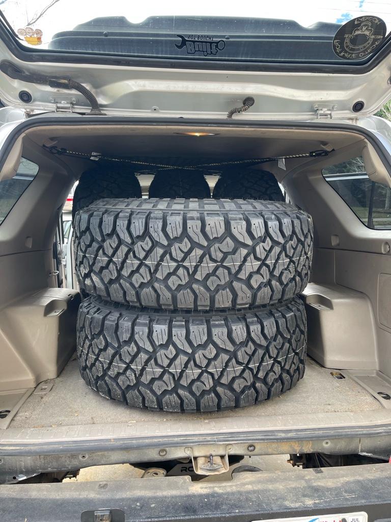

Decided to pull my drawer out to fit the tires for my Wednesday appointment… now I’m not sure I’m going to put them back in.. going to see if I can sell the set locally in favor of just using some heavy duty totes to pack out my camping stuff when I got the 3 times a year i make it .. I have a tire table that could work perfect for a gas grill.. not as handy as the pull out drawer with it already there.. but I feel like it takes up way too much room for daily activities..
Spent a couple of hours and $200 at Discount tire last night after work. The Kenda's are on and fingers crossed so far so good.. The guy said they balanced out perfect, though after looking at one wheel it definitely required quite a bit of weights. We'll see how these do throughout the week, but so far it seemed to be smooth cruising on the way to work.

Mine clunks every time when I come to a stop and its 100% the rear driveline slip joint. I keep meaning to get a high moly content grease to fill it with because normal grease breaks down pretty quickly. And the problem is harder to fix with grease the longer you go without greasing it since the splines wear down and the tolerances loosen up.
The design doesn't really lend itself well to getting grease completely pumped into the splines either. The fitting is at the top and there is a big void that needs to be filled first, then you see the driveline extend and stop then think the splines got grease but they don't. I pulled my slip yoke apart, shoved grease in both sides of the splines and put it back together. Worked for a little while and the clunk is back :pout: If you want it gone for good, buy a completely new driveline with a new slip yoke and keep it greased regularly. But the high moly content grease in the splines may work good, the slip yoke definitely needs different grease than u joints!
So a quick update on my clunk.. got my Dana spicer u joints and swapped them out. As I had feared.. the clunk was still there.. but.. something about it changed.
It doesn’t seem as consistent now and doesn’t last as long when I hammer down in 2wd. Still gone in 4wd.
So the joints seemed to be ok.. since the old ones seemed to be smooth when I pulled them out.
The only thing that I can think of is possibly the slip yoke splines….? Could it be that they are a little worn and rough and under heavy torque as the squats and wants to compress the splines it binds a little ? Aside from the u joints the only thing I took apart was the actual slip yoke… maybe something about taking this apart is what contributed to the sound difference I’m seeing ?
One positive thing I guess is that I can just about confidentially say that it’s driveshaft related.. I mean it has to be since the characteristics of the clunk changed and it was the only thing I messed with ..
