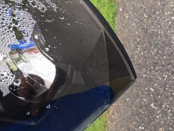

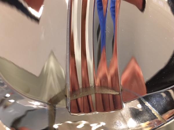

Today I pulled the headlight back out and poured the water out of it. It’s been raining a good bit here in Maryland. The water seems to have stripped the chrome off part of the reflector.

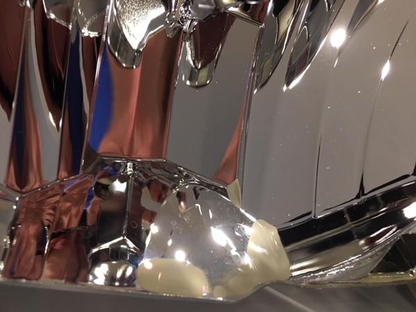

Anyway, I decided to bake it and pull the lens. Into the oven at 150° for 25 mins or so. While the oven was on I decided to pull apart a spare factory passenger headlight I had. Some slight modifications to the black plastic shroud inside the DT Moto headlight and the lens fit onto the factory housing and reflector no problem. The only difference I can tell is the DT Moto lens only has 2 screws along the side of the lens where the factory has 3. Sealed it up with clear silicone and it’s curing on the bench. I’ll post pictures when it’s done.
Update: DT Moto is sending me a new passenger side light. They specifically said to seal the new one before I install it. Sounds like they know their lights have crappy seals. I guess I’ll see how my factory hybrid holds up and then replace it if needed.

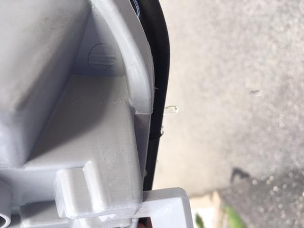

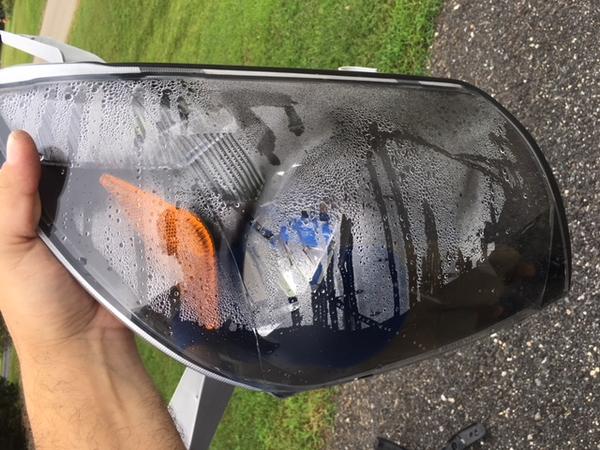

Does anyone make a set of the 2006 sport headlights (black inside/clear lens) that doesn’t leak? I’m going crazy with the ones I bought from Amazon. Spent all last weekend drying out my driver’s side one. I “thought” I found the issue when I pulled the bulb sockets out. The turn signal socket had a broken tab and a torn gasket, so I replaced the socket as it looked a bit burned too. I lubed all the o-rings/bulb gaskets with o-ring lubricant that has Teflon sealer in it, and then as extra insurance put a bead of clear silicone around the seal channel. Seemed fine until yesterday when it was pouring rain, and the lens was full of condensation again!:smash: WTF!

As an update to my previous post in September, I did resolve the leak by putting a bead of clear silicone around the interface of the lens and housing. At first I thought it didn’t work because it fogged up again the next time it rained, but I think it was residual moisture that was trapped after I thought I dried them out. After running them for a coup,e of days it cleared up and has been perfect ever since even going through car washes, torrential rain, etc. Very happy to have that resolved.
