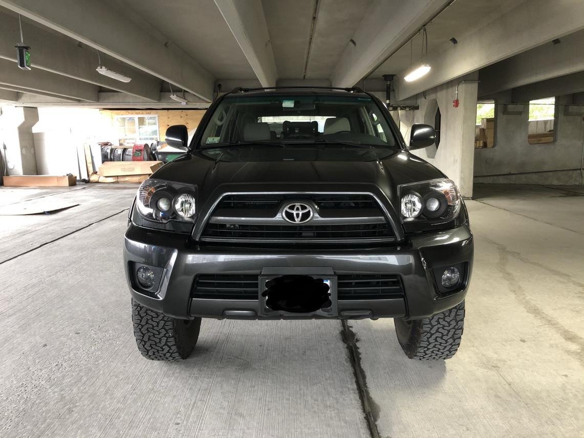

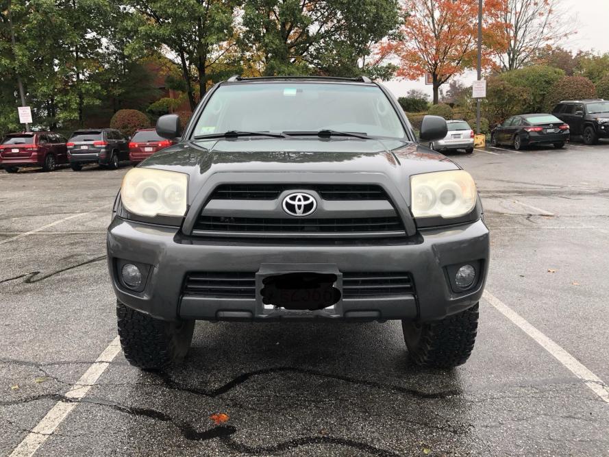

A little over a month, 2 trips through the car wash and 2 rain storms. So far so good. Love the way these lights changed the front end of the truck. Now I just wish the paint would stop oxidizing. :(

I finally installed my KHC replacement assemblies. All-in it was easier than I’d thought, though the bottom bolt it absurdly difficult to remove, and for me impossible to reattach at completion. 3 out of 4 will have to do. Best thing I can say for that is to remove your plastic wheel wells to get at it. I’d read some of the threads that said you need to modify one of the projector holes for the standard bulb to fit, though this was not my experience.
Installed, they look awesome. I added a bead of sealant, we’ll see if that keeps out moisture. I’m not optimistic, but that’s only due to what I’ve read here; in-hand these seem equal to OEM. Like, exact.
With the satin black housing you’ll notice the amount of light you project at night will diminish.
I’m trying to upload before and after pics, hope it works.
Since you have projector lenses, the black housing has nothing to do with the diminished light output....
