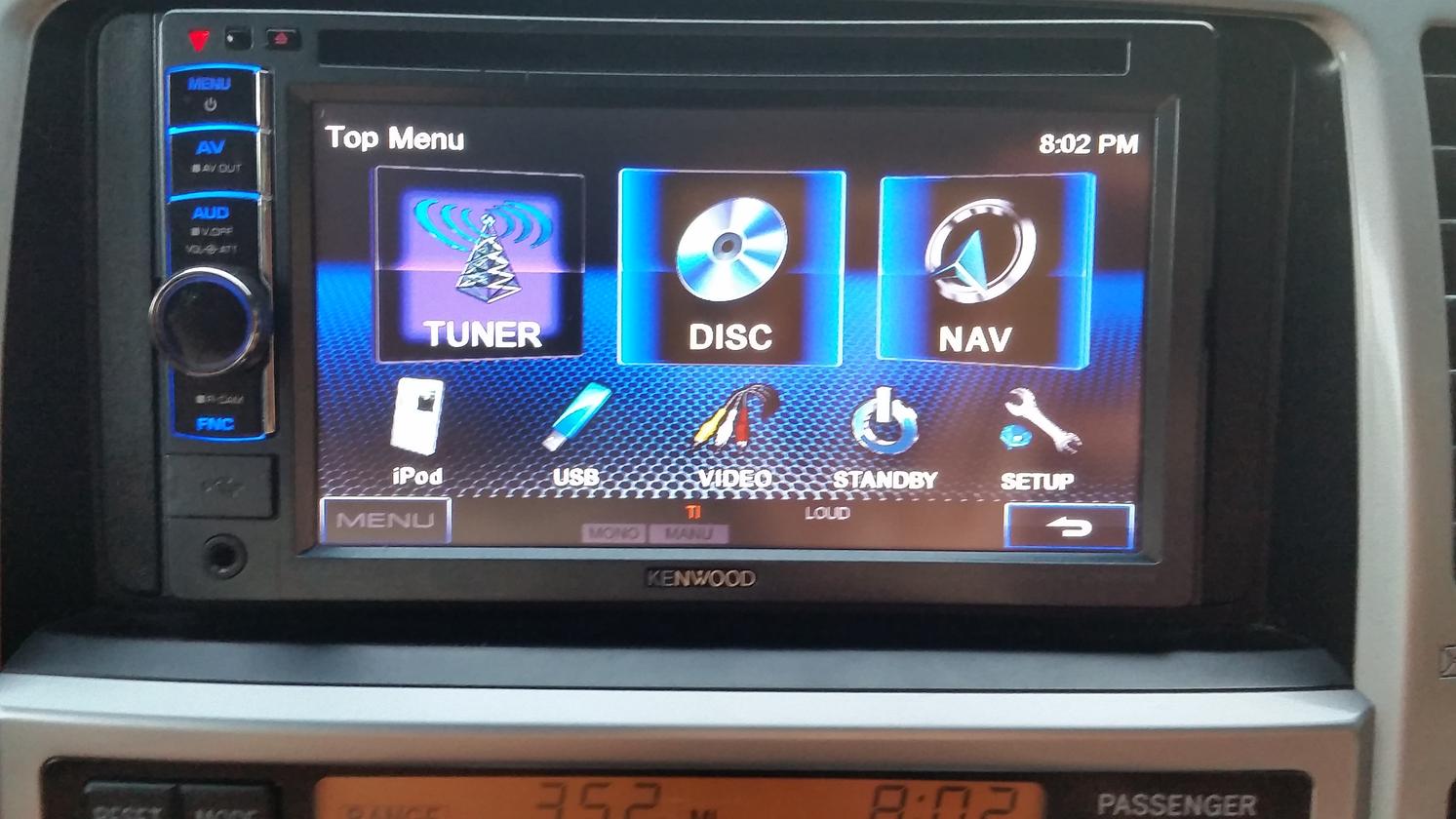

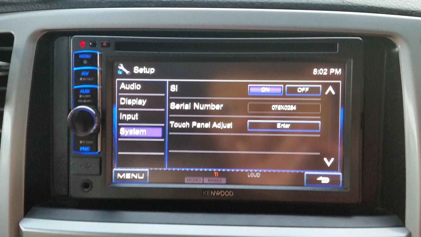

This afternoon I just bought a 2004 4runner with JBL acoustics and aftermarket kenwood stereo. The steering wheel controls don't work, which isn't a big deal since they are only inches away. Second, there is a icon on the screen for navigation but navigation does not work. The dealership said I just need to download the software and install it through a usb? Lastly, the car stereo sounds really good but, the back to speakers in the trunk don't work when you move the balance/fade around the car.
My only issue is I don't know what model my stereo is to begin looking up these issues. I know it's kenwood and a serial number of 076X0284. I tried to search for that but couldn't find much.
Here are pictures of the kenwood head unit
