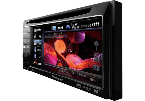

pioneer
I have the PIONEER AVH-P3200DVD 2-DIN AUDIO/VIDEO RECEIVER on the way, $298.00 with free shipping. Not sure this unit will fit your 4runner. I chose this one because of the positive feedback I have read, as well as the price. I wanted to put in a double DIN. A single DIN upgrade has a tendency to look like an "install."
Will post picks when installed.
