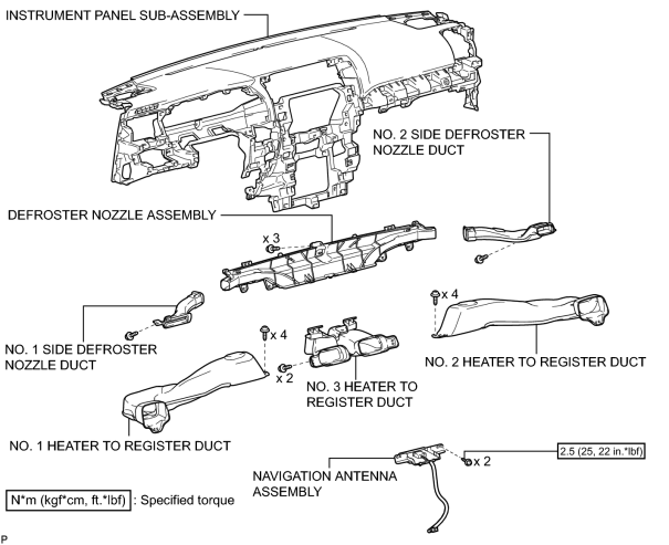

Not sure what your stock stereo or if it has a GPS antenna now, but for my oem JBL Nav, the GPS antenna was straight up and forward of the stereo,under the dash of course.
There is like a little shelf there that it slides into or is stuck in,been awhile but you should see it as the cable is going up to it. It's about 2" x 2" and flat and I took the oem GPS antenna out and put my Pioneer GPS antenna as the leads were different.

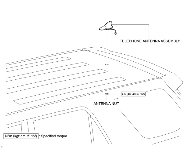

I guess you could put the gps antenna up there but alot of extra work and not sure it would work well thru the metal roof. The shark fin on top is a cellular antenna. Not sure which one the XM radio uses .
The factory nav(gps)antenna sits right in the center of the dash above and forward of the 2 center vents .It looks like the tray comes with the gps antenna as it has 2 bolts holding it on. It was stuck on that tray and I just pulled it off and put mine on and didn't even unbolt it. Grant,you probably won't have it but the square space should be there to improvise with double stick tape,double stick foam pads or similar .
